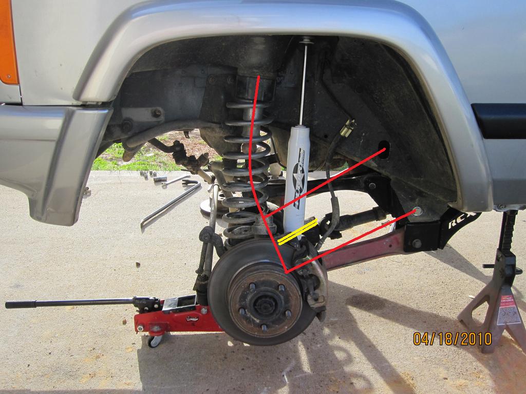

your control arms appear to be way too short, which explains the death wobble. looks like you need longer arms or at a minimum drop brackets.
LJ 4inch coils (which I've read give an inch under on XJs) and a 1 inch poly spacer. The fronts control arms are for XJ/TJ. Just curious, what makes them appear too short out of the photos I posted?
They appear to be short because the front axle is tucked close to the rear of the fender wheel arch, as you lift without changing the control arms, the front axle will move as a whole towards the rear of the vehicle, shortening your wheelbase and causing the pinion angle to strain, pointing higher into the body therefore causing death wobble. Installing longer control arms or drop brackets pushes the entire front axle to where it was at factory specs restoring ride control and quality.
heres a pic of the drop brackets installed with 3.5" springs. Ive marked in red the location of the original control arms and in yellow the original pinion angle, the axle is at full drop in this pic:
I think it has more to do with my tie rod ends/ball joints. They both look terrible, and the control arms I have are 16 inches or so center to center. From what I've read that should be fine for my lift. I think the cutting for the flares is what makes the axle look misaligned. You take a lot more out of the front of the fender than the rear, but we will see. I guess I'm going to go ahead and do a heavy duty steering upgrade/ball joints/steering stabilizer first off.
