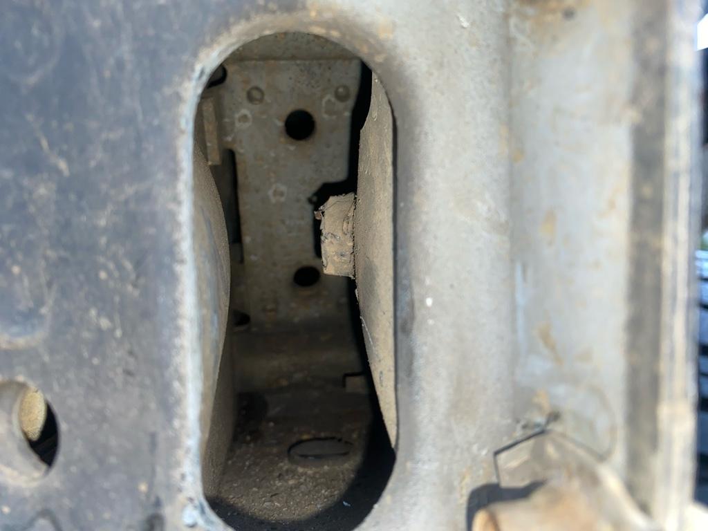

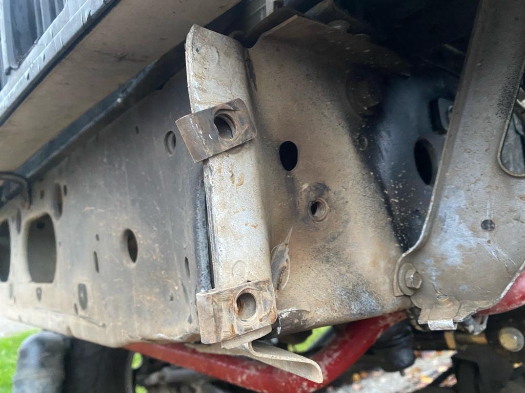

I don’t know if this is the right place to be posting this but I need some ideas on how to pull out this part in my frame! It’s punched in pretty good from hitting a tree on the drivers side any ideas would help thanks guys!

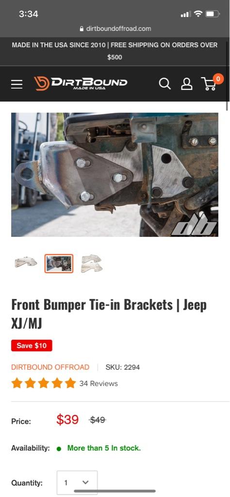

Regardless of the fix you better get a good bumper on it after that
So I need these to strengthen the bumper? Haha sorry I should have been more clear on what I was going to do haha not just throw a winch bumper at it haha I do plan to do tie ins haha
Looks like a perfect setup for a slide hammer, but I wouldn't want to use the factory threads for pulling.
If you could insert a bolt from the inside of the frame and pull on that, I think that would be best. Put a grade 8 washer under the head to distribute the force over more area.
If you can't insert a bolt from the inside, then try using a hardened bolt of the same thread as the factory threaded insert, but add a hardened nut on the inside so that you aren't using the factory threads to pull against.

RCP Phx, can I get away with welding my mount that’s on my bumper now to the tie in and also weld the tie in to the unibody?
I don't care for welding to the uni-body but for all the rest yes!

The trick would be to get it to make the difference you want where you want it, and not on all sides of the football. Judicious placement of a few thick plates of steel would probably help.
Plates, nut, bolt...
This could be done from inside the frame.
A couple of thick plates, a hole drilled in one, a grade 8 bolt and nut (small enough to clear the threads on the existing internal nut) and you could push this out from the inside.
