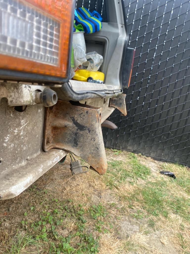

Has anyone made there own rear bumper brackets for an aftermarket bumper? Not unibody tie in brackets but actual rear bumper brackets? I bought an EAG swing gate bumper off someone but they kept the bracket for mounting it for another bumper they had. I cannot find a re make of that bracket anywhere online! I need some help I’m about to use the original bumper brackets and just cut it and add a plate to bolt the bumper to. Does anyone have any better ideas?

These are the original brackets I was going to cut the bracket flush and add a steel plate at the end to bolt up the bumper
The idea is that if you don't cut into the "frame" rail and run bolts from the bottom, you are just bolting a bumper to a single plane of 16ish gauge steel. The linked above ebay mounts seem like a great value compared to making your own, which is what I had to do 10 years about ago.
Otherwise you can just get some rectangles of sheet steel or flat stock and drill your own holes. Or you could cut the factory mount to fit your needs. It won't be very strong though.

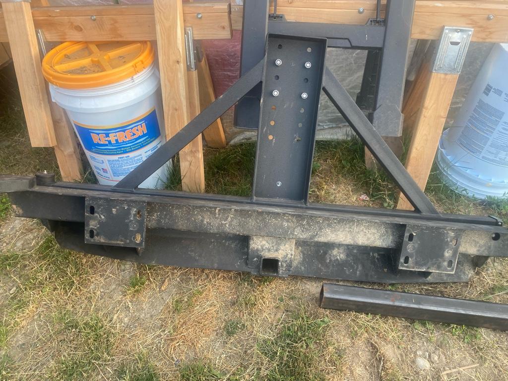

Take a pic of the back side of the bumper!

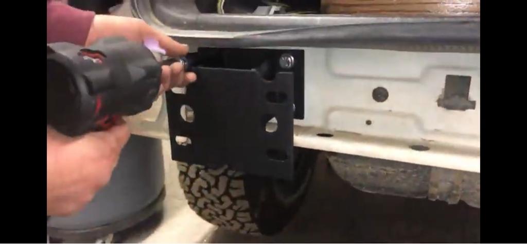

The bracket needs to be Similar to this bracket
Again that's not enough, the brackets Evan linked would be a good start.
That looks like it should directly bolt up, but you definitely need the tie-ins.
He basically needs a spacer to extend the Jeep 4 hole bolt pattern back about 3 inches so the bumper is in the correct position.
I don't recall ever seeing what your needing. That's a strange bumper mount. Almost as though that bumper fits other things as well as the xj...
