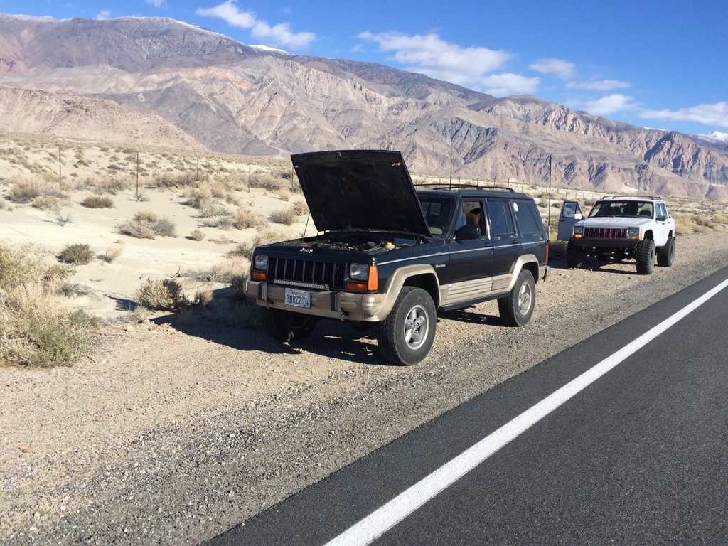

As many of you know I took my trusty old '96 to Panamint Springs Resort/Death Valley of Thanksgiving and it ended up being a bit less trusty than usual.
I done blowed it up. The backstory was I had what sounded like a lifter tick, did a lifter job and still had the noise. With an approaching deadline and no change to the sound over a few thousand miles I decided to roll the dice and run it. When I got to PSR the noise was louder so I decided to stay close to pavement and put my faith in AAA.
On the way out to Reward Mine on a cold Saturday morning I noticed an unexpected temperature spike from 180º. I immediately dropped power and started to pull over as the gauge climbed up to about 220º before I powered it off, as I rolled to a stop I released a great big cloud of steam and noticed a miss.
I popped the hood, jumped out, and found a mess of oily coolant that had blown out of the overflow bottle and wonderful chocolate milk in my crankcase. I called AAA and had them drag me back to Panamint Springs Resort, the driver said he'd been at that job for six years and this marked the first time he had ever towed a car into Panamint Valley.
After some hemming and hawing I decided to leave the vehicle there and drive David Bricker's Jeep back to L.A. since he wanted Avery to do some work to it anyway. I packed my stuff up and headed home, ruining one brand new tent and losing my wedding ring, that trip had it's problems.

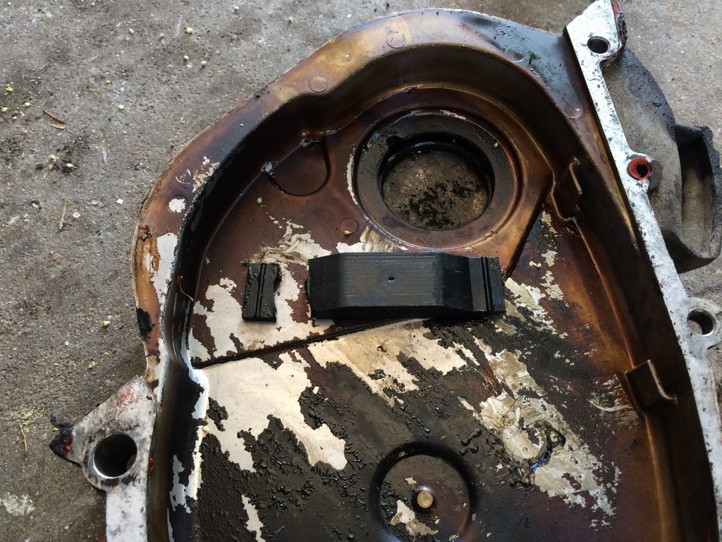

The timing set itself looked good but I did find that my bumper was broken.
So I found that I had no hole in there causing the oil and coolant mixture. I still don't know exactly where that came from.

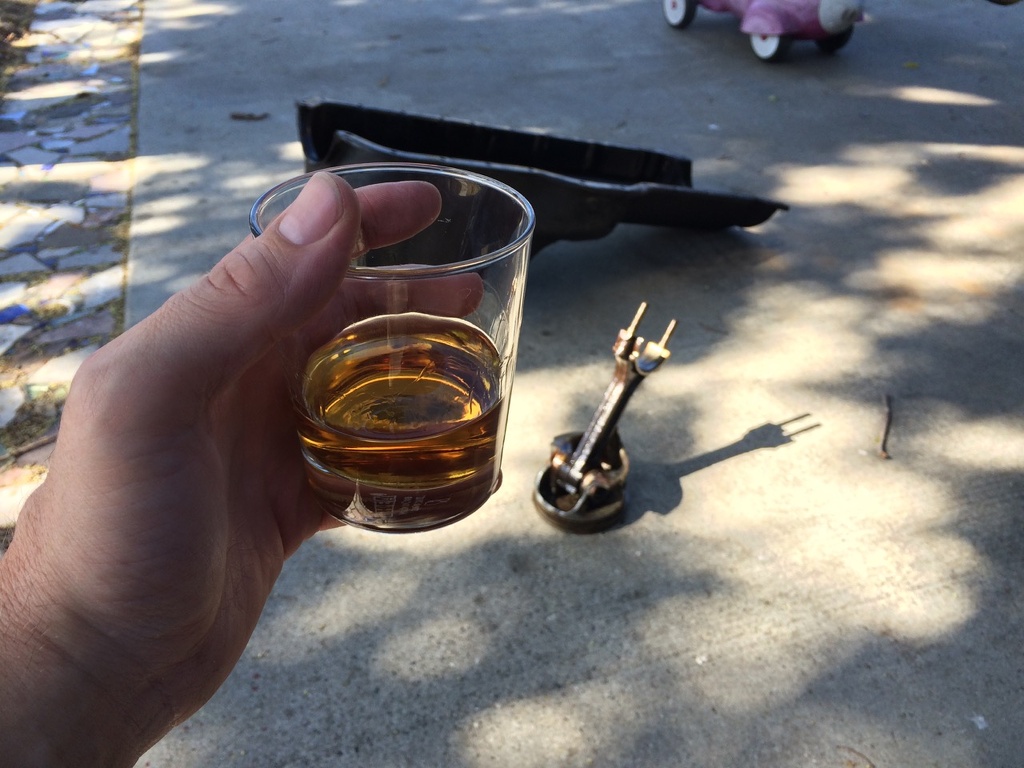

Next up came removing the oil pan. What I found in there was no surprise.
#3 piston
What do you do when you're sending an old friend off to the great beyond? Toast with whiskey, of course.

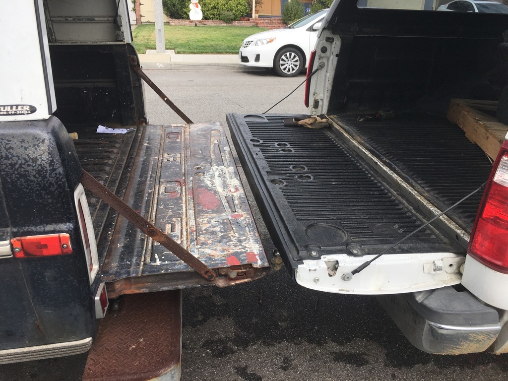

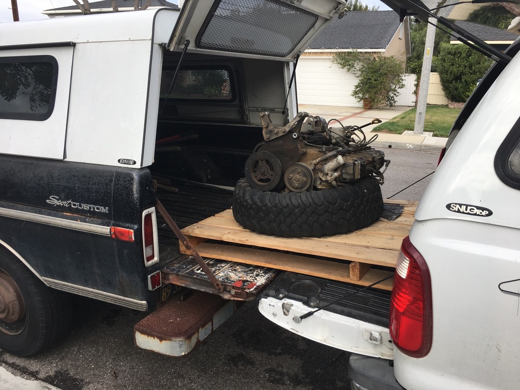

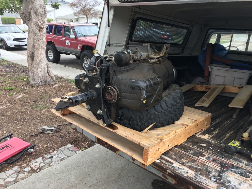

I got a call form my dad that he had to move. He has a few dead vehicles I had to move so I borrowed Mark Nelson's Superduty and rented a U-Haul tow dolly locally to get it done. As long as I was in the neighborhood I swing by Asa's to pick up a complete engine from a '97 to base my new powerplant on.
When i got home I had to unload. Being in a hurry and by myself I had to be a little creative in the process. I started by backing his truck up to mine. I was pretty surprised how close the tailgate height was between a 2003 4x4 Superduty and a 1971 2WD F250. The Superduty feels so much taller I was expecting a larger gap.

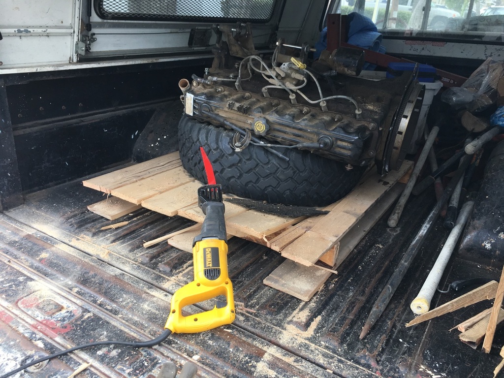

I had loaded the engine onto an old 31" tire for damping that sat on a long pallet that Mark graciously donated so it was as simple as getting into the bed and sliding it out of his truck and into mine.
Since I had some stuff in the truck (AAT tools and my hoist) I had to get the trusty Sawzall out to shorten the pallet, yay free firewood!
(on a side note I looked all over for my cordless sawzall and ended up taking the corded one out. Of course as I put it away I found the cordless one right next to where I had picked the corded one up from!).
I figured I could keep it stashed in my truck for a couple weeks until I had time to deal with it. Then I remembered I had two 65" televisions in storage that had to go to work the first week of January. Damnit. Had to move on it now.

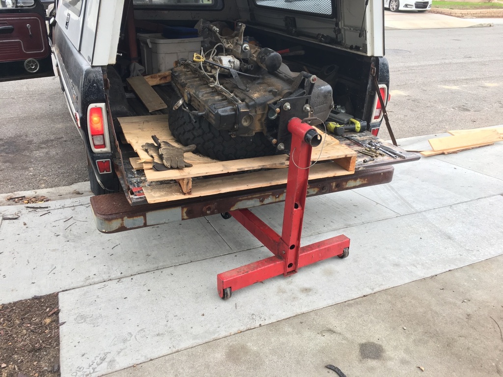

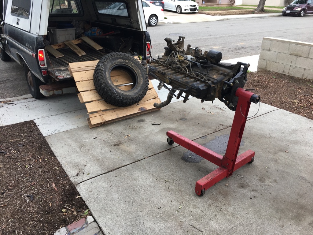

Out comes another old trick. How to unload a Jeep 4.0 by yourself. Start by pushing the engine out to the tip of the tailgate (luckily '71 F250 tailgates have a 2000 pound rating!). Then put the engine stand bracket on.
Next put the engine stand onto the bracket then pull the truck forward down the driveway such that the wheels just touch down.
Last - Pull!
