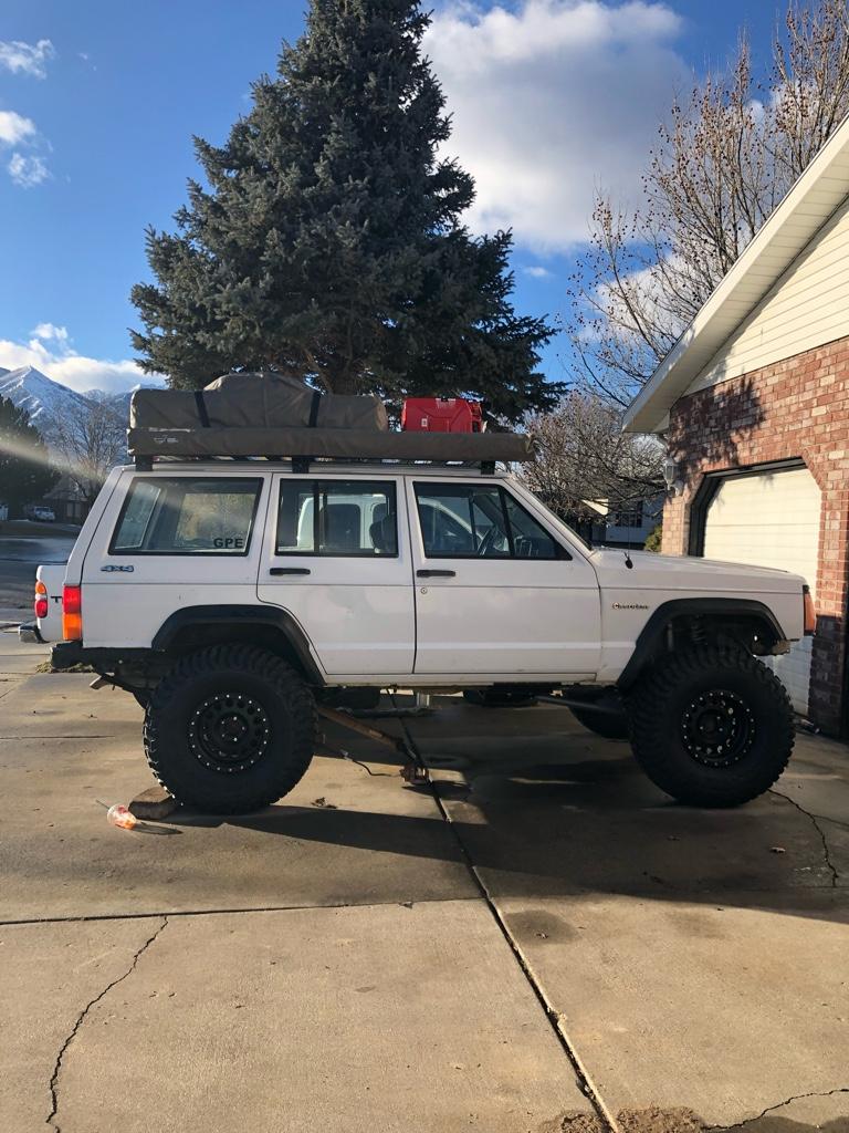

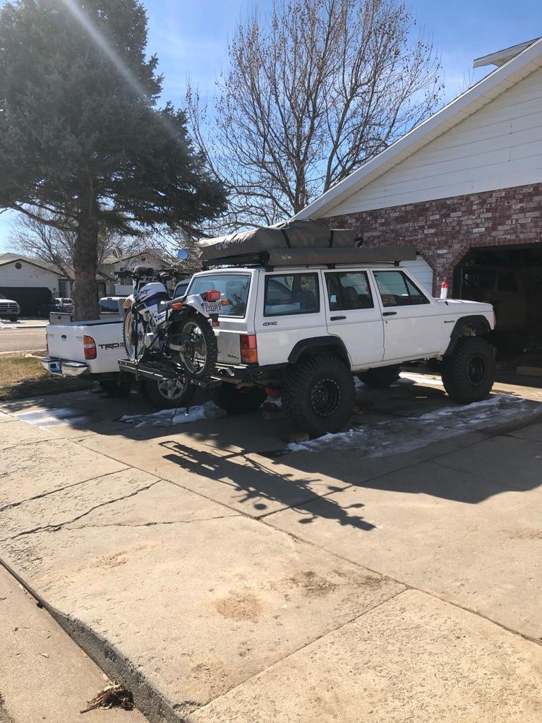

I bought a 1989 Jeep XJ from my brother in 2018. I wanted a mild build that I could just cruise around the mountains and have the same fun that I did in highschool with my first Jeep. I immediately purchased an RE 5.5 long arm kit, SYE, method “hole” wheels, 35” BFGs, rooftop tent, and a dometic fridge. The parts showed up, and they sat around waiting to be put on for almost three years…

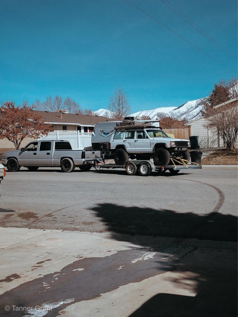

Three years later I decided I wanted to finish this thing. I had moved back to California and didn’t have the time to work on it. But I did have a younger brother who was working as a fabricator at a shop that built custom rock buggies in Southern Utah. I made some calls and had the Jeep (with parts) shipped down to him.

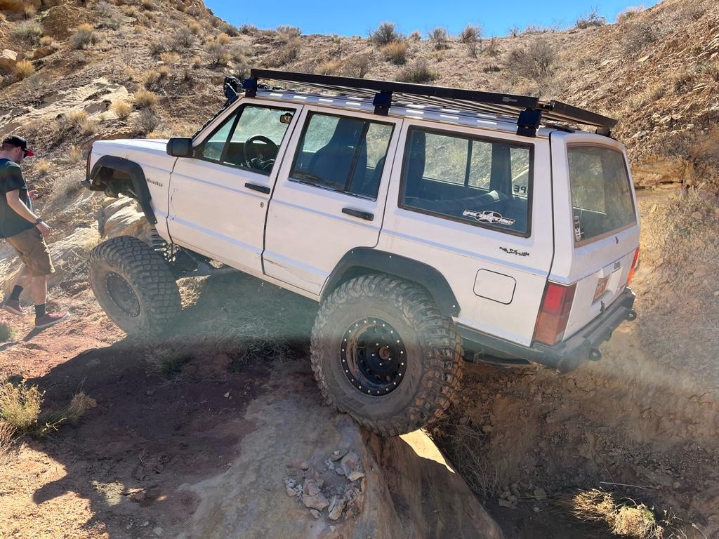

I really just wanted a simple camping rig that would go into some semi-remote places. Back in 2018 “overlanding” was nowhere near what it is today.

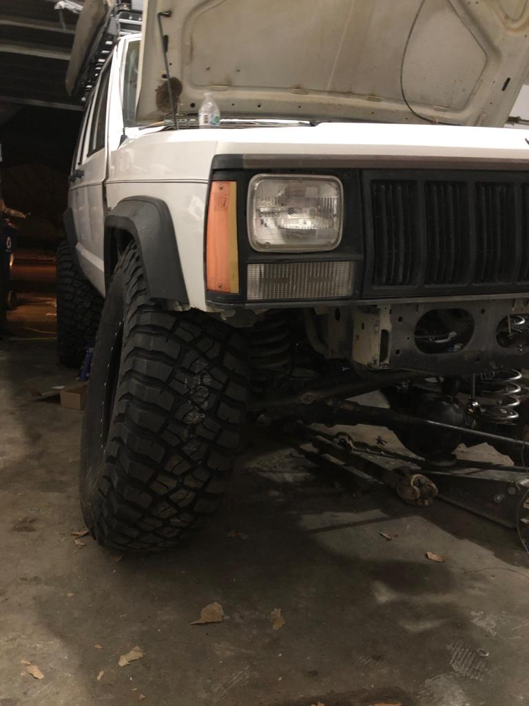

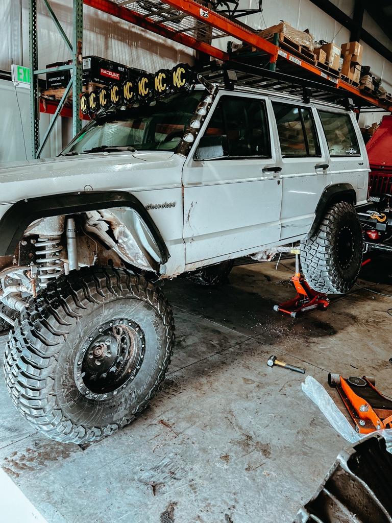

After putting the lift, rack, and wheels and tires on I sent it out to a shop to do the SYE. Didn’t really trust myself to do it
During this time I moved about 250 miles away for work. The Jeep came back from the 4x4 shop, but unbelievably the 4x4 shop had installed the SYE improperly, causing the transfer case to be stuck in 4-lo. The Jeep would sit in this state for almost two years. I would move to California for work, which gave me even less time to work on it.
2021. I am working full time and live 700 miles away from my Jeep. The amazing realization of actually having money to build my Jeep, yet having no time to do it, is something I imagine every adult has.
My younger brother however has become a lead fabricator at a competition Rock Crawler shop in Southern Utah.

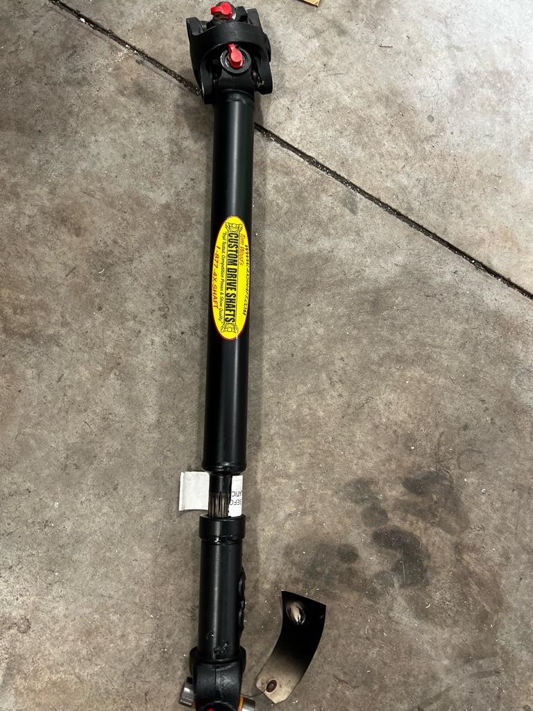

We make a plan to send the XJ down to him to have the SYE fixed, button up the lift kit, and install some 4:88 gears. Get it in and out in a few months….that was almost 1.5 years ago…

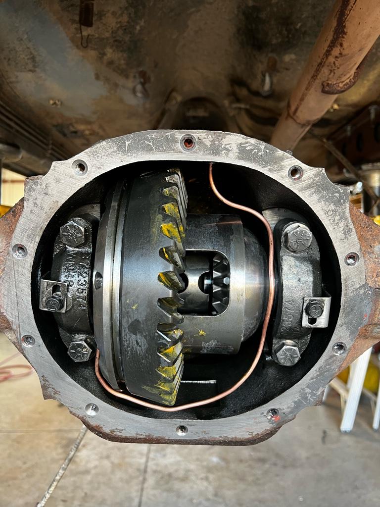

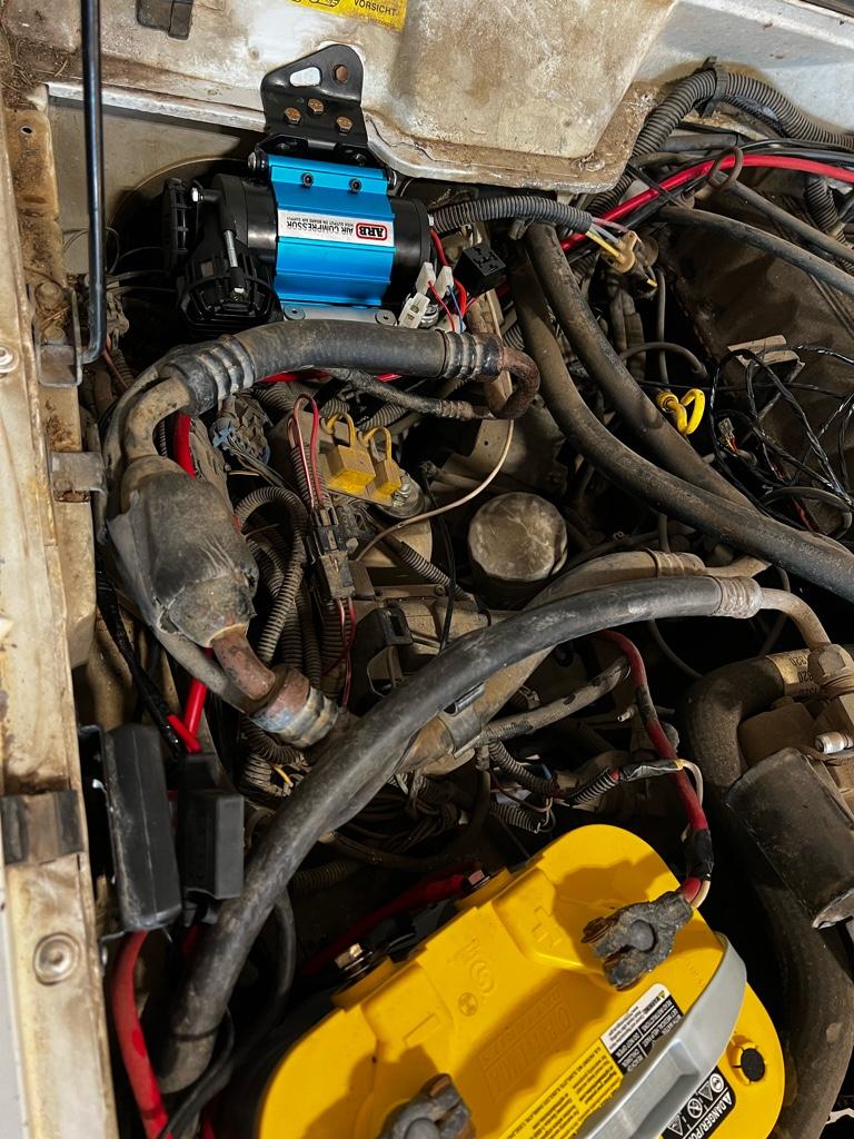

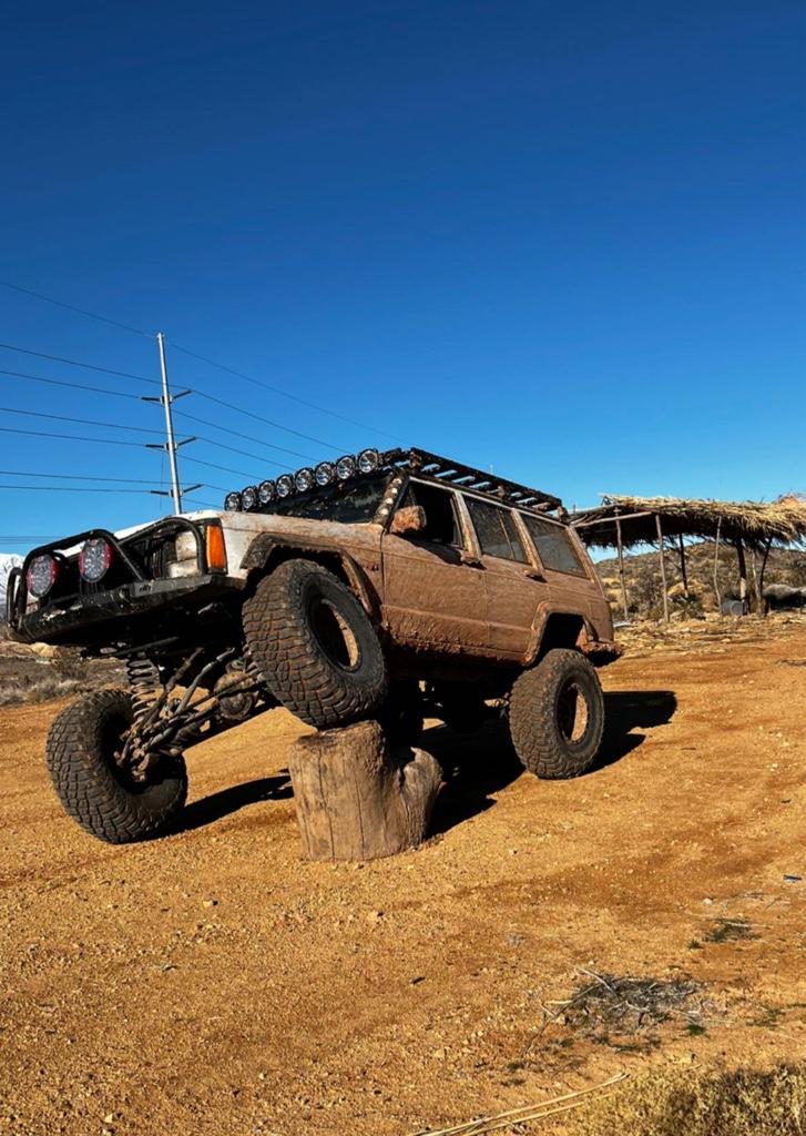

The real decent into madness started with lockers. The thought process was “if I’m going to put gears in, I might as well lockers in”. I would pay MSRP for the lockers, but my brother would put them in for free after hours. It was a good deal and ended up going with ARB lockers front and rear with a compressor mounted in the engine bay.
Pretty simple, yet capable build right? Lift and lockers. I could get pretty much anywhere with that set-up. There were a few more little things to tackle: the cooling system had issues (most likely from the previous owner converting it from a closed system), and the installation of a light bar.

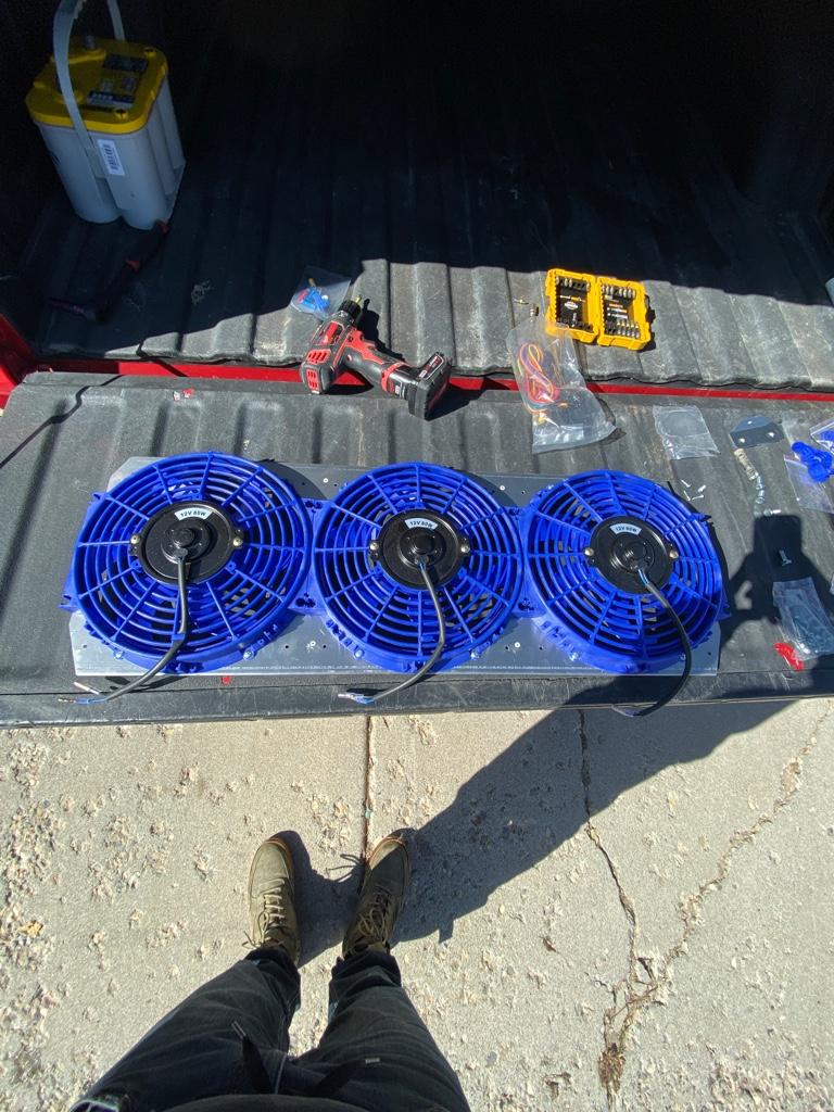

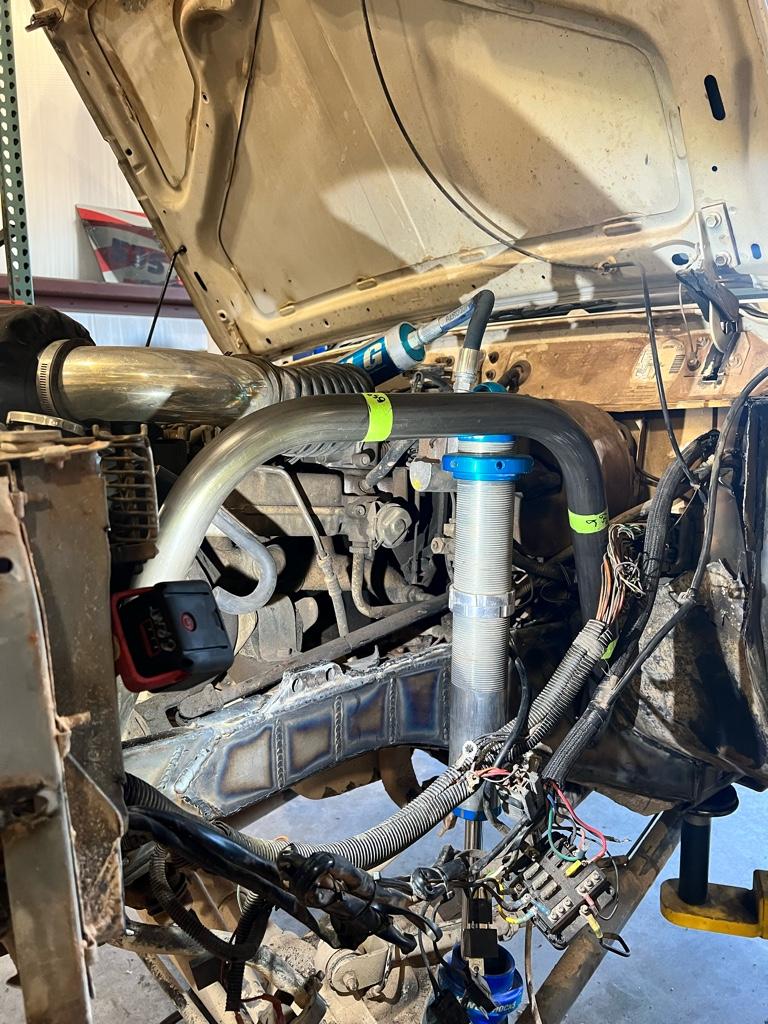

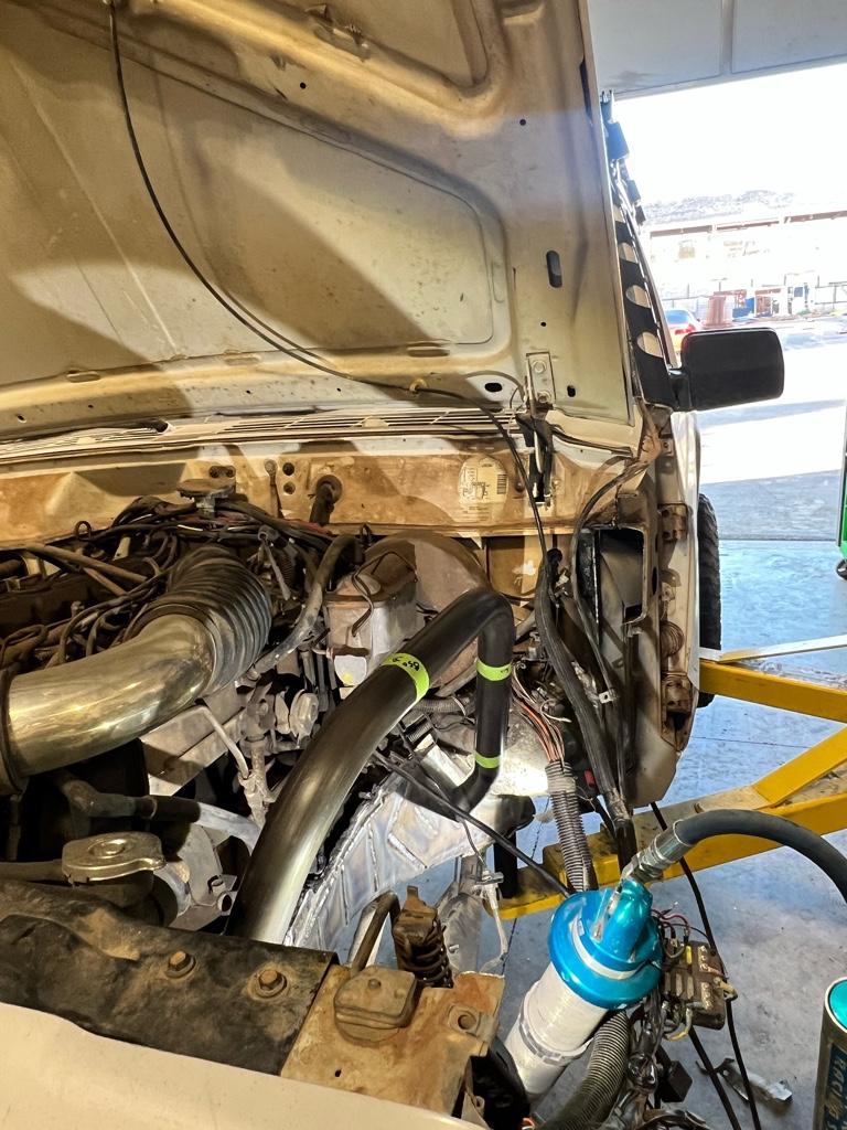

In an attempt to address the cooling concerns, the mechanical fan was ditched for a new shroud and triple electric fan set up.

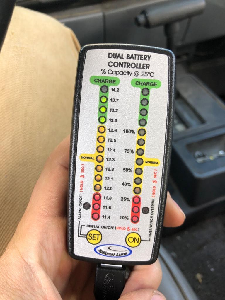

Lumina dual battery set-up was installed with one battery in stock location and a secondary mounted in the rear. With lights, fans, and fridge the single battery was having a difficult time staying charged.

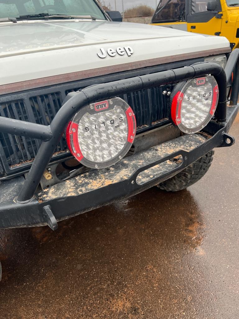

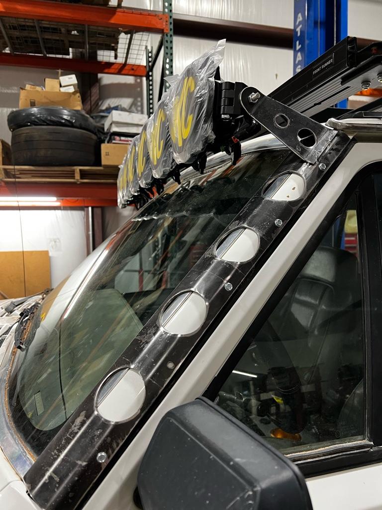

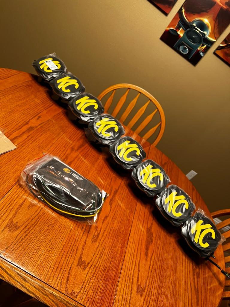

A pillar light bar mount. KC bar would not mount to the FrontRunner Roof Rack.

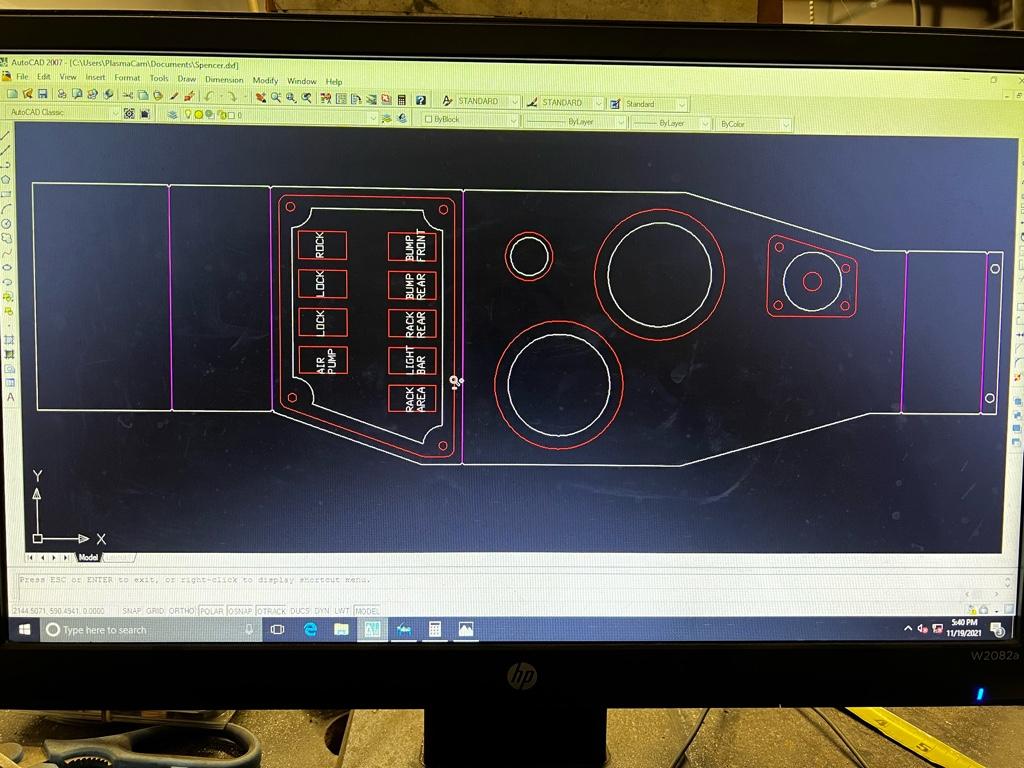

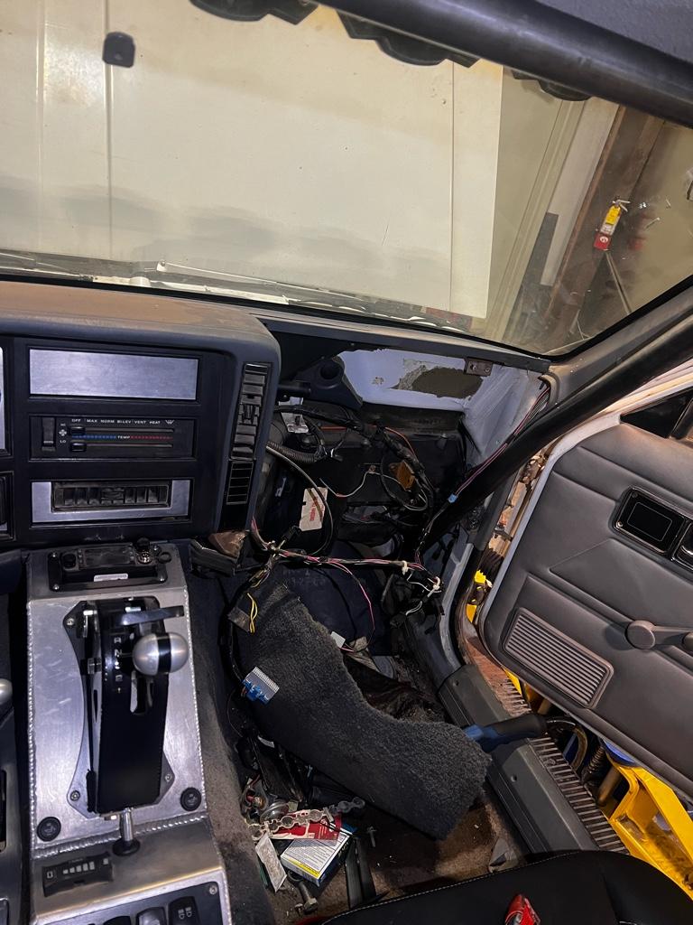

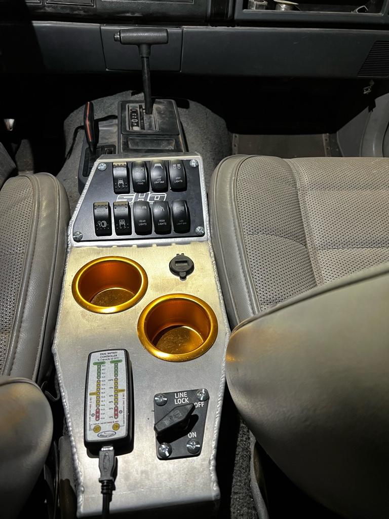

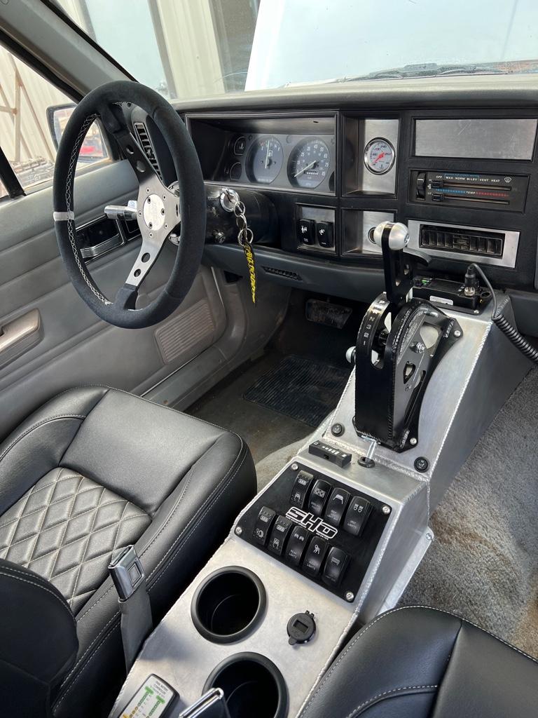

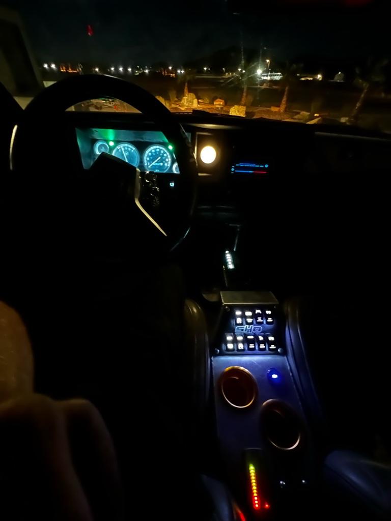

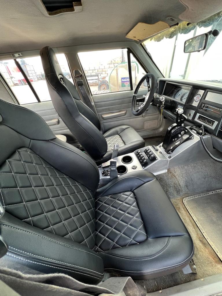

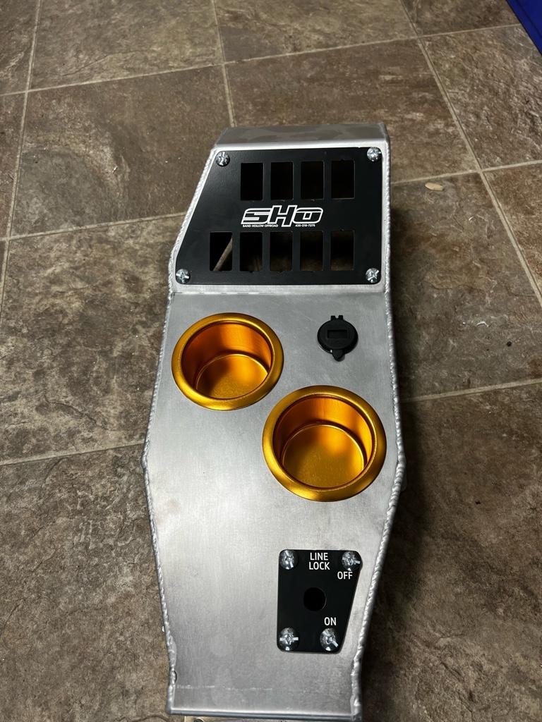

As a wedding gift. My brother designed and made a new center console. The base model Cherokee did not come with a center console. It had an emergency brake handle and that was it.
I absolutely despise the cluttered cabin that modern Jeeps have become. All of these “overlanders” look like they’re ready to go invade Iraq with the switches, radios, wires, gadgets, all over the place. I knew I would need to get a switch panel at a minimum, but I really hated most after market options. My brother made the best possible solution.
