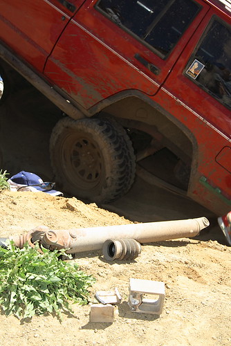

here is my 97xj with an add-a-leaf and a 2" or so lift block.
this set up got me 3 or 3.5 inches of lift with the stock shackles.
i have had blocks which have both cracked and failed completely.
in my opinion lift blocks can be dangerous and detrimental to your vehicle.
if you do any moderately technical wheeling, get a full spring pack for your lift.
i ran the add a leaf and block set up for a few years.
then this happened.
you can see the shattered chunks of lift block in the foreground
to be honest, i was probably a bit too deep in the throttle and some extreme forces were applied
we used two winches to level the vehicle
i used my winch to lower my jeep after anchoring to another vehicle above the obstacle
another winch simultaneously pulled my rear axle backwards to keep it aligned
leveling the jeep allowed easier assessment of the situation and made making repairs safe

I was under a heep at the junkyard one time, saw half an aluminum lift block bolted in place. I'm sure it was a whole block when it was installed...

MN rust, worn springs, and plain old leverage.......that's my guess.

Lift blocks are bad. Do not use them, period!
The further that your axle is from the spring, the more leverage there is on that part of the spring. This extra leverage multiplies the force on those components, causing a number of things to happen;
1- The blocks to fail, as seen above.
2- U-bolts to fail and axle to flip out from under blocks.
3- Excessive amounts of spring wrap.
4- Spring failure from #3 above, as seen in pic above.
Obviously, this also leads to other carnage, such as driveshaft damage, transfer case damage, and transmission damage, among other things.
Just don't do it!!!
Save your pennies and buy the proper spring.

It would seem that this would also be an issue for those who use the UBE from TNT at least from the leverage point of view. Anyone using the UBE's have these issues?
You guys all lift blocks are horrible, but the cast aluminum ones (every pic on this thread) are by far the worst. They slip, explode, crack, shatter, and chip horribly. NEVER NEVER run a cast aluminum lift block. If your going to go cheap at least get a steal lift block.
My cousin just f'-ed a block on her heep, it turns out the PO put a vato-zone 2" alum block in just before he sold it to her so he could tow a pop-up trailer better. After it started making bad noises from the rear end she kept driving it and not telling anyone. the block stretched and hogged out so bad it was acting like a pivot point and allowing the axle to rotate enough to let the pinion to move at least 6" up and down, she only stopped driving it and fessed up when the u-joint gave up the ghost.
I drank frothy beverages and watched her replace them with full packs the next weekend while giving a maintenance 101 session. She now knows EXACTLY how to fix everything back there.

UBE's, hmm, I built my own little over a year and wheeled the be-Jesus out of em with no ill effect. All depends on how tall you go. Same thing that's been said in this thread and the hundred other one's like it: it's all about the leverage.
