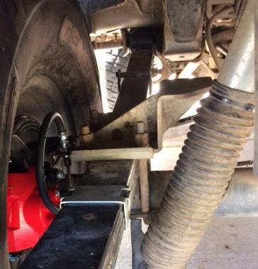

I’m running some leaf plates that I bought years ago from someone on NAXJA. I don’t recall who made it. I like that the extension that contacts the bump stop is raised above the height of the leafs. It’s held up remarkably well, probably because I don’t do any high-impact go-fast driving. Here’s a picture:
Looks like a strong and effective solution.
