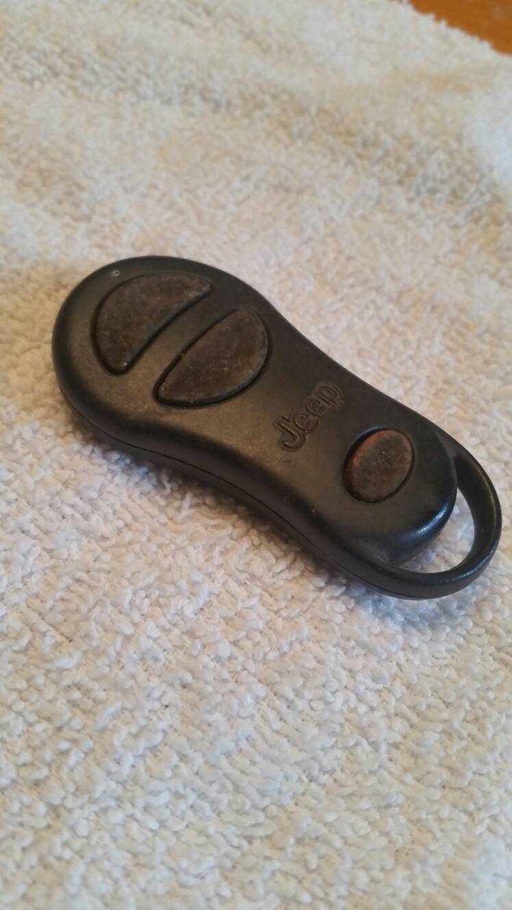

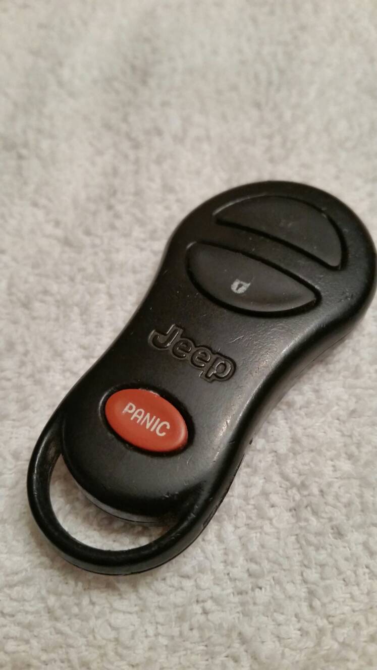

So today while at my favorite junkyard I found a 99 XJ and poked my head in to scope out the future parts purchases. First thing I noticed was this slime grungy fob laying in the passenger seat. So I snatched that bad boy up like a winning power ball ticket and ran off to give the clerk my $5 before anyone else could discover my evil plans.
The plan was to clean both my wife's original fob, the new dirt ball fob, and use the best of both to make one working fob.

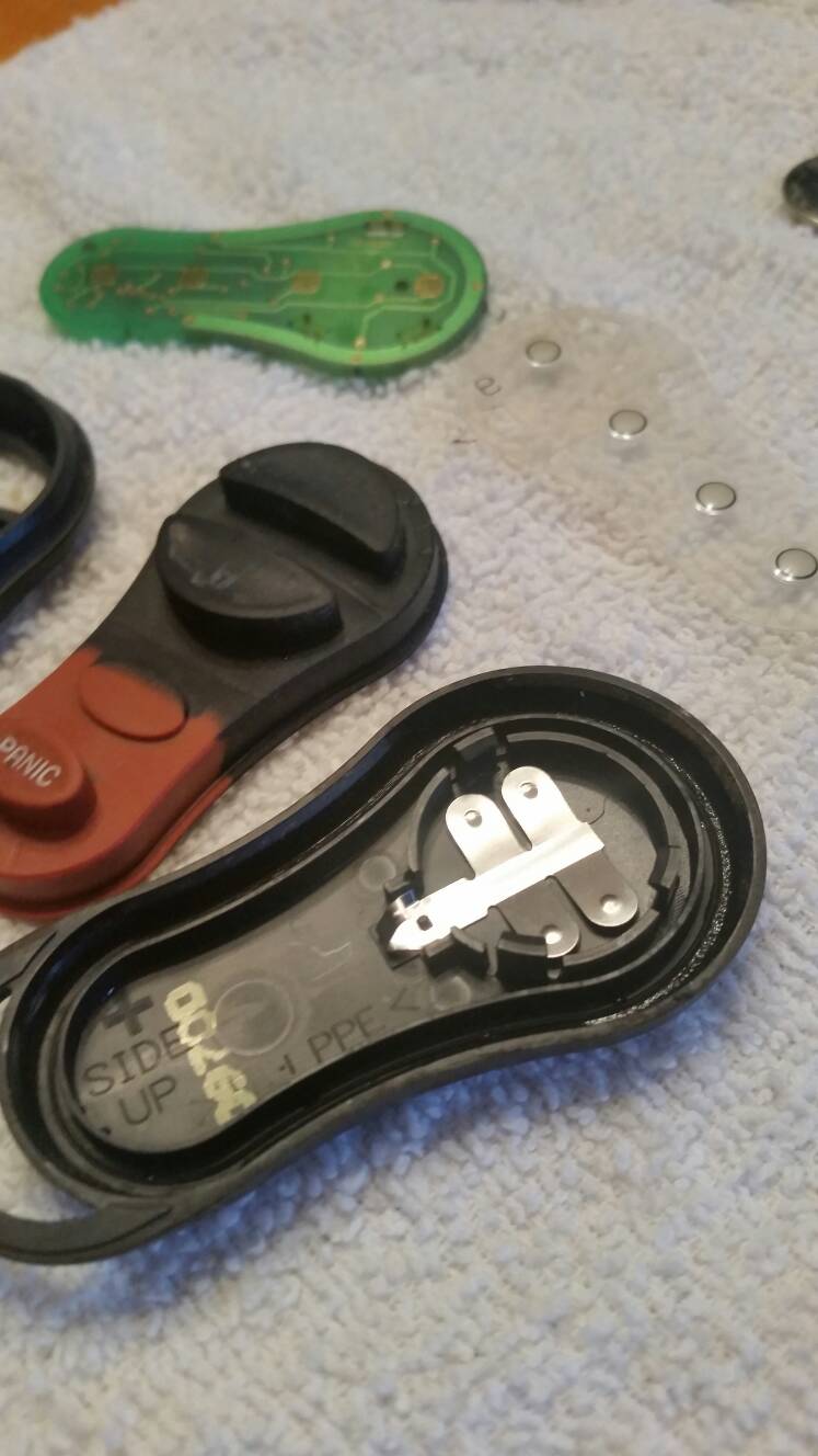

First thing find a nasty old factory key fob. It helps to do this job on an old towel or washcloth. Makes things easier to see and keeps small parts from bouncing into the twilight zone.
Next, look for the wide slot on the plastic housing to seperation the two halves. Insert a large flathead or thick coin like a nickel and gently pry the two halves apart.

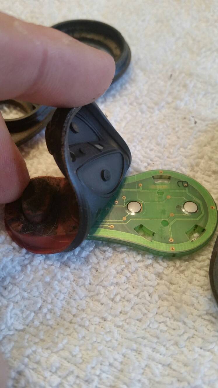

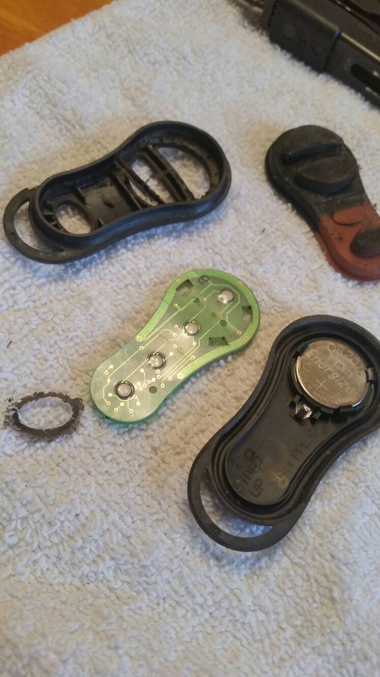

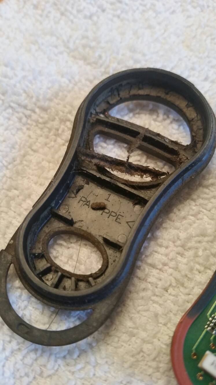

Carefully pull the rubber button boot out along with the motherboad. Give special care not to rip the rubber, as it is quite thin and can be stuck in due to the years of junk buildup.

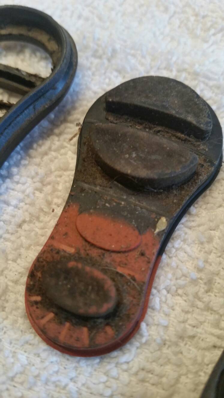

Next up, simply remove the motherboard assembly from the rubber button boot.
The clear plastic sheet that goes between the motherboard and rubber boot should just slide right off. If it doesnt, you may have to coax it off with a few drops of rubbing alcohol and a Q-tip.

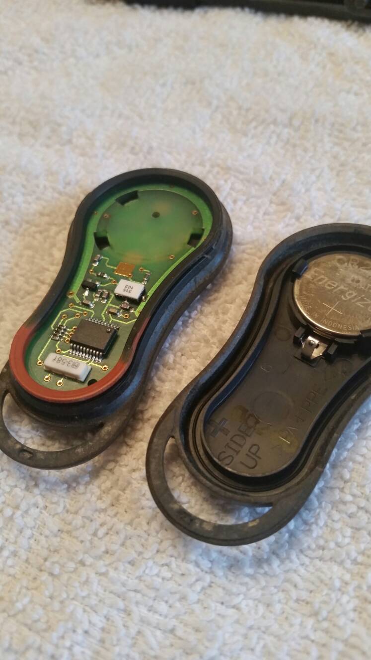

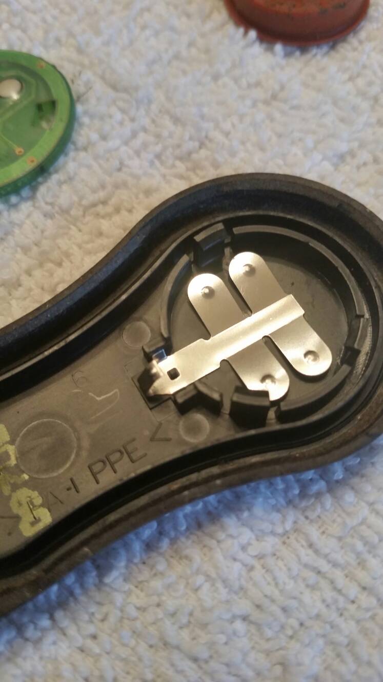

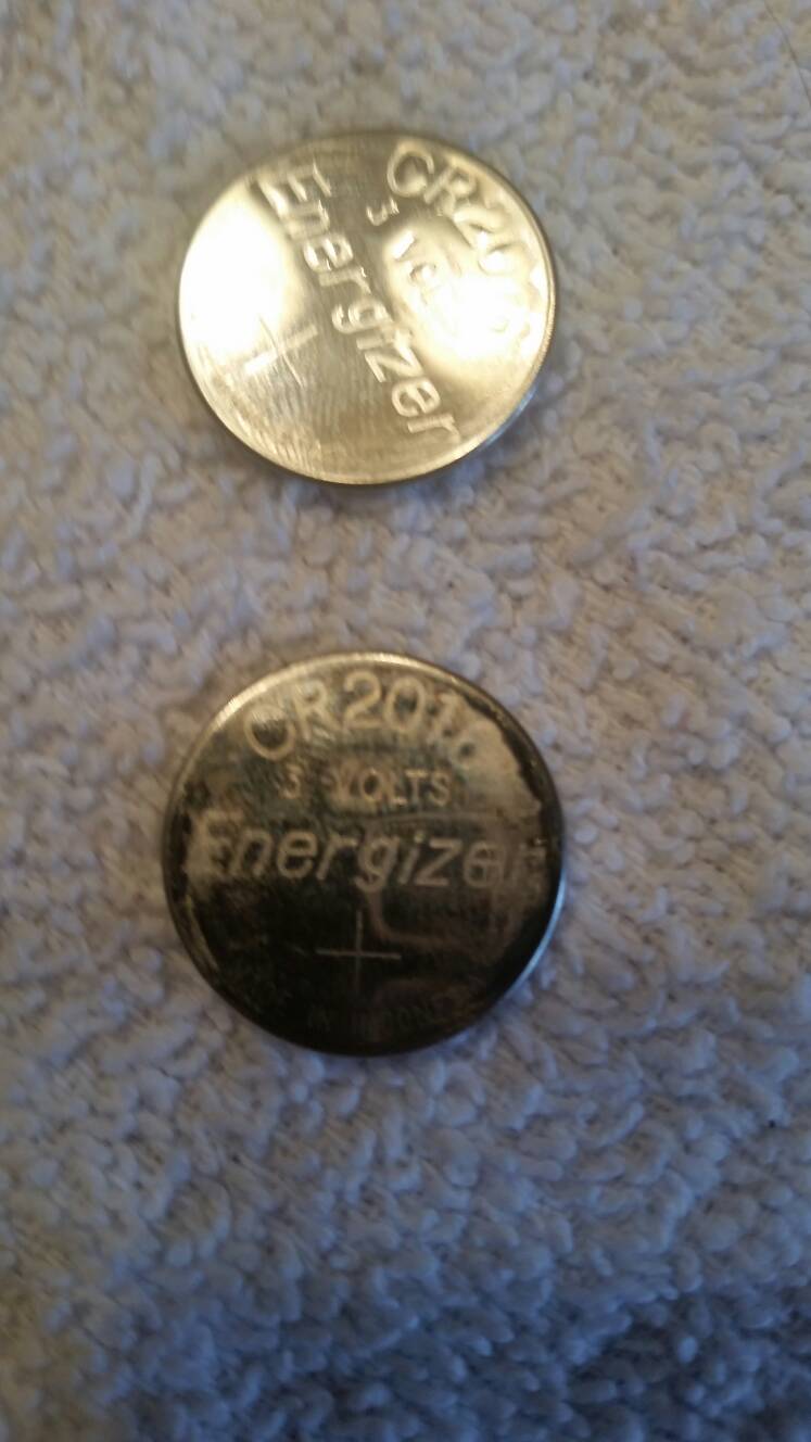

Next step, carefully pry the two batteries out of the battery slot. The three plastic tabs that hold them in are usually pretty forgiving, but try not to snap them off. Also give care not to tweak and bend the metal spring mechanism the rests under the batteries and contacts the motherboard. There is absolutely no need to remove the spring clip, so just leave it in place.

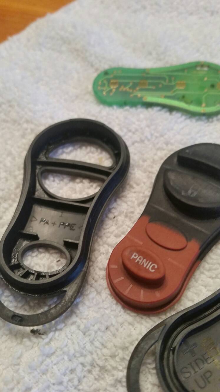

Lay all the pieces out on the cloth and inspect for things like cracks and chips. Rust or missing parts.
To clean things up, use some mild dish soap like plain Dawn to clean the plastic housings and the rubber boot. Let them sit for a long while to dry out or use some canned air to blow them dry.

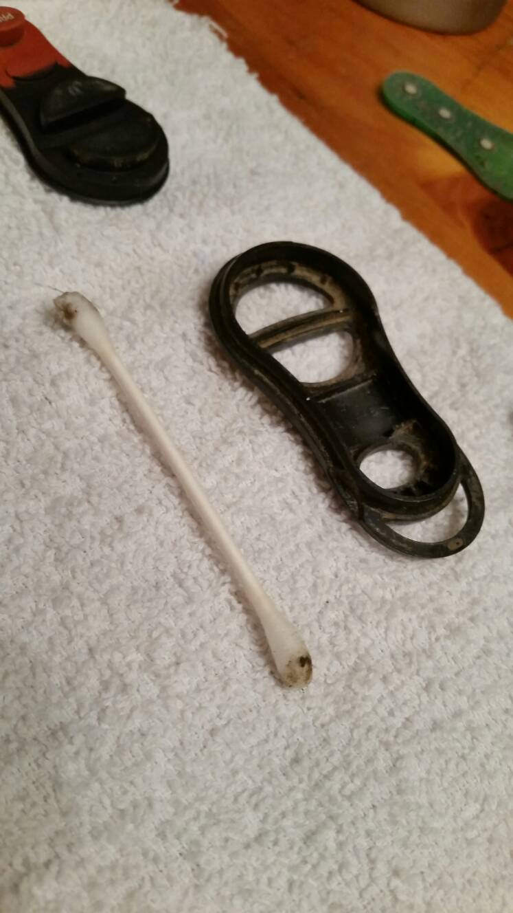

Use Q-tips and rubbing alcohol to clean the motherboard and the clear plastic contact sheet. Let them sit and dry for a while too or hit them with a little canned air.
You can also use the Q-tips and alcohol to clean out the small nooks and crevices that were missed by the dish soap scrub.

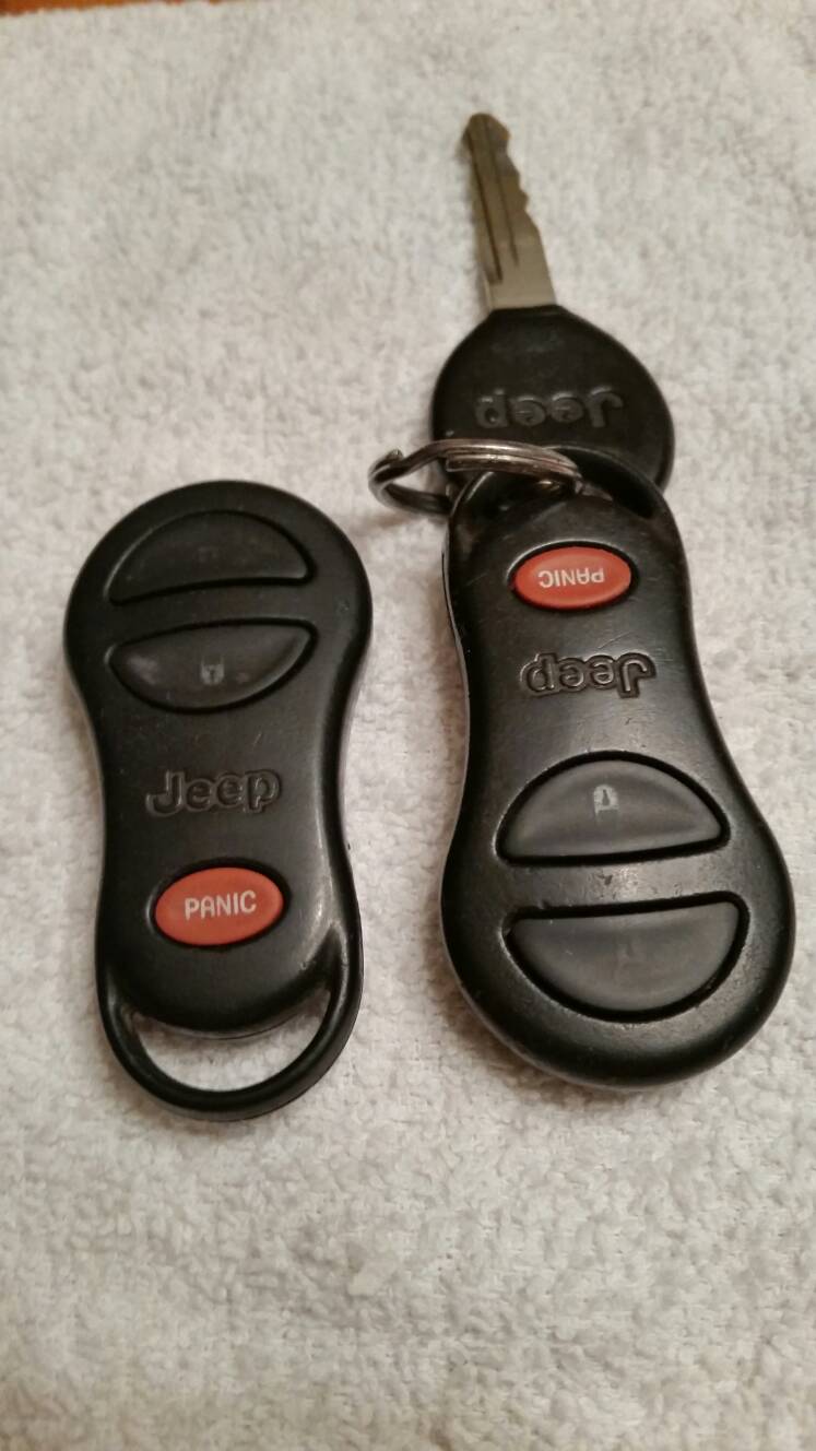

Once everything is clean and dry, assembly is just a reverse process of the disassembly. Carefully fit all the pieces back together how they came apart and don't force things. You'll be amazed at how much better your "new" factory RKE fob works compared to your "old" one.
