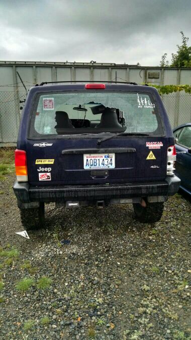

I hate thiefs.
Glad you got it back, but ask the yard to roll up the windows. Doesn't look that bad. I would pull the valve cover off before i started it if they pull the seals off the cover. Don't know what they may have put in there.
Again i am glad you got her back.
Good luck
holy cow, ya kill switch in mine is always armed, the naxja chapter down in AZ had a "kill switch" party and it was like 15 bucks in supplies and helped hook it up to the fuel pump relay under hood, there was 12 or so Jeeps that showed up. I am debating some kind of alarm for the jeep but I dont want to be that guy in my neighborhood with a car alarm blarring when I am not home.
I am always nervous if someone wanted the winch/rope or bumper if they had long enough they could take it all. hope your insurance gets you back in action, if you need anything I am in seattle and can always help.
Did they thrash it offroad or just tweaker steal things?

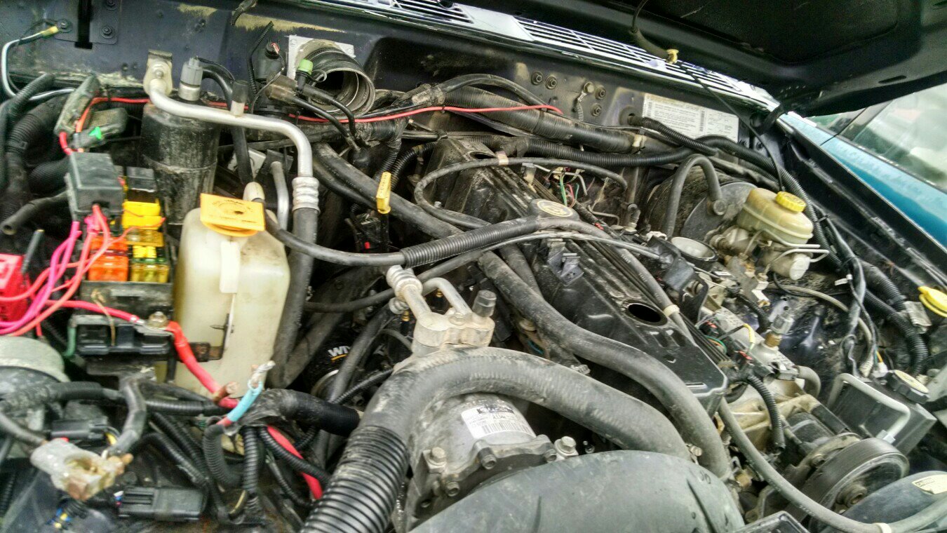

I got the Jeep home! Its got oil POURING out of the rear main seal, but it has good oil pressure and no knock, I'm guessing I'll be redoing my RMS. I had a hunch that it was ate up anyway, I have had a persistent drip from back there for a couple months. It runs nice and smooth! I'm guessing I will have it back on the road sometime in December at this point though... Its nice to not be as stressed as I was initially.
I've been keeping busy cleaning away one Saturday at a time on my Jeep. It looks like my insurance has finally figured out that equipment adds to the resale value, so hopefully they will cut me a check soon so I can get back on the road.
As for the status: I confirmed the RMS is blow, and figured out the steering wheel lock is destroyed. The underhood electrical has been massively worked on so its no longer random cut wires!

It’s been a while since I updated, but I have McSquizzie back on the road! On the list of damage was:
1) The radio, amp, and pod had been taken
2) Three windows had been broken out
3) The spare had been stolen
4) Plug wires, Spectre intake, Optima, ARB compressor, and the winch had all also been relieved of my ownership
5) The rear main seal was badly leaking
I bought it back because it still had four wheels and tires, ran good, it shifted, my complete OME/JKS lift, the bumper, and most of the interior was still there.

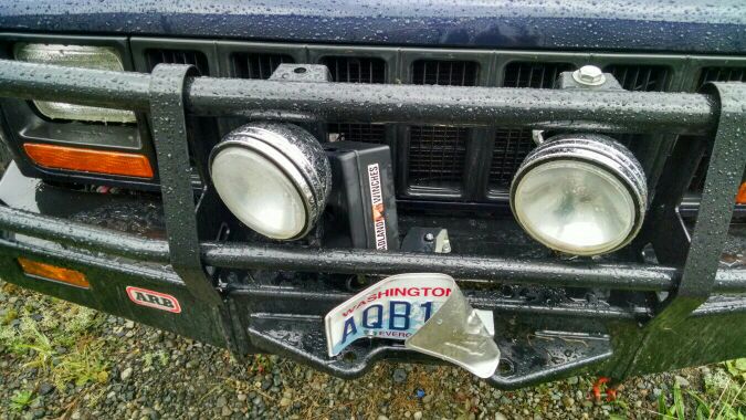

I dont suggest such a large winch, after drastic trimming, it barely fit.
I also had to cut into the grill to fit the solenoid, which was no big issue, because whoever stole the winch broke my grill while removing the winch so I didn't have much to loose.

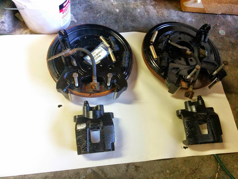

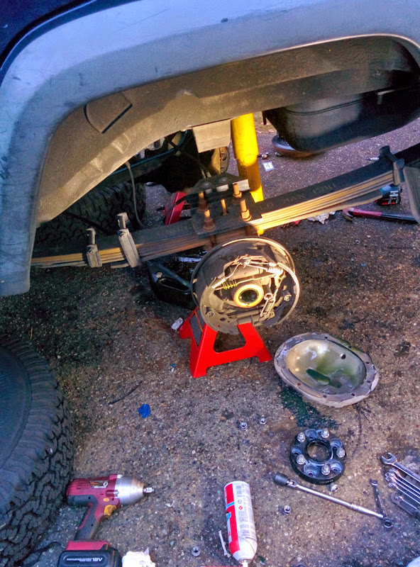

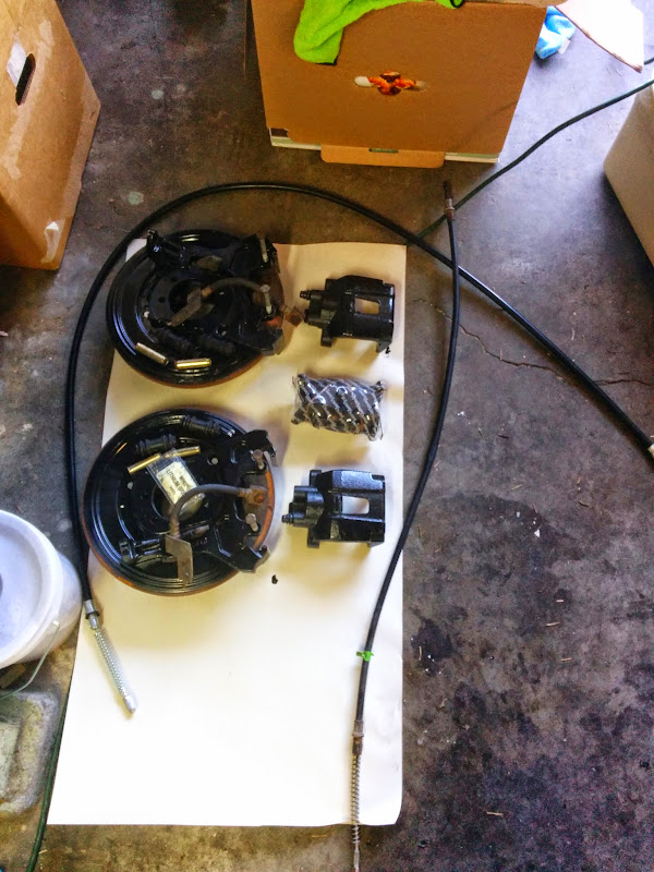

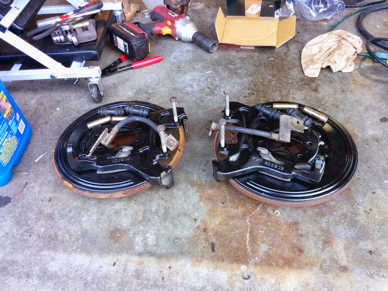

The u-pick-n-pull had a 2005 Liberty back in November with rear discs. $80 and a couple hours later I walked out with one mangled backing plate, one good backing plate, two calipers, to rotors, two caliper to hardline hoses off a ZJ, and an e-brake cable off a ZJ. I jumped on rock auto and got new e-brake shoes and hardware, pads, and a Dorman C660004 (F67Z2A635AA) e-brake cable. If you wanted to just grab that cable off something in the yard, look for a 1995 – 2002 Ford Explorer or a 1997- 2001 Mercury Mountaineer. I then bought 10 lug nuts for the front hubs on a 2000-2001 Jeep Cherokee (they are longer than the stock rears which become too short in this swap.
The passenger backing plate was all bent to hell from the junkyard, so I straightened it and re-riveted it to the cast section. I used black ceramic enamel on there to keep it nice and rust free.
I painted the calipers to match the backing plates
All the needed hardware, just chillin.

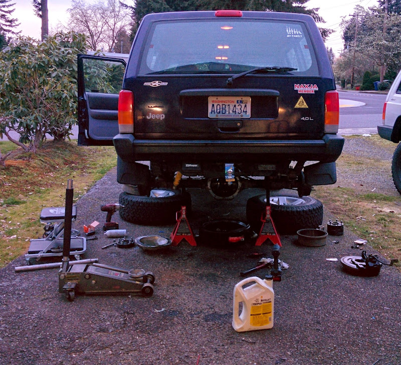

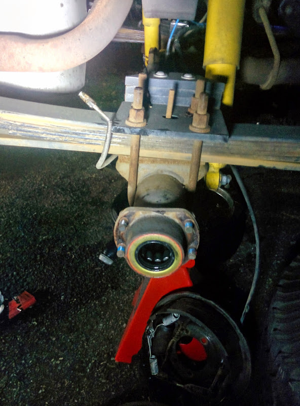

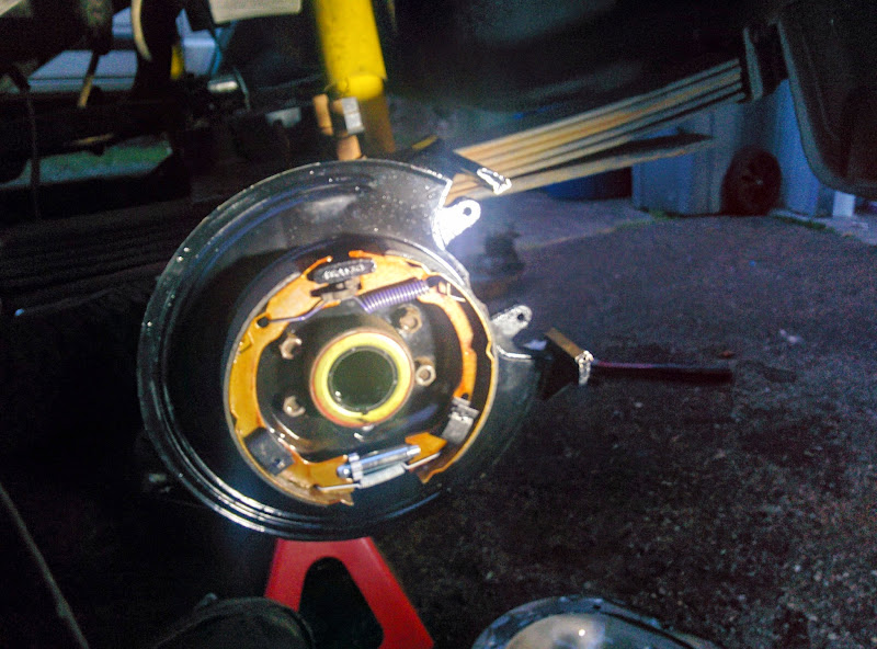

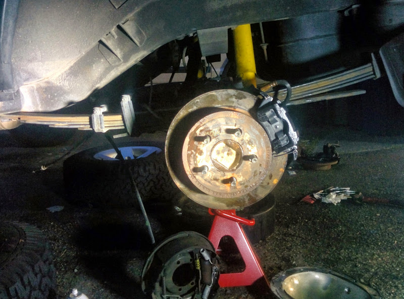

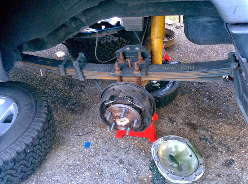

I decided to do this one afternoon after work. I started at around 4 PM and finished around 10 PM.

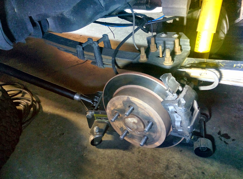

Press some longer studs in.
Axle comes out, backing plates simply unbolt.
I reused the Cherokee studs. I may go back if I ever need to do the bearings, but I found the part number for the studs and don't think they are still in production. Does anyone know if just plain old high grade bolts are acceptable?
This setup is so simple.
All done!

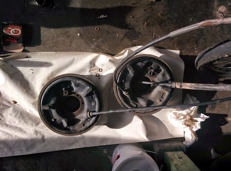

There's where drums belong, not on my Jeep!
All in I believe I’m under $250 but it’s hard to tell sometimes on these swaps. I found myself at the parts store probably three times.

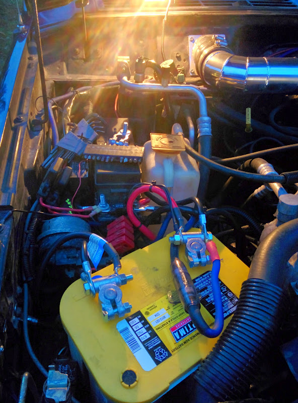

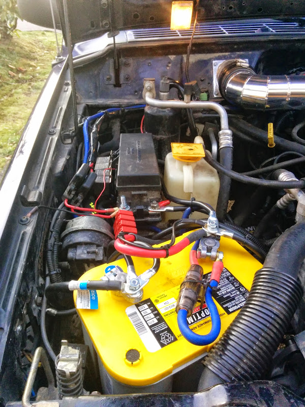

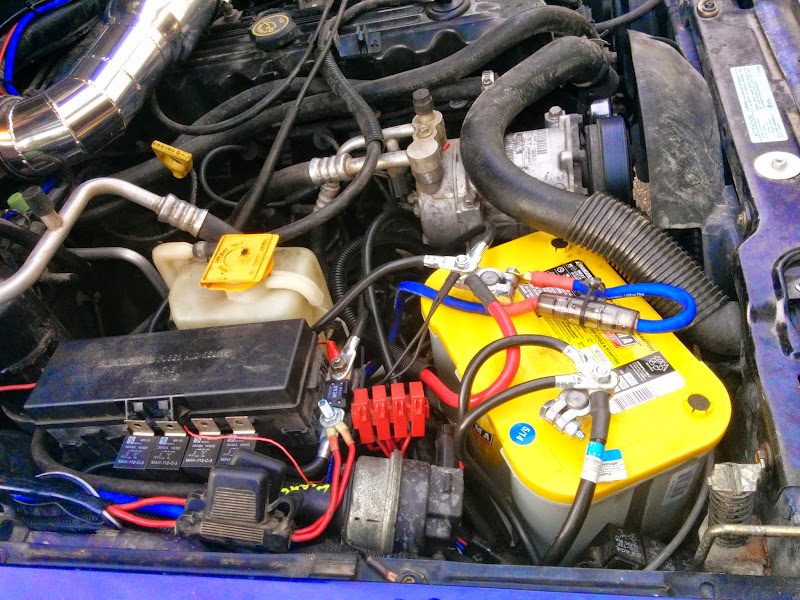

I picked up an Odyssey PC1200 at a swap meet for $25, and it fits perfectly between the radiator and the ARB compressor. All I needed was a tray, some wiring, and an isolator setup of some sort. I had a factory tray from the other side, so I cut it in half and bolted it to the drives side. I made a strap up that fits well out of scrap stock. For tie down bolts I straightened out a set of factory spare tiedown bolts and even used the wingnut for one side.
We all know that some sort of isolation is needed, and I looked at a few solutions. Most of what I had read stated that all of the cool kids these days are using an Automatic Charging Relay to isolate their batteries. This allows the ECU to still monitor the charge of the batteries and disconnects them when they aren’t charging so you don’t ruin them… at least that the theory. I started reading up on the Blue Sea SI-ACR and figured out that it only did up to 120A alternators (I just installed a 136A), so I was all in for a ML-ACR which will give me lots of room at a rating of 500A. The ML-ACR has a couple neat points, 1) its waterproof, 2) it’s got a manual override, 3) there’s a cool switch that allows you to operate it in the cab, and 4) its big enough that I can “jumpstart” myself if I’m dumb enough to leave my headlights on or something like that.
First things first I needed to fab up a mounting bracket. I got some sheet metal and ½” angle at the hardware store, along with some machine screws to mount the ACR with. Ignore my crappy cutting, I ran out of cutoff wheels halfway through this.
I painted the complete bracket in engine ceramic enamel to finish it up. I shifted part of the load (like the sub amp and the radios) to the second battery.
The switch is neat-o but I do not like the big bright red LEDs that are on when the solenoid is engaged. I’ll probably look for some sort of less-intrusive indicator.
Its getting a little cramped in the engine bay...
