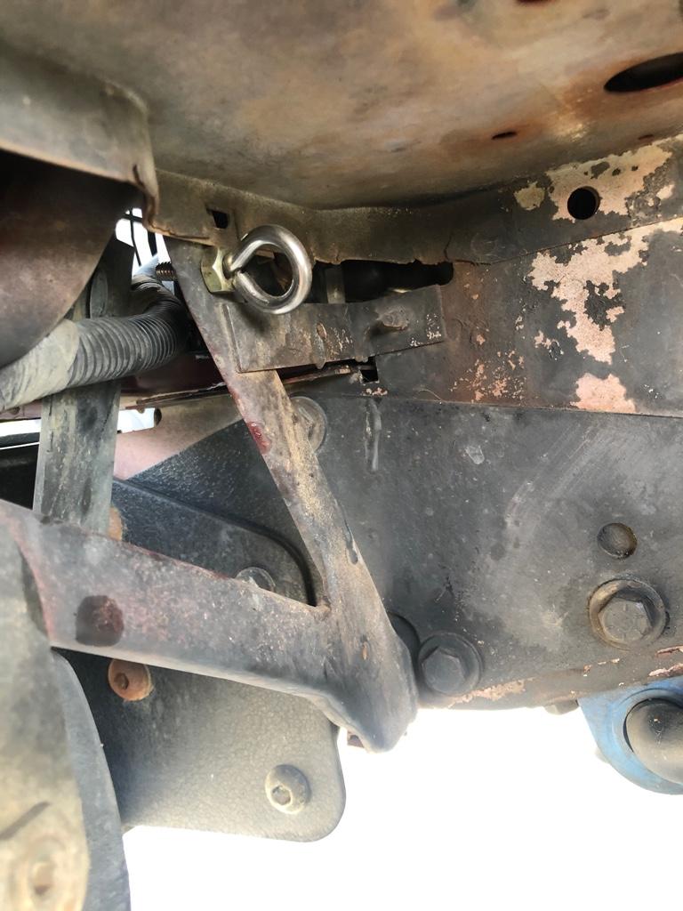

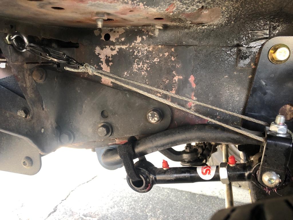

What do you do when it's time to disconnect them for the trail? How do you keep them secure when offroading?
They come with storage pins but you need the factory skid plate which I don’t have. I just used Velcro straps to hold the link to the sway bar then a piece of 500 lb paracord attached with clips and a z-carabiner that I hook onto a small eyebolt.
This was my “proof of concept” attempt for my first test with them off. I plan on upgrading it all and moving the eyebolt but so far they held perfectly. I’m sure some more skilled people have better solutions though.
