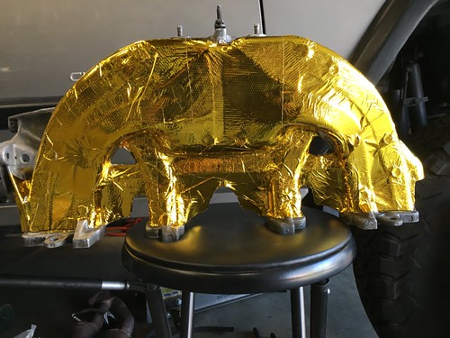

I have a 96 that has bad heat soak issues -- while doing some work I decided to add a heat shield for under the intake manifold -- Hopefully it helps some

Here it is mounted on a spare intake manifold I used to design off of

The heat reflector tape finally showed up -- While I was waiting I added another piece to deflect heat from the fuel line that runs under the manifold
picture.php
I cleaned the aluminum with acetone before installing the heat reflector
picture.php
picture.php
Just an update — custom heat shield and DEI fuel rail and injector wrap have been installed
I’m happy to report that this has seemed to cure my heat soak issues while running — no more dying while sitting in traffic
Before the heat shields this XJ couldn’t be left running while stopped for more than a few minutes once warmed up in 70* weather — the fuel would vaporize in the fuel rail/injectors
During this past 95* heatwave I purposely left the engine running while stopped multiple times — no issues, just keeps running
I did also install an E fan manual override switch just in case — haven't needed to use it while the engine is running

Next you need to add another shield on top. A burrito warmer. I understand the Renix motors came factory with burrito warmers.
Looks very good, I made a small shield years ago when I lived in Phoenix. 120 degree days and the pavement is radiating 160-180 up at the vehicle doesn't go well for these 4.0s.

If you are just trying to better prevent vapor lock, it will help to attach the gold reflective material under the intake manifold so that it closes up all the openings between the intake runners. You could also consider sandwiching some high temp insulator sheet between the intake manifold and the gold reflector. Maybe confine the high temp insulator to leave a 1/2" border around the bottom of the intake manifold and run the gold reflector up the sides of the intake manifold. And leave some strategic holes in the high temp insulator in the interior region under the manifold so that it the gold reflector can stick to a few points under the manifold. Definitely something that can be done in about an hour.
