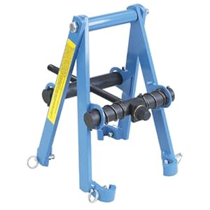

If you do end up using a spring compressor, use caution, they can be dangerous should the coil slip out explosively. Another reason not to use them in this application IMHO.
If obtaining one is your concern, when I lifted my WK I borrowed them from an auto parts store. Too easy.
Just looking at a compressed spring you can see how much potential energy is there, be careful.
HF makes one that clamps the spring at 4 points and locks it in. One big bolt compresses the assembly. Not as inexpensive as those 2 bolts with hooks things, but I certainly felt safer knowing that the spring wasn't going anywhere once I had it locked in.

Scary compressor
Safe compressor
I own a V-style unit but have never used it on my XJ. I bought it to do strut jobs on cars.
