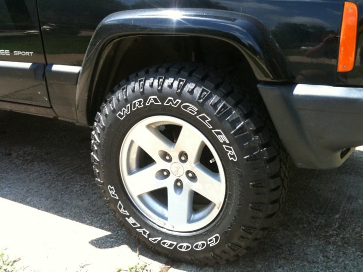

Thanks for the input guys. The end goal with this rig is general capability - I'd like to be able to wheel pretty much wherever I want to without necessarily going into the hardcore technical trails (more for camping and scenic touring). As such, 31" tires are about as large as I've ever really considered going.
In the end, I did pick up the DuraTracs in 245/75R16:
These things are TONS quieter on the road than the MT/Rs they replaced (previous gen), but at this point they've only seen about 7 miles of asphalt so we'll see how they turn out in the end.
I just got a quote from RE for a 3.5" lift (RE6025) which should come out to ~$490 since I'll be omitting the LCAs ($95 savings, as I already have a set of adjustable uppers and lowers from IronMan 4x4 Fab that have been gathering dust for nigh on 9 months now). Now I just need to figure out whether or not I want the kink in the rear passenger side of the frame pulled or if I want to do 2.5" AALs and boomerang shackles to eliminate contact...

Ha Ha. I didn't read the second page so ignore the above. Your jeep looks real nice with the 245's.
