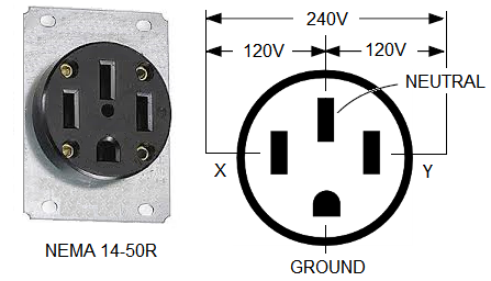

I'd put a 50A plug on that circuit and rock out. How you wire it depends on the plug, but in general the hots are opposite sides and the neutral and ground are opposite top and bottom.
something like a 14-50 is what you're looking for at the hardware store.
that's 4 poles 50A 220V. Technically that's all kinds of wrong because your breaker is oversized. Whatever. Unless you want to change the plug on your welder to the 60A plug and buy a 60A receptacle. That would make sean happy.
So that gives you a hot on each side, a ground in the top (image is upside down, ground to the top these days) and the neutral in the bottom. Ground is the bare copper/green, White is the neutral. Black wire goes to the brass terminal. Red goes opposite on the silver one. Done.
Check with a meter between the hots for 220 and from each hot to neutral for 110 before you plug in your welder.

here's a better picture
edit:
