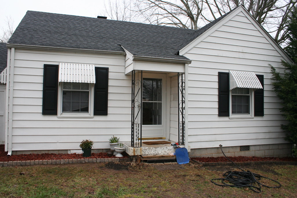

I am assuming you are going to put the steps where the wood is and leave that big platform there ? If so I would consider looking at some 24x24x2" precast concrete pavers, 4 or 6 on the ground in front, two or 3 on the next level near the platform, two high if needed.
Yeah, the wood and the black things (square tubing) will be removed and stairs put in their place. I have since put some cheapo red pavers in the front of the stair to make a 'landing'.
A standard size (8"x16") cinder block fits where the wooden stair is now. It's the perfect height. Only problem is we'd have to get the blocks that are deeper to make a tread that's more appropriate. I should have taken a picture this morning.
