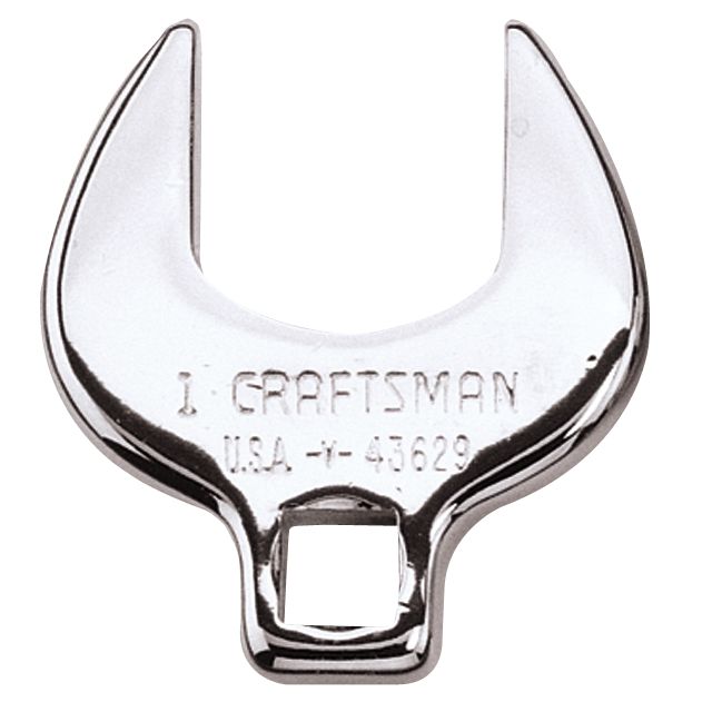

at which time once it's on you can use a box or open end wrench to turn it... or you can stick a crows foot wrench and extensions with a ratchet. This is a crows foot
