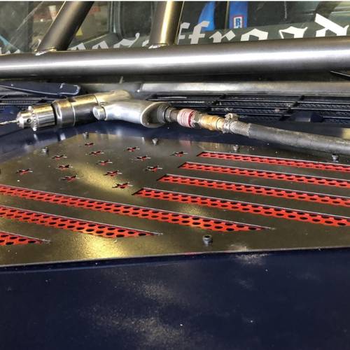

So, on my laundry list of stuff to do to my pile, I'm planning on doing some hood vents to dissipate some heat.
So far most vents are louvered and angle back and not all that good looking IMO. So found a pic online of a plasma cut design.
I like the design and idea of it.
However, I question the purpose of the angled back louver. With it angled back does it help force air down around and out the bottom while moving? Or create a venturi affect and help suck hot air out through the top while moving?
How would a set like the picture given do? Obviously anything is better then nothing, just curious as to the design of louvers and its effects on air/heat transfer.
Also, live in AZ. Dont care about rain and water because well what's rain? Lmao

The louvers are for venturi effect. With the slight upward slant of the hood, the flat holes may actually introduce air pressure behind the radiator at speed (bad).

As said above, the raised/angled part of the louvers causes a venturi effect to help pull the heat out of the engine compartment. I have the RunCool large high flow louvers. I do not believe they really made much of a difference in water temp but they did make a large difference in under hood temps. You can see the heat rising from them any time you are stopped. I haven't had any water problems from them and my Jeep sits outside in the rain all the time. Would I do them again? Yeah. Did they make a huge difference? Not really.

I appreciate the input rockwood and blubullet. I figured it was for the venturi effect but did not think of the reverse airflow situation.
Honestly, my concern with these vents is not for driving. Its main and sole pupose in my eyes is for underhood temps once the damn thing is shut off. Im tired of a heatsoaked engine bay making my life miserable and its not even 100deg yet.
