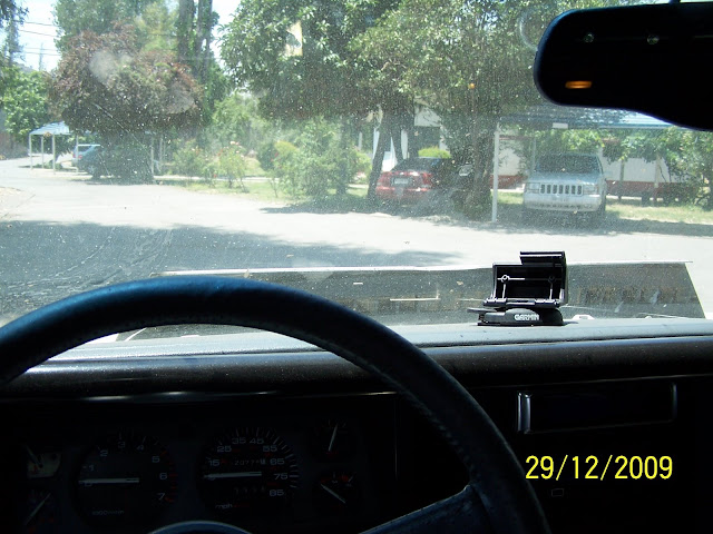

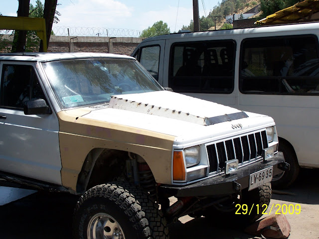

Ok, here´s what I got right now, It's just a test to see if I have enough space. I'm lowering the rear to 3", now I have 3,5", I will soften the angles and see what comes out, I think I will make a little bend in the middle and take it flat from there to the rear (windshield side)
Any opinion, suggestion or whatever is very welcome.
Unfortunatly I need that space, otherwise I would have to bend more rearwards and with more angle.
I can't do much with the front, I'm working on the sides though. I'm lowering the angles to make it look like it was part of the hood.
