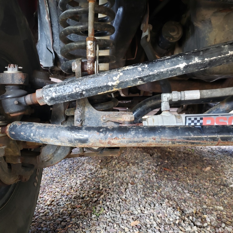

There are two things you can do, one you can actually raise the swaybar axle mount - with a product like this. https://www.amazon.com/gp/product/B005TTZVRY
I'm using something like that now. The issue is the upper arm on the knuckle hits the bolt for the swaybar link to the mount. Look at your second pic--the upper arm and the swaybar link hardware are on the same plane. Honestly though I am not worried about the swaybar position, I have a lot of choices there. I am really concerned about trackbar length and position.

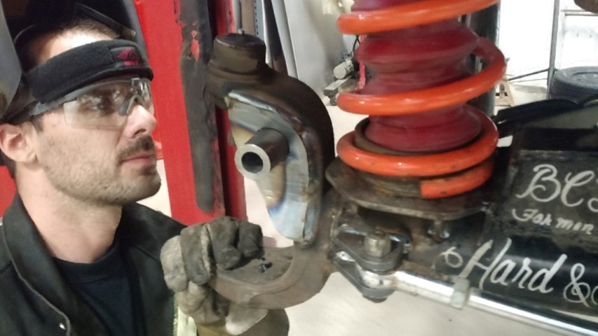

Quick measurement shows that the stock axle bolt hole for the trackbar is about 35" to the outside edge of the frame rail. I can't raise the stock axle hole vertically because the spring is in the way. And I can't put it over the axle because the UCA is in the way. But if I put it in front of the axle and inboard about 3" to clear the coil then I will only have to extend past the frame rail about 3" which is perfectly acceptable.
I think RuffStuff sells both of the brackets I need:
https://www.ruffstuffspecialties.com/catalog/PAN-OFF.html
https://www.ruffstuffspecialties.com/catalog/PAN-OUT.html
Also saw this frame mount on a local fab shop's page, kind of what I am thinking about
Move the trackbar bracket forward one hole, cut the bottom half off, and weld one of those on, then weld the lower bracket in front of the axle
