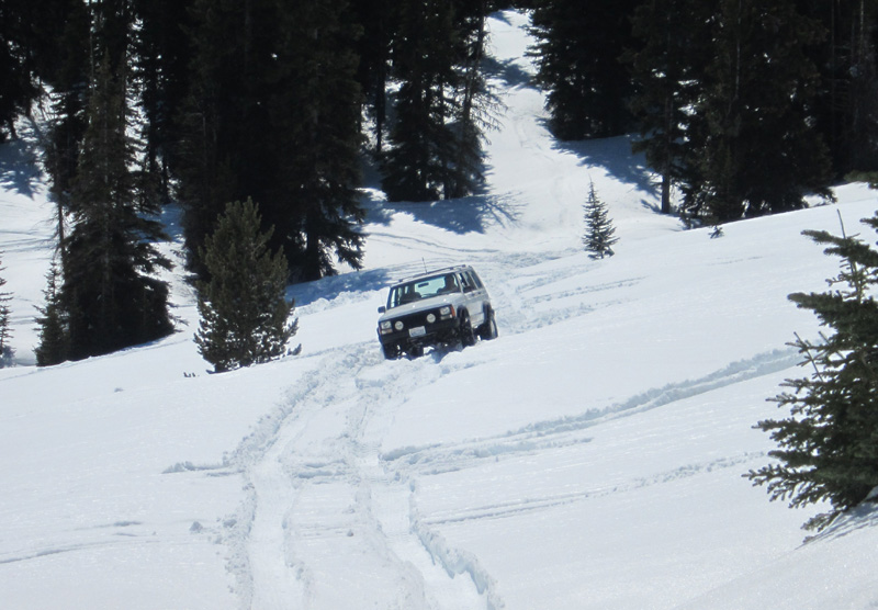

Just trying to help:
31 Duratracs with 3" lift:
You think you'd get bored with 31s? HAHAHA!!
