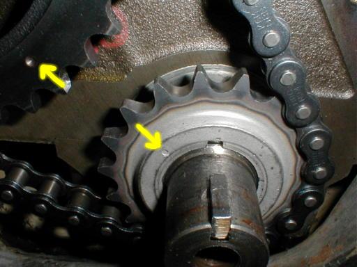

If Im reading this correctly he is saying both marks are at 11o clock
Both marks need to line up. like sit right next to each other. like this
Turn the motor over one more time to reach the compression stroke and it'll line up.
