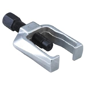

I assumed that I could use a pickle fork to separate the knuckle from the ball joints - should I be using something else?
Yes, a pickle fork would work, but I preffer using a set of ball joint splitters. I have a set of these and are worth their weight in gold when doing steering and suspension work. The large one was used to pop the pitnam arm of my old steering box.
They are also on the "barrow" program at Autozone. If you are doing tie-rods and such as well... do yourself the favor and get a set.
