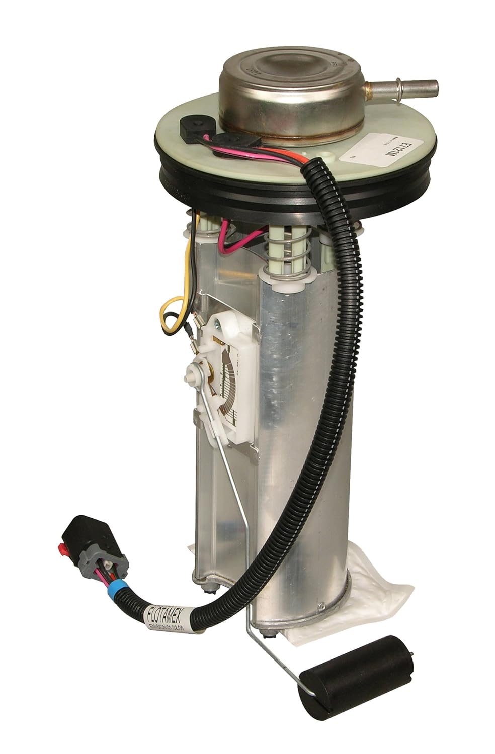

Anyone have a favorite fuel pump brand they want to recommend? I'm having issues with extended crank times. I've read this can be caused by a failed component in the fuel pump assy. Also I've got fuel gauge issues. The gauge reads a full quarter tank low. So even with the gauge sitting on "E" I still have 4 to 5 gallons of fuel in the tank.
These are the two I'm looking at now but if anyone else has any suggestions I'm all ears. As well to anyone who has had direct experience with these unit.

I don't see a Bosch module/assy anywhere. Just the fuel pump itself. I'm looking for the whole assy. Like this

It's not on there now, the bosh assy. Just the pump by itself not the whole assy.
