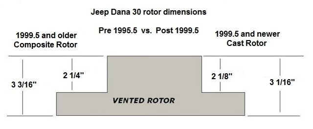

Lay your old rotor on your bench and measure from the bench to the top of the rotor. Be aware that your rotors may have been replaced previously and may have a different physical appearance than described below. The physical dimensions will be the same as noted.
Factory original Composite construction rotors had a rounded off corner at the wheel mounting surface and look like two pieces joined together. ( Nearly all factory installed composite construction rotors have been replaced with cast iron replacement rotors that have been machined to composite rotor dimensions. Do not simply look at your rotors and assume you have a certain type, measure them.)
- Cast vs. Composite Dimensions -
Composite dimension rotors had an overall height of 3 3/16". Cast iron replacement rotors can be machined to composite rotor dimensions, which is why you have to measure the parts you have, and the parts you are purchasing. Composite construction rotors had a thin sheet metal like appearance at the holes where the lug nut studs come through and measure about 1/8 "(.125) thick in this area.
Cast dimension rotors are thicker at the lug nut stud holes and measure between 1/4" (.250) to 5/16 (.320) in this area. Cast rotors have an overall height of 3 1/16".
*** Replacement rotors can be machined to Composite or Cast dimensions. Therefore, you cannot rely on appearance alone, you must measure your current rotors and compare the dimensions to the replacement rotors at the auto parts store before purchasing. ***
If your hubs and rotors are not matched by type, there will be interference between the two parts, the tire/wheel assembly will be bound up and not move freely, and the Jeep will not move.

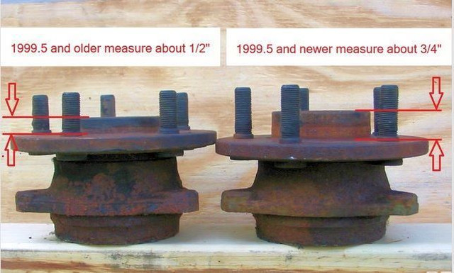

If, after measuring your current rotors, you are still unsure of which type of rotor/bearing you have or if you suspect that a previous owner or a repair shop may have installed replacement parts, compare the Unit Hub Bearings to the pictures below.
Hub Type Identification -
- 1999.5 to 2001 unit bearing/hub on the RIGHT of the picture below uses the CAST DIMENSIONED ROTOR. The 1999.5 - 2001 unit bearing/hubs have the taller ring around the 36MM shaft retaining nut. It is about 3/4 inch tall and the hub has longer lug nut studs than older hubs. See pictures below.
- 1990 to 1999.5 unit bearing/hub on the LEFT of the picture below uses the COMPOSITE DIMENSION ROTOR. The 1990 - 1999.5 unit bearing/hubs have the ring around 36MM shaft retaining nut that is approximately 1/2 inch tall. See pictures below.
Cast iron construction replacement rotors can be machined to composite rotor dimensions, which is why you have to measure/compare the parts you have, and the parts you are purchasing.
If your hubs and rotors are not matched, there will be interference between the two parts and the rims. The rim will be bound up by the interference and will not turn freely, and the Jeep will not move.
After seeing the above pics, these are definitely cast. The rounded vs the edged "hat" are the dead giveaway! Thanks for the updated info!!
thanks for the help!!!! I finaly got it. It had one bearing/hub for composite and on cast. when I got everything matched up it went great. Now I have to get the ABS light off and it will be good to go. thanks very much!!!!!!
