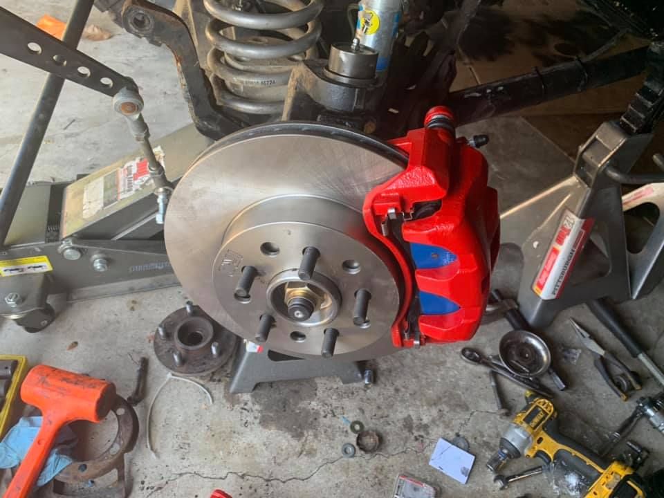

07-08 Dodge Nitro Rotors will work. I did not need spacers. 00-01 hub bearings. Does need the spacer welded on.
I did change to 5on5 JK wheels. Used WJ rotors, needed the weld on spacer and 1/4 spacers for the calipers.

The 2wd still has a stub axle that goes through the unit bearing. You would still need the spacer to space it correctly. The unit bearing will fall apart if you run without the stub axle.
