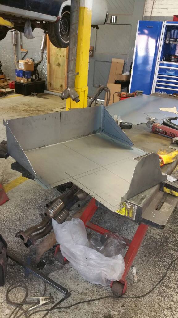

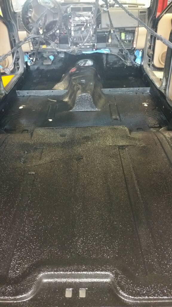

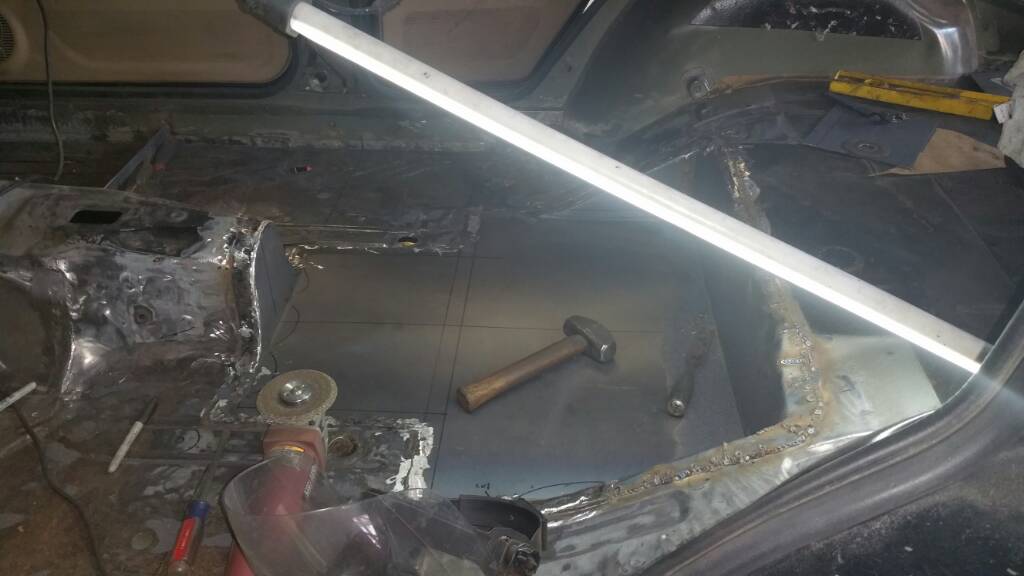

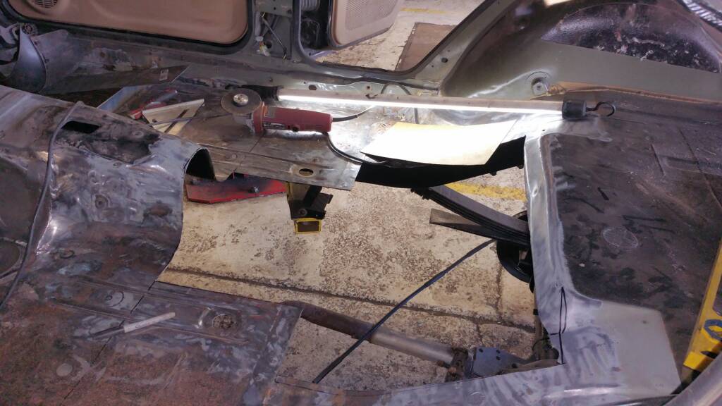

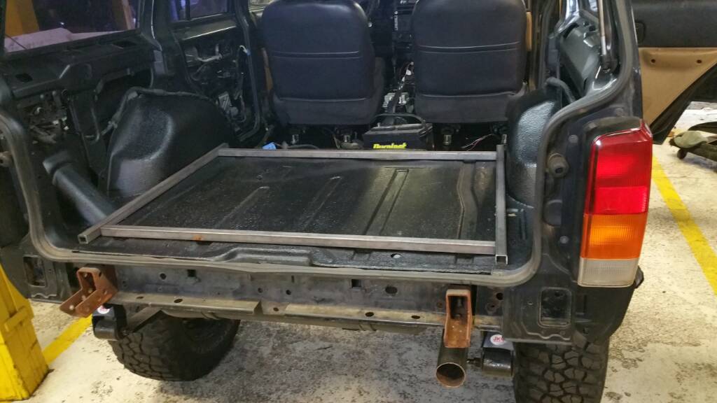

Um.... What happened to the trans tunnel?
Re: Expedition XJ Build, Tech & Sources Thread
:cool:
Noticed that, did ya. Heehee. Since its rarely anyone but me in the jeep, occasionally hh6 too, I knew I won't ever need the back seat. I also wanted to create some additional storage and made some modifications to the floor. With the t-case dropped I saw the tail of the transmission hump as unnecessary. I did a little work to try and maximize storage while creating more flat space. It looks a little odd right now but once I'm done building the drawer system/fridge mount/etc it should all come together.

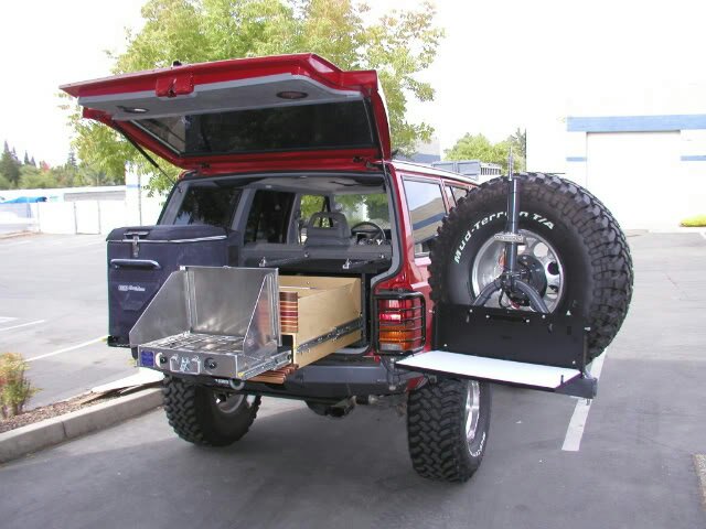

At the end I'm hoping it will something sorta like this.

Looks like clean work. Might want to check your drive shaft with the rear end at full bump. I know that kind of mod would work on my rig. Cool idea though and well executed. Through up some pics when the drawers are done.
Nice work. It would be a good place for a second battery and a water tank.
btw the red jeep is mine, if you need more info or pics pm me. Don

Thanks a bunch. It was my first time playing with metal thinner than 3/16s. Sheet metal work is more challenging. :)
I feel pretty confident I'm good at compression. I do plan on getting new rear springs and adding some airbags for load. This is a little different from my jeeps I've built to crawl. It's less extreme and more designed for extended camping vs. Harder trails.

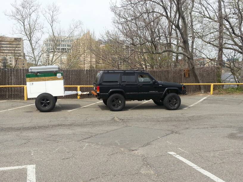

That's yours!?! *drool* very nice sir! Is there a build thread on yours? I am mostly feeling my way through the design and using a lot of creative head scratching and over thinking. I made some pretty good progress today on the basic layout. The drawers are fairly thought out at this point. Tomorrow will show how/if it will actually work. I am torn on what to actually do with the new space where the rear seat/footwells were. I'd love to add a second (or third!) Battery and water would be great. I may save the extras (water and fuel tanks as well as a 3rd battery) for my lil trailer build.
