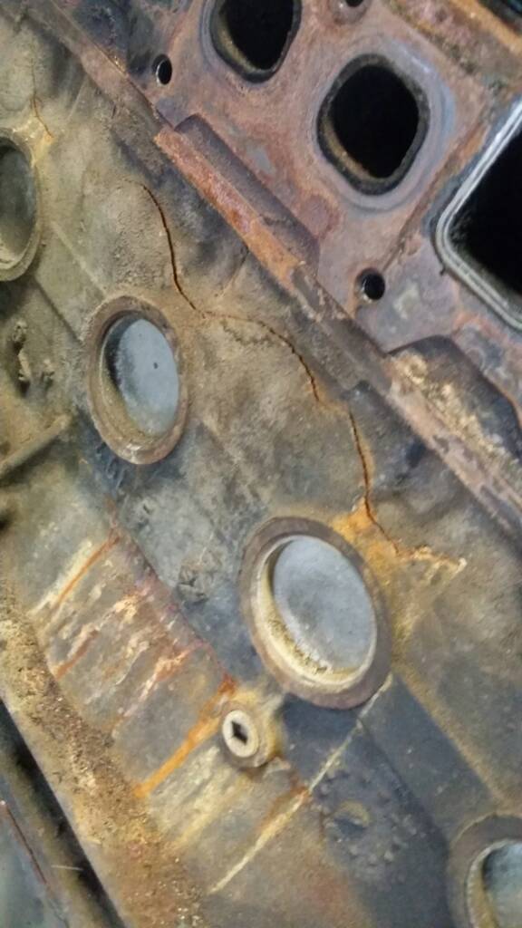

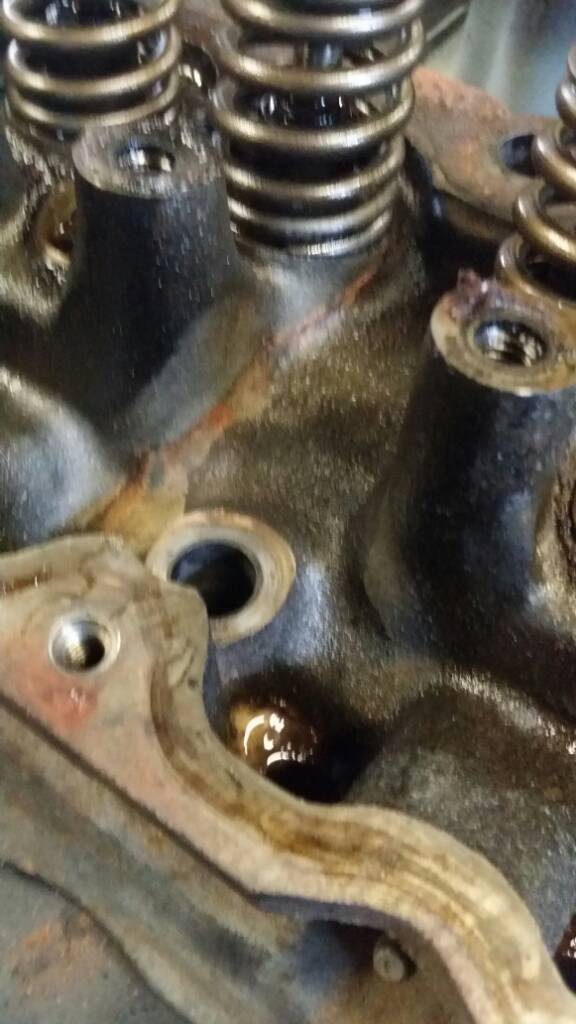

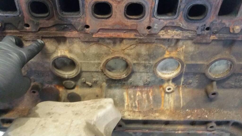

Good call on the new exhaust. My factory rear (3rd?) Cat weighed a ton.
As for the 0331... good luck. There is no rhythm or reason behind their failure. Mine went out of the blue at around 160-1650k. Sitting in traffic (fall time so cool) and one second it was fine, the next I had a massive temp spike.
I knew what it was as soon as it happened, drove it anyway while carefully keeping the coolant full but it was a done deal. Had I put it on the wrecker immediately I probably could have saved the bottom end but I didn't. Drove it maybe 2 months back and forth to work before calling it done. Sadly it idled just fine and drove normal until it ran out of coolant, that way right into the shop for its transplant. More scary was the resulting block cracks that you'd never see without pulling the intake and exhaust.
