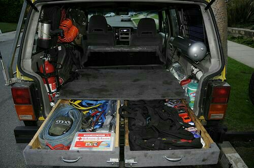

I may make a sliding drawer box rack system that breaks where the rear seat would, then attach a flip up addition from that point on where the rear seat used to be.
Maybe make some kind of rail/rack setup to run across the cargo area to separate upper and lower containers. That way you would have easier access to them.
That is definitely an alternative.
While I like it, my only issue would be more things to take out if I want to use the cargo area for sleeping or what not. I am trying to maximize space use while also attempting to simplifying the complete packing/unpacking process and time spent. It's a balancing act in regards to storage capacity vs efficiency, while remaining easily removable.

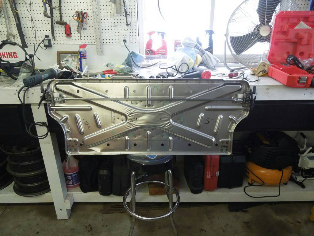

FWIW, here is what that seat back looks like stripped of its foam and cover. Shouldn't be hard to make it do what you want.

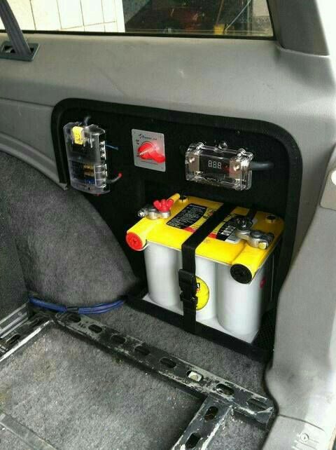

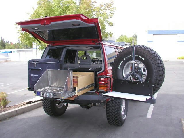

And here are a couple of my favorite ideas...
If you need more ideas try googling xj cargo mods or visit the expedition portal, storage solutions section, sticky, "post up your drawer slides".
