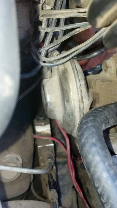

Chasing some smog issues led me to check my EGR on my 87xj.
If I manually press the EGR diaphragm at idle, the jeep will die. that's normal I believe.
If I manually put vacuum to the egr, diaphragm will not move/ not kill the jeep. Not normal I believe.
I can not get the jeep to SEND vaccum to the egr. I have tried rapidly opening and closing the throttle. No vacuum comes out of the black doohickey near the airbox (although vacuum is going into it). How can I check/fix that?
Sounds like you have two potential issues:
1) EGR Diaphragm failure. This is why you can't pull the EGR open by applying vacuum.
2) Potential EGR line/solenoid failure. Check the line from the EGR solenoid by blowing through it, air should move freely (it is a 1/8" ID, so bear that in mind.) It may be blown out with a bit of carburettor cleaner if you suspect a collection of oil in the line. Also, a bit of 18AWG or 16AWG copper wire, solid, stripped, and the end filed or sanded round, may be gently pushed through the line to clear it out.
The solenoid may be tested by pulling a vacuum on the engine side of it and applying 12VDC to the solenoid terminals, and checking vacuum at the EGR valve line. (The solenoid is that black dingus next to the airbox.)
At least you know you don't have to clean the EGR passages, but I'd recommend doing so while you've got the thing off to replace it. A small, flat screwdriver and a Shop-Vac will work neatly, it's what I usually use.
The screws are a Torx head, about a T35 or T40, I believe. The threads are 5/16"-18, so you can replace them - but I still recommend a socket head, since you don't have a lot of space there for an external wrench.

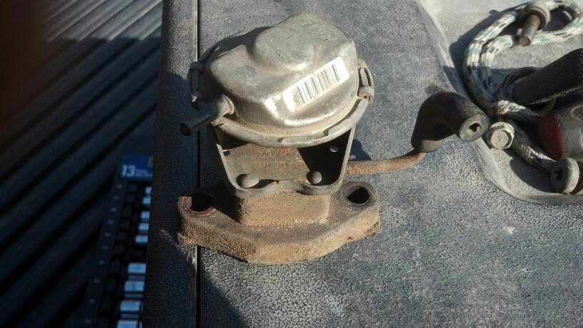

I think I'm calling the parts by the wrong name. I was calling ether black dookickey by the airbox the transducer. By reading your post, that is the solenoid. When i unplug the electrical, it sends vacuum to the egr. I think that rules it out. The actual egr piece on the manifold does not function when vacuum is applied, although i can manually press it and kill the engine. Is this piece interchangeable with one from an 88? They look pretty close.
It's been a long time since I dealt with an 87 EGR, but it's important to note that there are two designs of EGR possible. The first is a two part EGR with a separate transducer, and a simple vacuum diaphragm valve. This is what you will always find in an 88, I think. You can test the EGR portion with vacuum, and if it does not operate, it's bad.
However, the original one-piece EGR found on the 87 will NOT ever operate on vacuum alone, because it has a back-pressure valve built in (which the later transducer takes over). It will always leak vacuum, and if you test it with vacuum you may end up throwing a good one away.
It sounds as if you have the 2 part valve, and this one indeed can be vacuum tested, but I throw the above in just in case someone consults this subject later.

this is Mine from my 87. And below is the one from my 88. It does have another port...

I don't see, however, that it covers the rather unique system of the old style XJ EGR. I have actually cut one open, and inside you will find that there is a metal plate that covers a hole in the diaphragm. A certain level of exhaust back pressure must be reached before that plate closes the hole. If you do not have the right combination of back pressure and vacuum from the solenoid, it is designed to leak.
I never found a reliable way to test one sitting still, and I suspect the only way to be sure it's working is by testing NOX emissions.
The later type, with a separate transducer, is much easier to test, since its diaphragm is normal. By the way, I did run into one instance where this type wore slightly off center, and hung open. You can reach in and tickle the diaphragm and make it snap shut.
