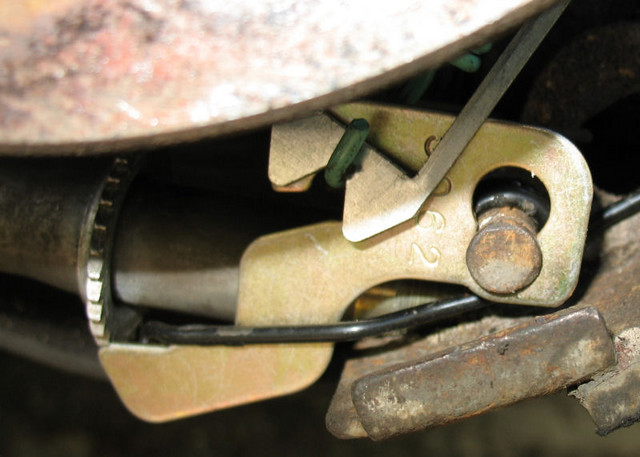

You may also want to look very closely at the adjuster cable pivots. They pop out of the hole often when installing the spring. They should be laying flat with no gap at all.
This is what it should look like
The black spring holds the pawl down. The adjuster wire loops over the ear on top and then clips to the top of the pawl. When the adjuster wire lifts up, the front of the pawl pushes up on the adjuster wheel, then skips back down into position (ratcheting action). It should do it everytime you back up and brake. If you never back up and brake in your daily routine, it will never automatically adjust.

The only way to get a ratcheting noise from the brakes is to turn the star wheel with the adjusting lever resting against it, and to do that, requires a brake spoon. Look at the pic posted above....if the adjusting lever is raised by either braking in reverse or by using the hand brake, it will move the star wheel 2 or 3 teeth at best, in 1 smooth motion, so no ratcheting occurs.
