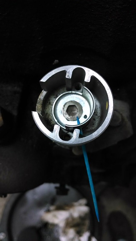

I am familiar with the method of setting the engine at TDC compression stroke and then the toothpick method of lining up the holes in the distributor like so:

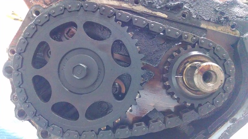

the problem with mine is that the timing marks are not pointing at each other after the above pic, the Crank is right but the cam is 180 degrees off like so:
