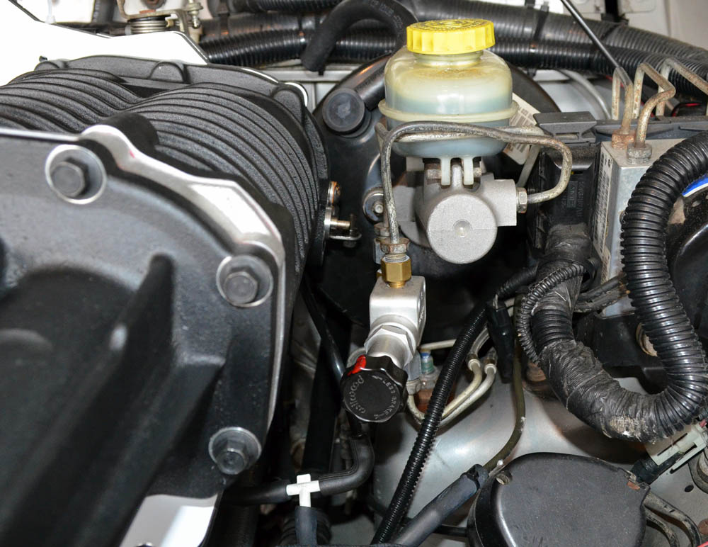

I put a manual prop valve in mine. I went with a Wilwood prop valve, 260-10922 with 3/8-24 flare fittings. I used the following adapters from Royal Brass (mine has ABS so it may be a bit different).
Brake prop valve adapters:
2x BQ260 - 1/2-20 female thread w/ 3/16" tube to 3/8-24 male thread
1x 240CB - 7/16-24 female (w/ 3/16" tube) to 3/8-24 (w/ 3/16" tube) male thread
1x 42IFHD-3 - 3/8-24 union (w/ 3/16" tube)
I put a manual prop valve in mine. I went with a Wilwood prop valve, 260-10922 )
Where did you mount it? After the initial adjustment, do you change it often or at all?
Without spending some time looking, I wonder if bringing up through the floor is a good idea.
I like the idea of being able to change it quickly. In dry conditions, rear lock up usually isn't a problem, only when wet.
Where the stock one was.
It took a bit to get dialed in but after that I only change it if I am towing or hauling something. Not pictured is an aluminum bracket that supports it as it was in the way for the test fit.. You don't want it vibrating or bouncing around as that will fatigue the lines.
