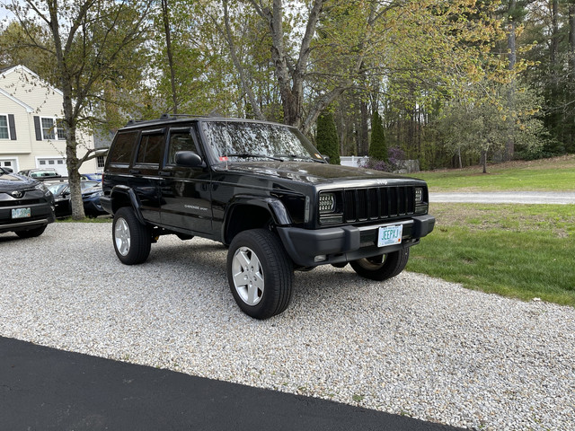

I just lifted my 1999 XJ with an OME 3.5" lift kit, and in the process of doing so, also swapped to an 8.25 rear end from a dana 35. SO, I have an 8.25 driveshaft and a dana 35 driveshaft here to chose from. The Dana 35 driveshaft is slightly longer, and I get more engagement on the slip yoke if I use that one which is obviously better... but will I run the risk of bottoming it out if the rear end compresses to much? I don't want to find out the hard way, if anyone else has some experience using a D35 driveshaft with an 8.25 rear end with about 3.5" of lift. I have factory length upper bumpstops, and a leaf spring plate from DPG with 2 hockey pucks installed on each for now for what it's worth.
Thank you!
Pic for attention.... larger tires are next!
