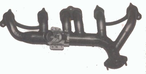

Here is a '91+ factory manifold:
dpstore_1738_66078712
Pre '91:
Notice the longer runners on the 91+ and the 3 into 2 into 1 design rather than all six short tubes into one? Better scavenging and less turbulence with the latter design.
Hope this helped.
