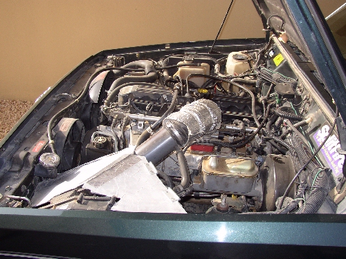

Dyno,
Can I see a pic of your jeep with both those electric fans in place?
I was also thinking of replaceing the stock electric with a newer stock one, and the clutch fan with a Taurus fan.
I have already upgraded my Alternator to a 136Amp from a 1999 Durango.
You can't see much of the fans themselves but here's a side view:
