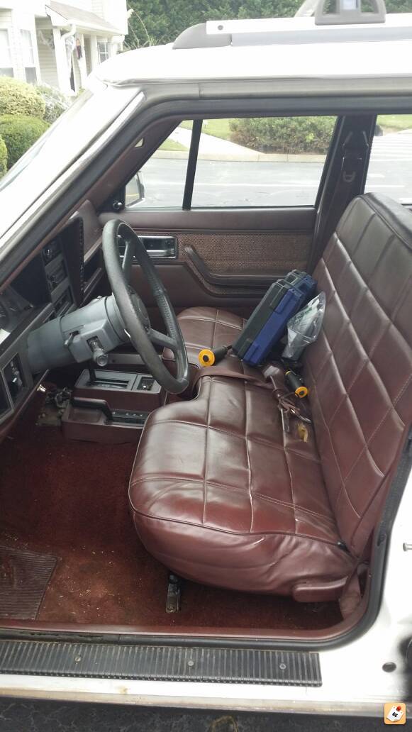

Has anyone done this? I have the brackets off the xj bucket seats.
Any advise would be awesome

Looks like it was already done in the first pic.
Where is your e-brake? Is that console out of the MJ?
Or did you just leave it out?
