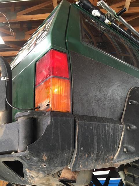

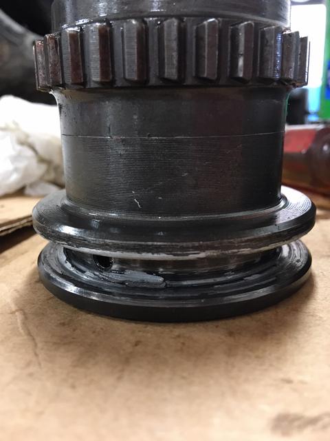

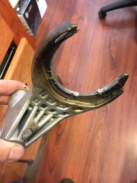

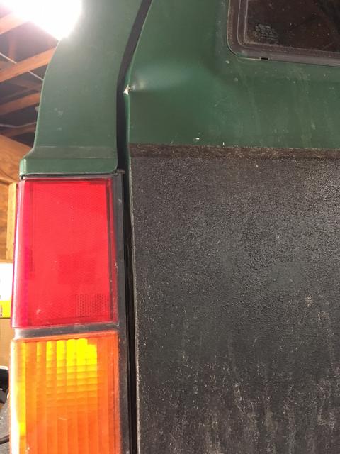

So need to post some pics. Took it to Moab and bent the shit out of the unibody on Cliff Hanger trail. Also blew up the t case. Thanks Blondjon for taking my call when my ass was stranded in Provo UT. Finally got the rig home.
Lots of upgrades and body damage since last post........

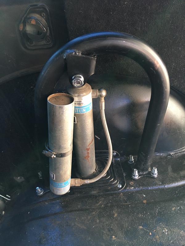

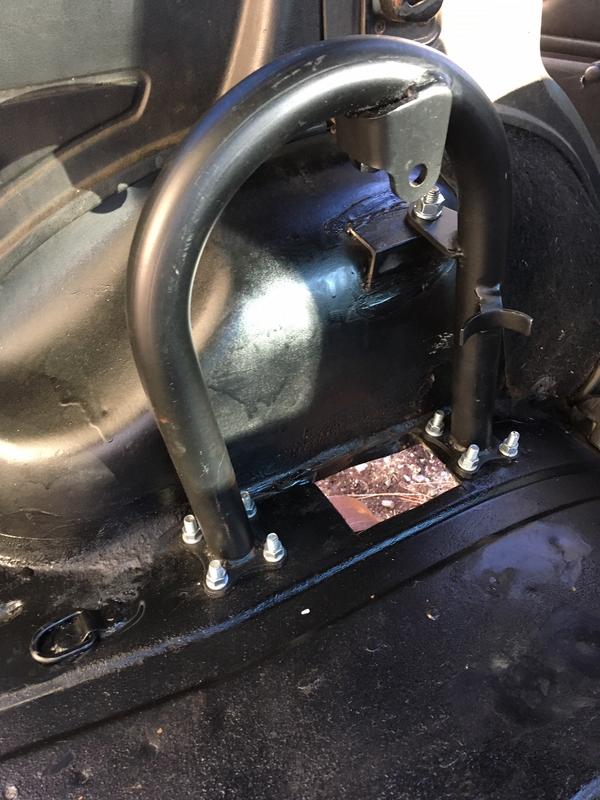

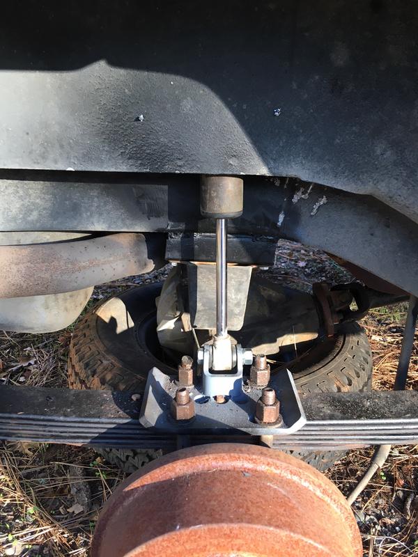

Started with removing my a/c, relocting the battery to the rear and mounting the rear shocks on top of the axle.

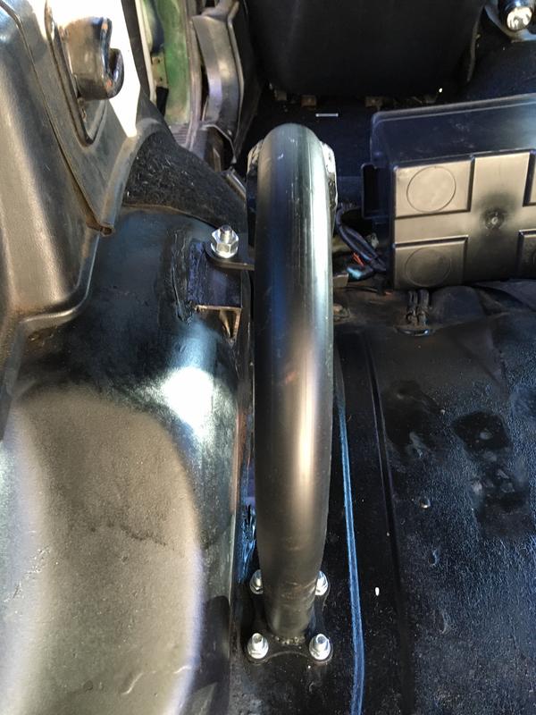

I tied the hoops into the side fenders for lateral support (without adding a cross brace to both mounts):

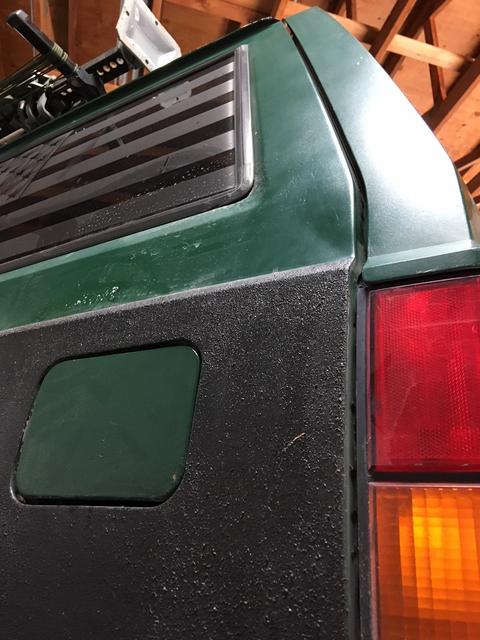

Also straight piped the exhaust (muffler was all beat up from Reno Fest).
