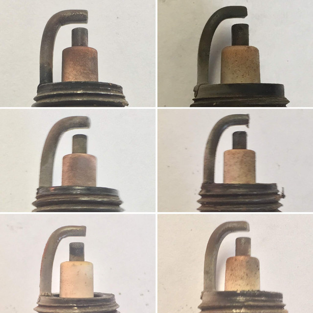

PLUG CHECK
  • Pulled the plugs
  • Overall they seem okay
  • #4 plug had a few particles, i'm assuming from not having a perfect leak (small o-ring)
  • Cleaned them off, checked the .035 gap, and re-installed with 27 ft lbs)
