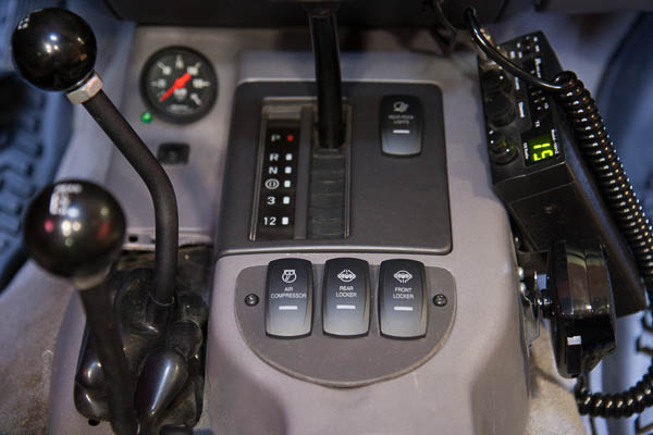

Mounted mine on the passenger side of the center console. Very convenient, and no complaints from the passenger. Mine's a '98 (the Jeep, not the passenger).
Edit: found a picture.

Caligolds picture pretty much nails my mounting - just used some self tappers through the headliner into the roof (there's 2 separate layers of metal up there, so it's not like you're gonna poke through the roof) to mount the CB bracket. I didn't use an additional piece of aluminum (or whatever) mounted via the 2 visor screws as I didn't see the need. You will undo those screws to have space to run wiring, but that's all.

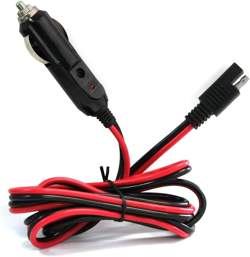

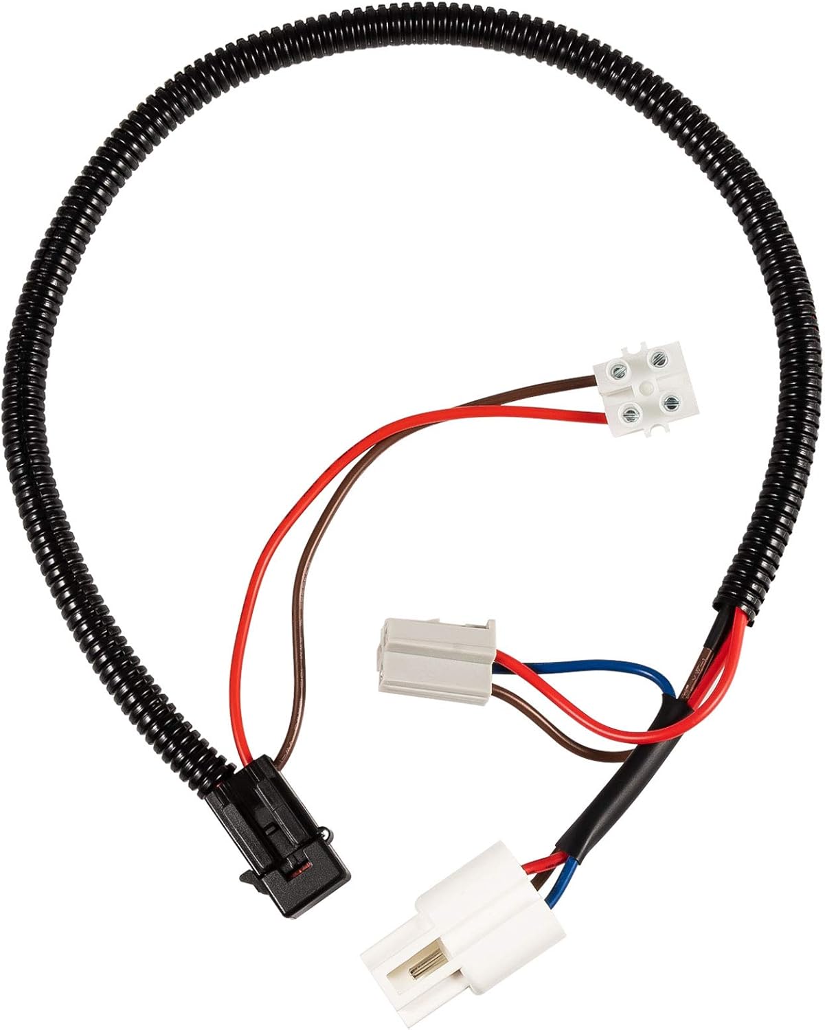

Installed a CB this past week. Selected a base Uniden model, small and inexpensive. Didn't want to drill and cut into trim, and wanted to be able to remove the radio and its wiring.
Tricky, but found out the connectors for the cig lighter/power outlet haven't changed, so the Wrangler JK adapter with a bridge/bypass connects perfectly, and leaves a pair of +/- wires with a fuse, to connect the radio.
Added a SAE connector to that, so I could unplug the radio. Makes it easy to connect to a standard cig lighter adapter with an SAE connector, too.
