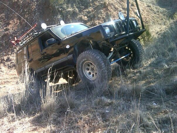

I had mine mounted on the roof rack. 108" stainless whip. The drive through people gave me dirty looks, but otherwise it worked good. Car washes were a no go but the rhino-nosed front bumper did away with that too.

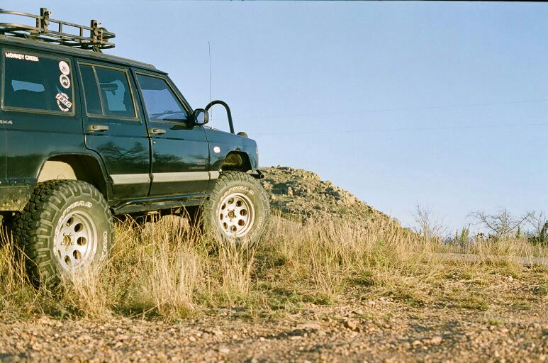

I have my antenna mounted on my driver-side fender.
What kind of antenna end do you have on there? I just switched away from the FireRing antenna because I had some problems with the end and it was just easier to buy a new antenna at the local CB shop, but now the new end I put on my Firestick is too close to the fender to screw it onto the cable.
I'm sorry, I don't understand what you mean by "antenna end". I have no clue what kinda antenna I have (it came off of my father-in-law's old 26' box truck). The wiring and mount I got from a local CB shop when I was living in NC. The spring came off of my dad's CJ-7 (he had a SS whip).
