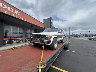

My apologies for the lack of knowledge, hoping to get some insight. I'm not an electrical guru by ANY means..
Snagged an 88 Waggy XJ with an aftermarket Sony XR-6180 cassette/radio and I refuse to upgrade (just want to keep the cassette feature honestly) but no matter what, radio or popping a tape in, it's all static. I haven't done much digging or tinkering because I don't want to make anything worse, but is this a ground issue or should I take the unit apart and clean it (surely it can't be too hard right?) or if it's toast I'll be on the hunt for more of an oem unit I suppose. Any and all help appreciated!
