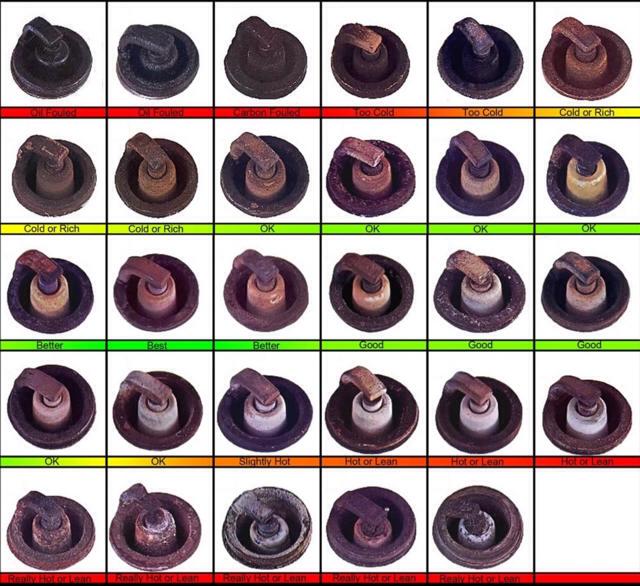

I bet you spark plugs look like crap
check those. its one of those

I did pull the plugs to check them and they are Bosch Platinum that looked a bit carbonized at the base that easily scraped off.
I've never used a Platinum plug before. The center electrode is covered up so I'm not sure how to evaluate how they are running.

spark plugs. check the spark. it should be blue/white. not yellow
