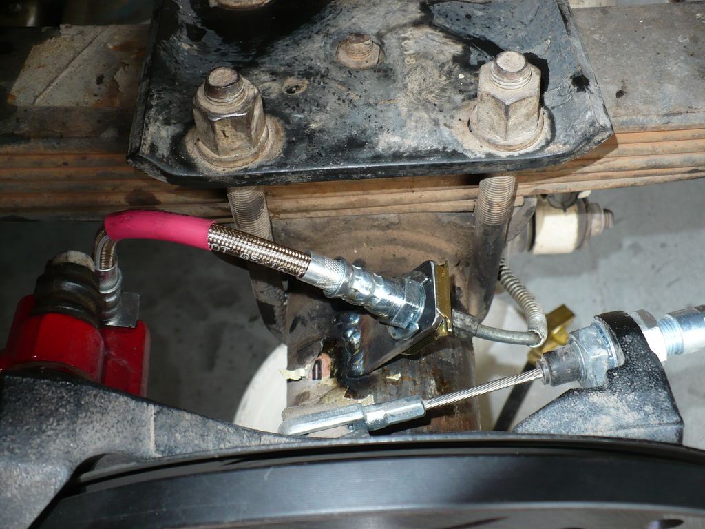

X 1000 on these. I originally used SS hoses for a GC (available from me) but they caused me to remove them because I couldn't pull the calipers off w/o removing the hoses. I ended up having some new custom length hoses made.
New ones by........ http://brake-hose.com/braided-stainless
New ones.....
How long ago was this, their build link is down. Any specs on the size/type line you built? Did you simply bend your stock line to fit your made line and bracket? Any re flaring done?
I just called them with the length I wanted. I also used the original hard lines with minor reforming.
