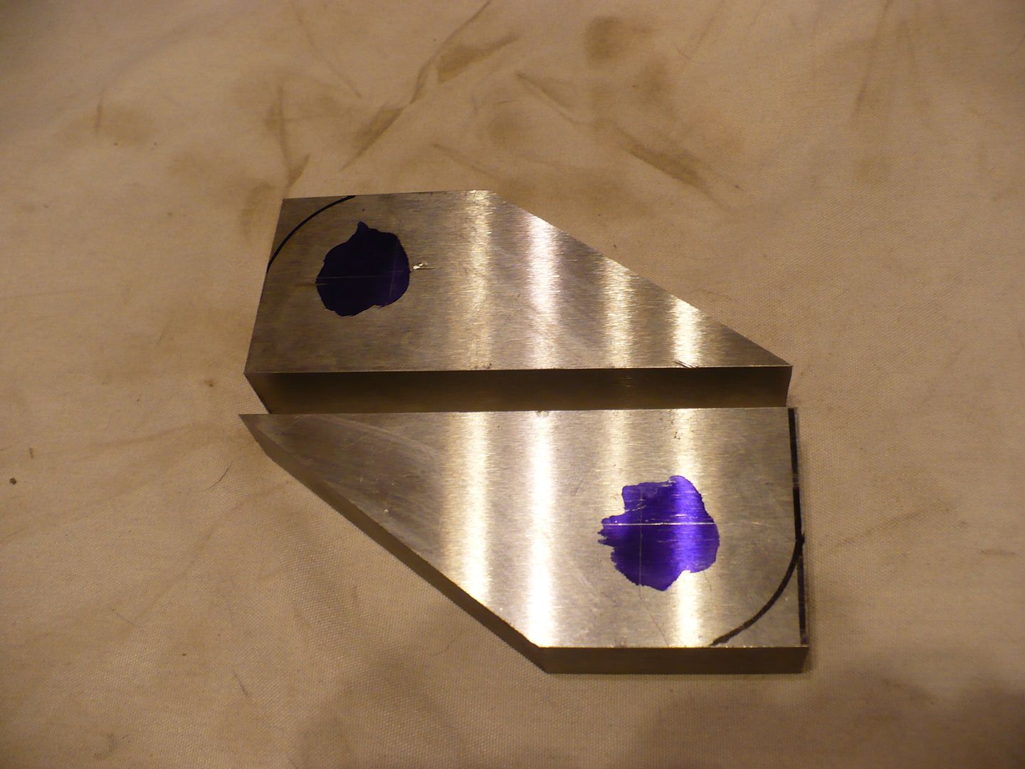

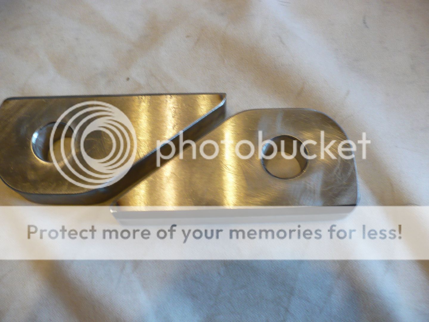

I did cut out the shackle tabs tonight, will drill and grind them tomorrow.
Ohhh damn those are beef.
Trailer is to heavy
The tow rating on a stock XJ is #5000 and on a WJ is #6000, I exceed all those parametetrs.
They may look big in the picture but they are only made from 3/4" x 2" cold rolled/precision ground steel. I finished prepping them up today and will tack them on tomorrow and finish welding them at my son's work (300A machine). You cannot make recovery points to strong!

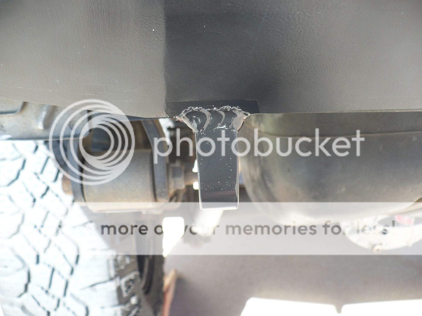

I think your mig machine is somewhere in the 180-200amp. Should be plenty to glue those recovery points on
Not where there is possibly "lives" involved, might even be yours one day.
Surface mounted in shear, that's why they are wide and long and deserve the best weld.

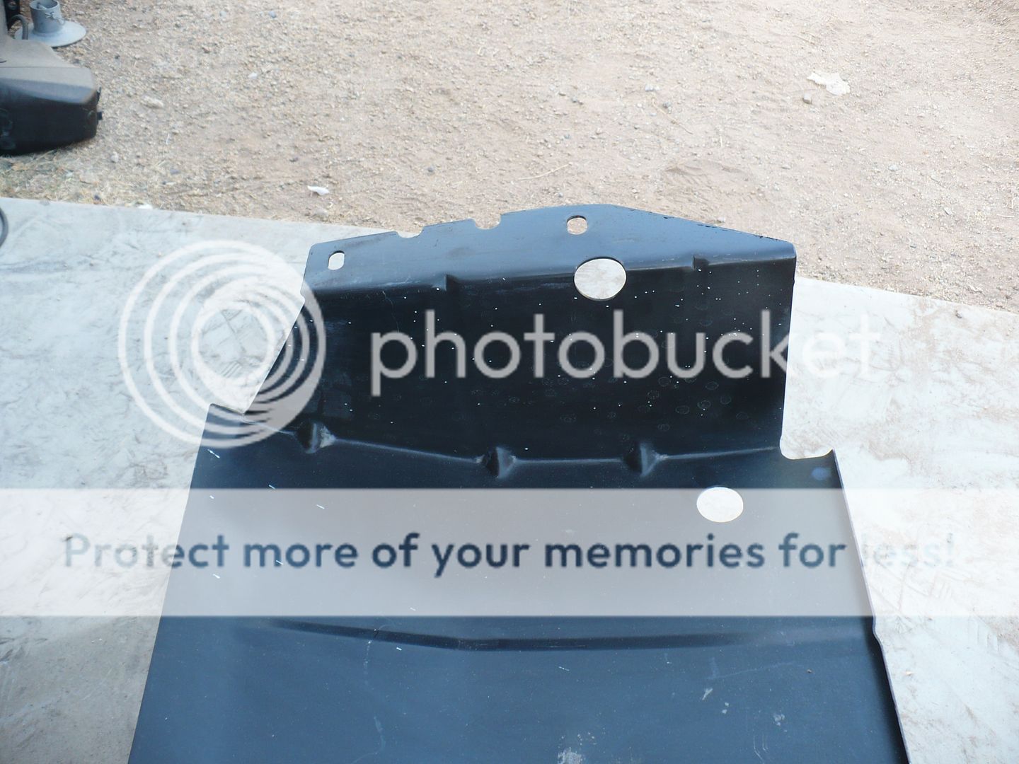

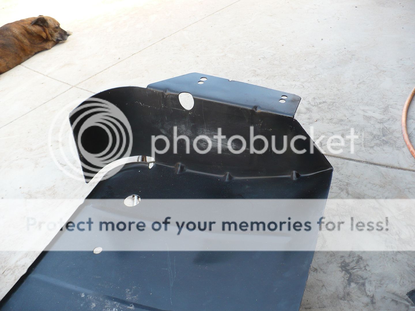

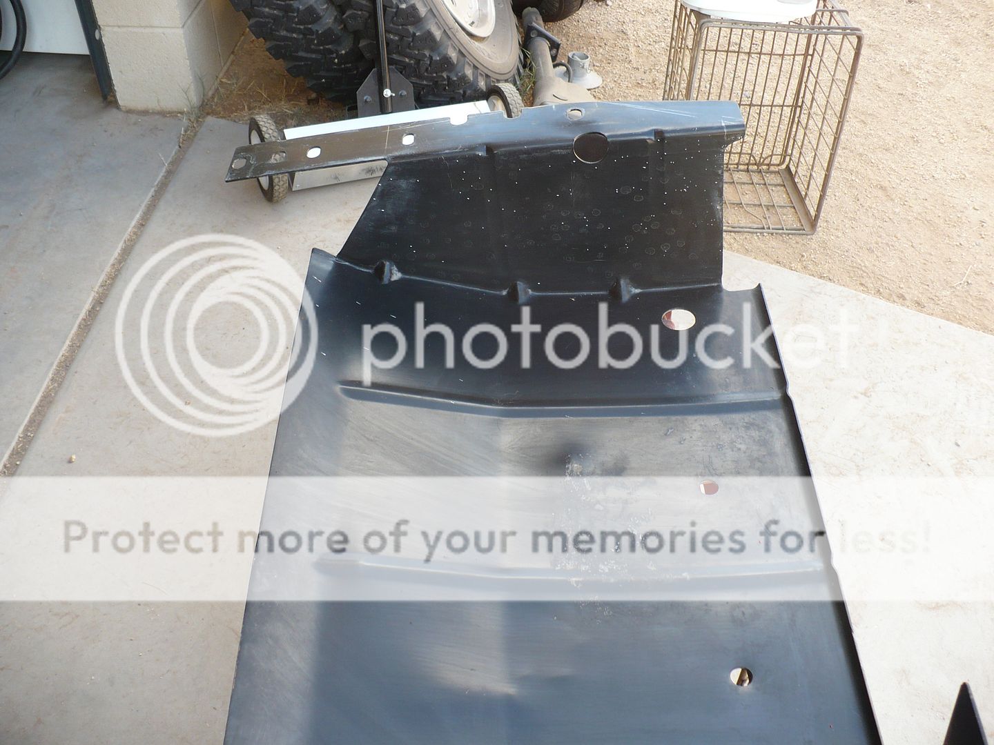

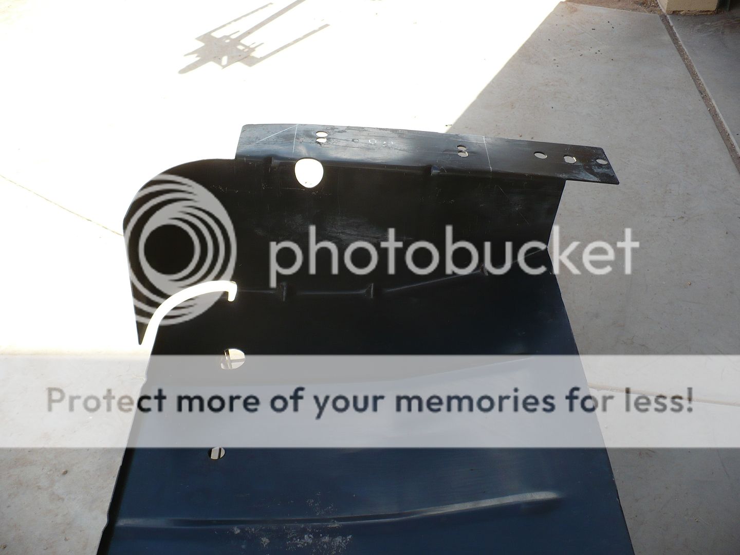

Mark pm'ed me last night on what I was doing with my skid plate(factory). I had it in hand and looked at modding it to fit separate from anything else like my SFR brackets and exhaust hanger. Easy the back 3 holes are just a spacer for a hitch, cut those off and clean the whole thing up.
Before:
After 15 min with the plasma:
Well I've got 3 bitches, all rescue dogs. That one is a pit mix, a staffordshire terrier, and either a min-pin or chihuahua mix!
I spoke and acted to hastily, the skid still uses the most forward bolt on SFR brackets. I will pause a little and take my time on the new fix!

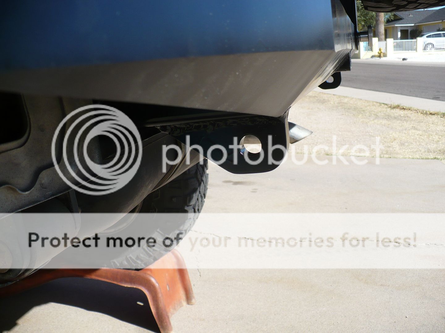

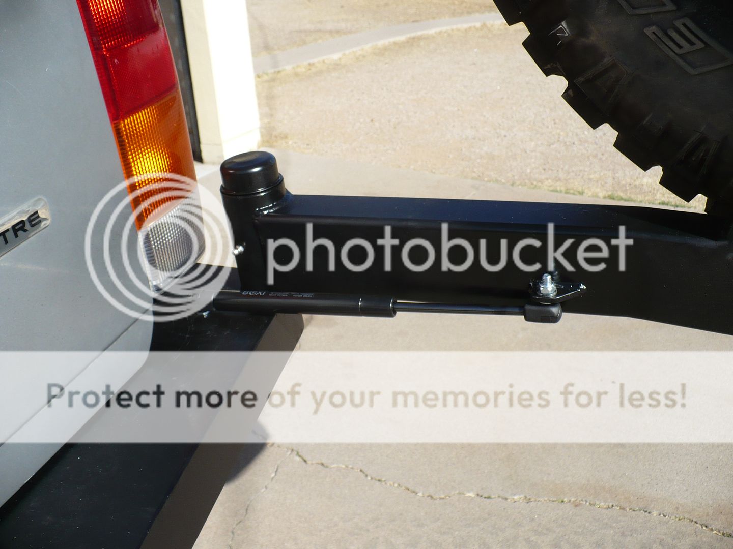

Bumper portion is done. I got the lift strut in and it extends and holds on a angle. I got the shackle mounts welded in to, now I need to relocate my license plate light.
