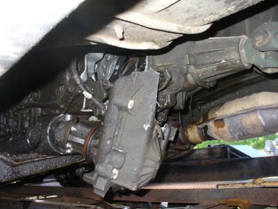

Not much left of the T-case.
This is the part that I see as most challenging to fix. Anybody have input on this?

I don't think the T-case liked having the front driveshaft shift back over a foot. There just isn't that much spline to play with in the front driveshaft.
