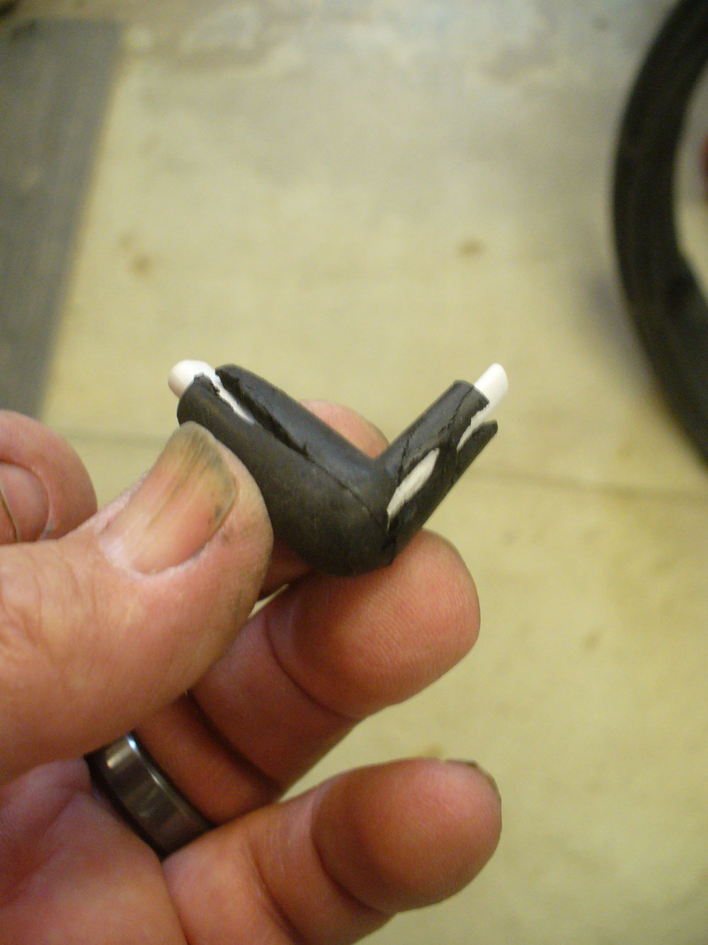

Last fall I went through a bunch of maintenance on my Cummins to get it in shape for another season of towing. Among the things I did was take care of some old vacuum lines and fittings, especially en route between the vacuum pump and the brake booster diaphragm. Well, today I try to pull into a parking spot and discover my brake pedal is hard as can be and I am getting virtually no braking for my effort. Nearly hit another car.
This was the culprit:
That fitting was new last October. That fitting was also a pain to find. I well remember the challenge. The parts clerk at Napa was of no use whatsoever. I wound up settling for a part I could find on a rack at Vatozone. I wasn't settling for that today.

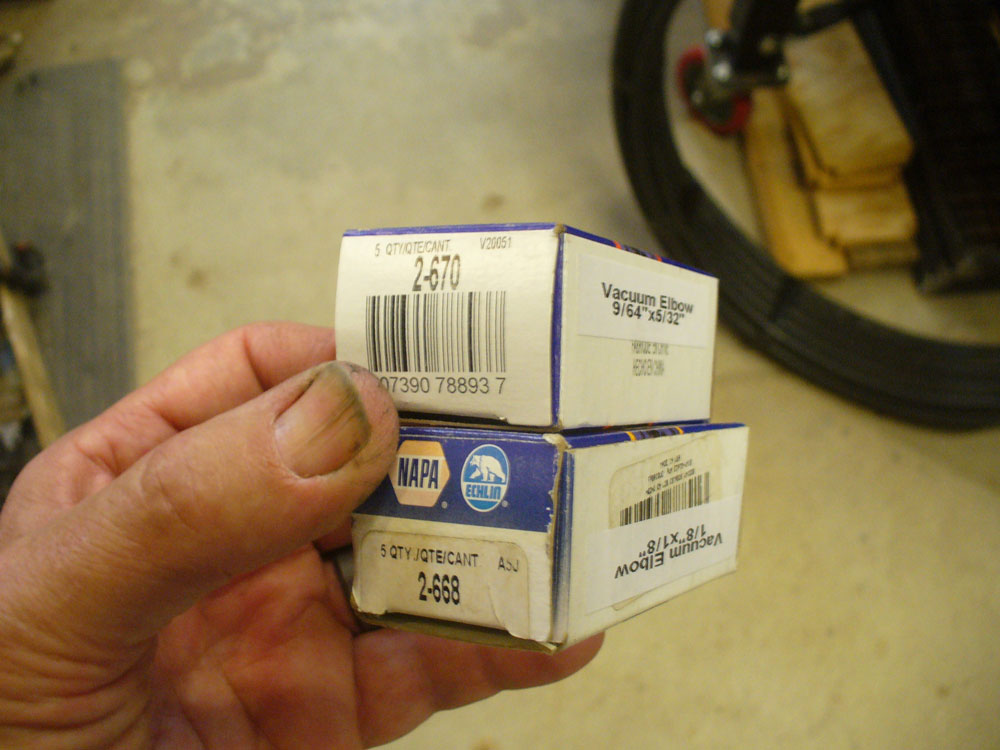

This time I went to Napa with a box of another, comparable, fitting in hopes that would provide a clue. I got lucky and got an old guy who knew what a book was and could actually look for parts (those types are few and far between anymore). He found me what I wanted. Well, at least as good as I could hope for:
The "2-668" fittings are ones I bought for my XJ's vacuum lines 5 years or more ago. Then too I had gotten lucky and found someone who knew how to look up parts. I bought the whole box and saved it knowing a day such as this would come again.

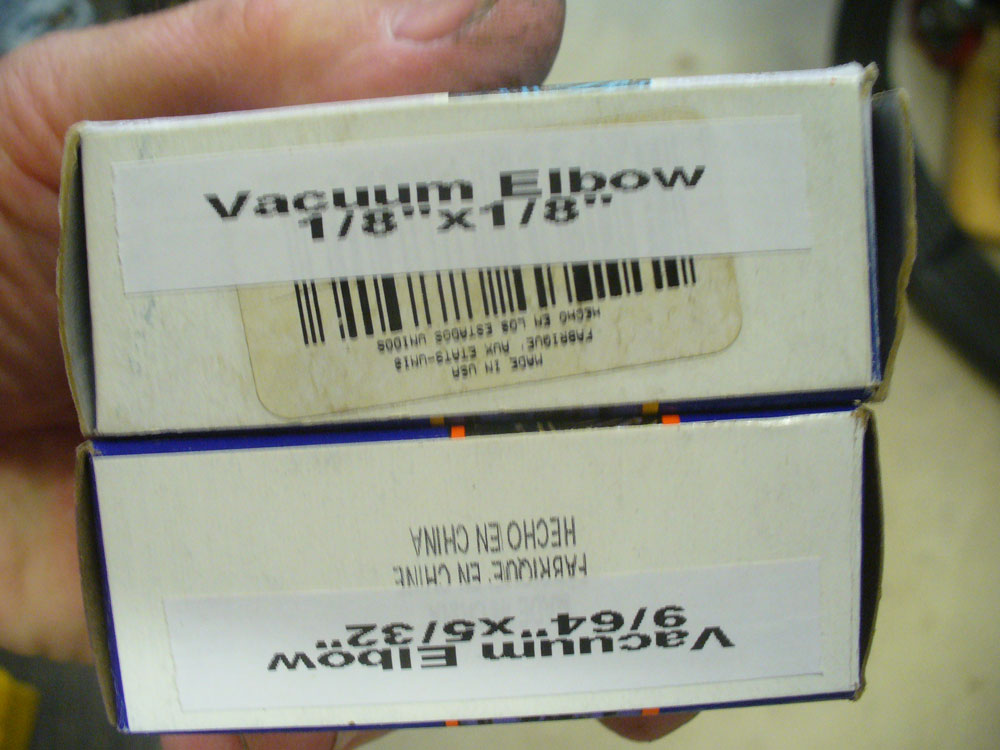

Here is the bummer though:
Country of origin makes a huge difference. The old ones (5+ years old) are still pliable. The new ones from China are hard as can be. I had to use a heat gun in order to get them installed. That does not bode well for the future.
