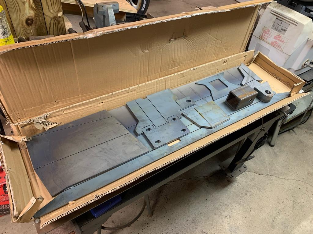

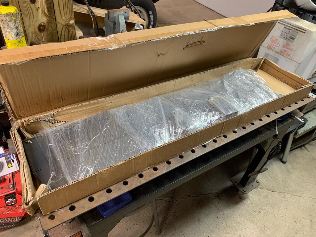

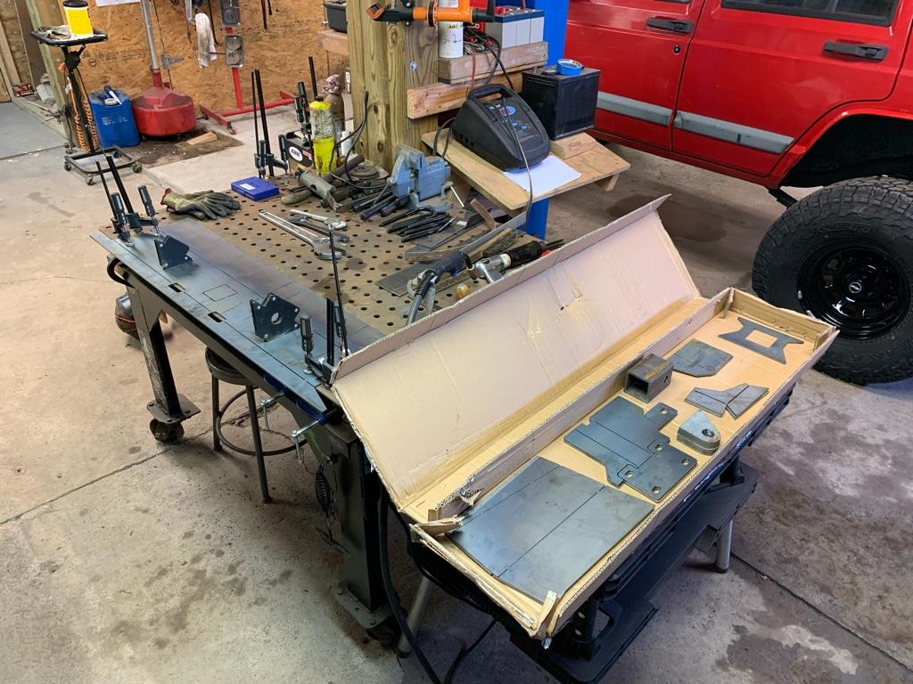

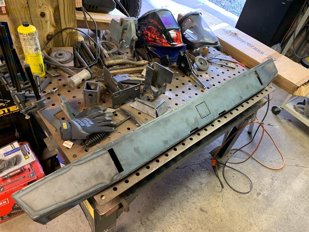

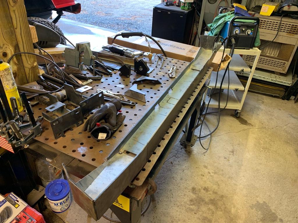

Got my DIY rear bumper today....
Can’t wait to get to welding this thing up!

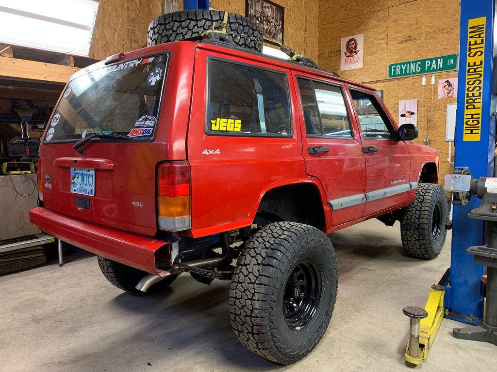

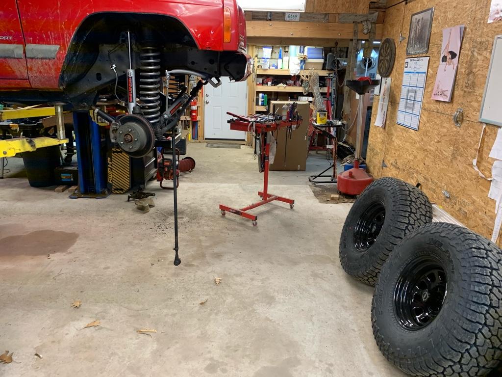

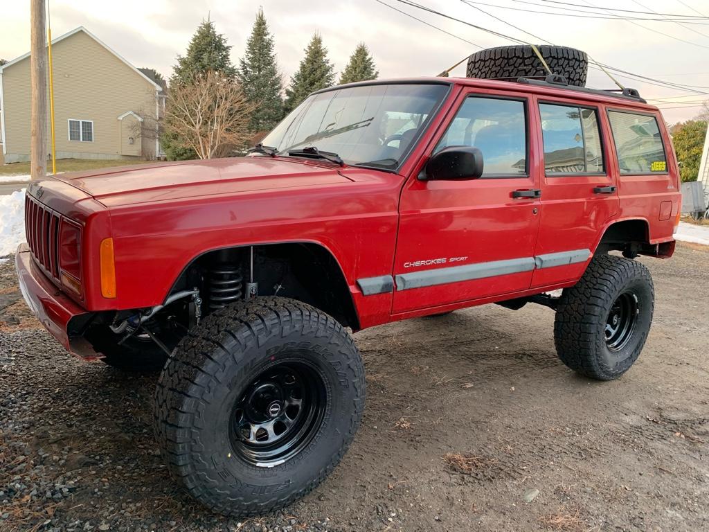

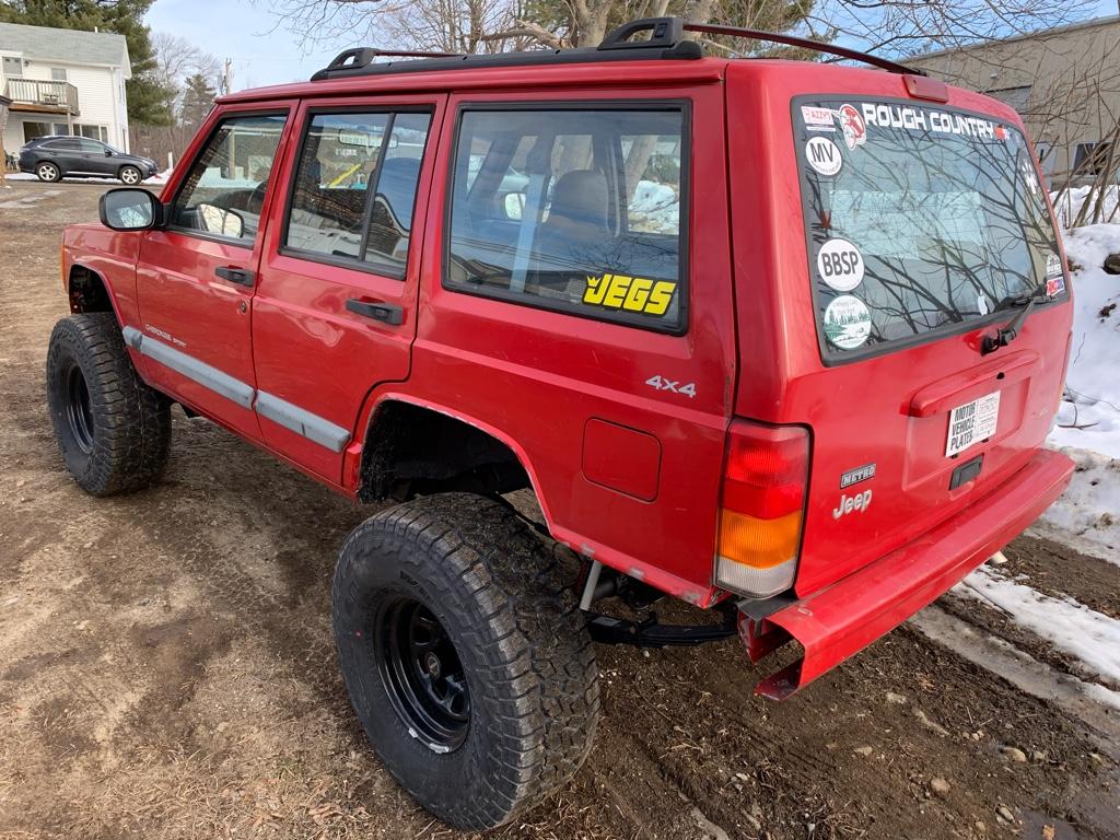

Well, the day came and the new shoes are on. The XJ looks great, love the look and ride!
One thing though, I bought and installed a new driveshaft (complete) for the front. Obviously I’m using the same DS for both front and rear, so I decided to put the new one up front. This turned out to cause a binding problem, and I needed to pull the DS altogether. My question, has anyone with a 4.5” lift had issues using stock front DS for the front of their XJ?

Very happy with how it came out. It is exactly the way I was envisioning the build turning out.

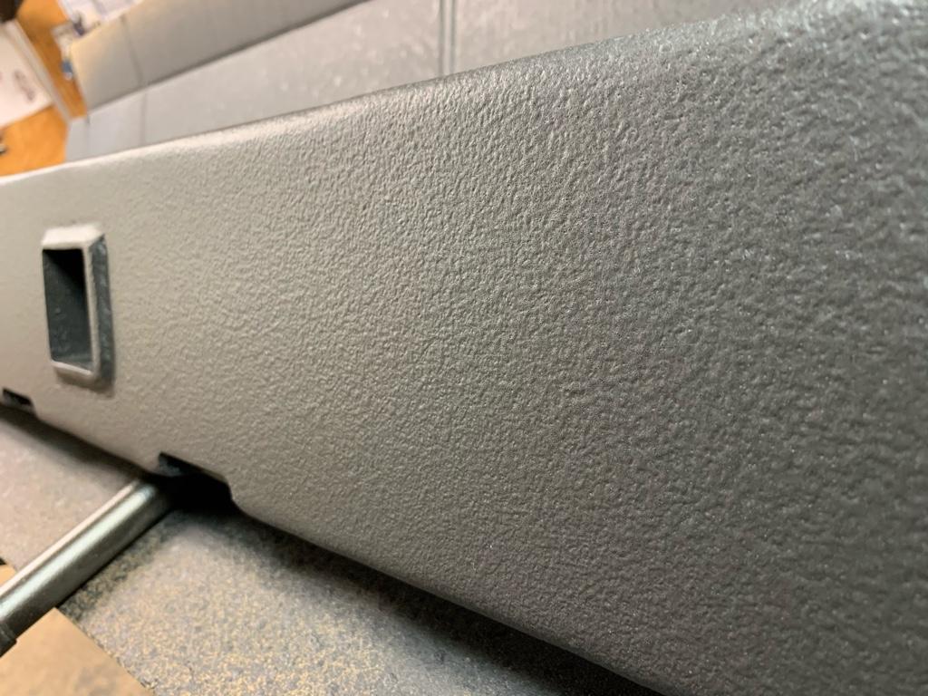

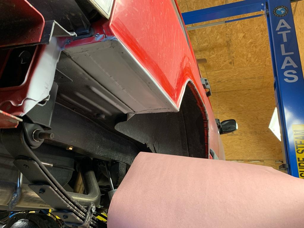

Got the cut & fold painted (underside) with bed liner. I was planning on getting it inspected, but I can’t find the damn horns...lol. I’ll get something in there to get the sticker done.

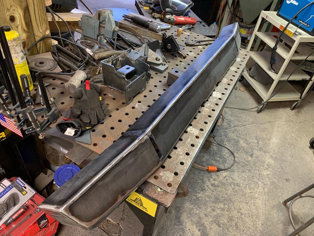

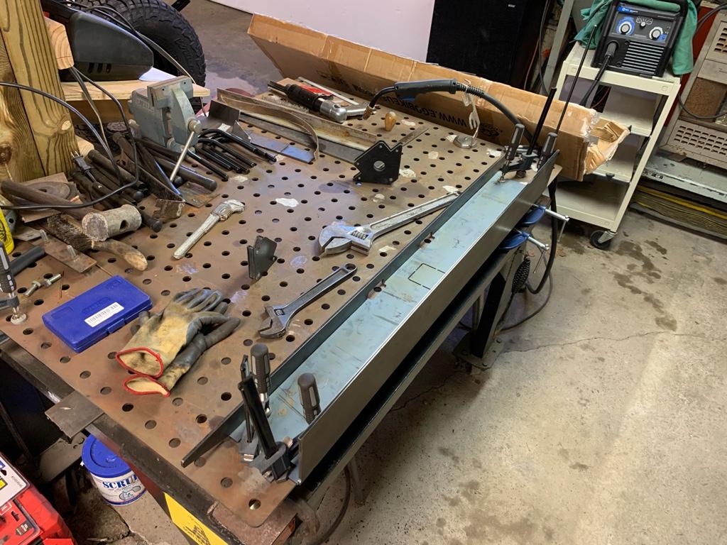

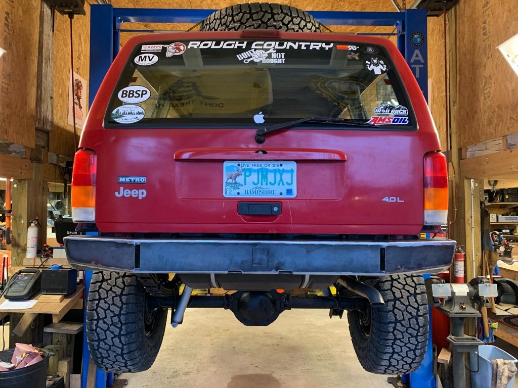

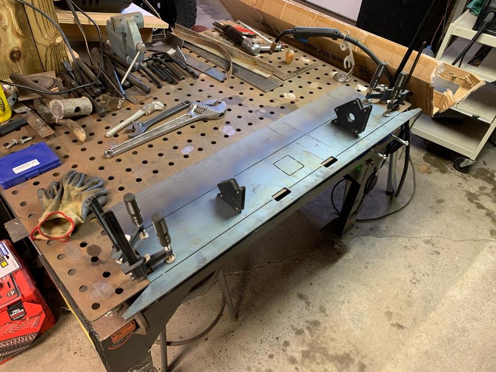

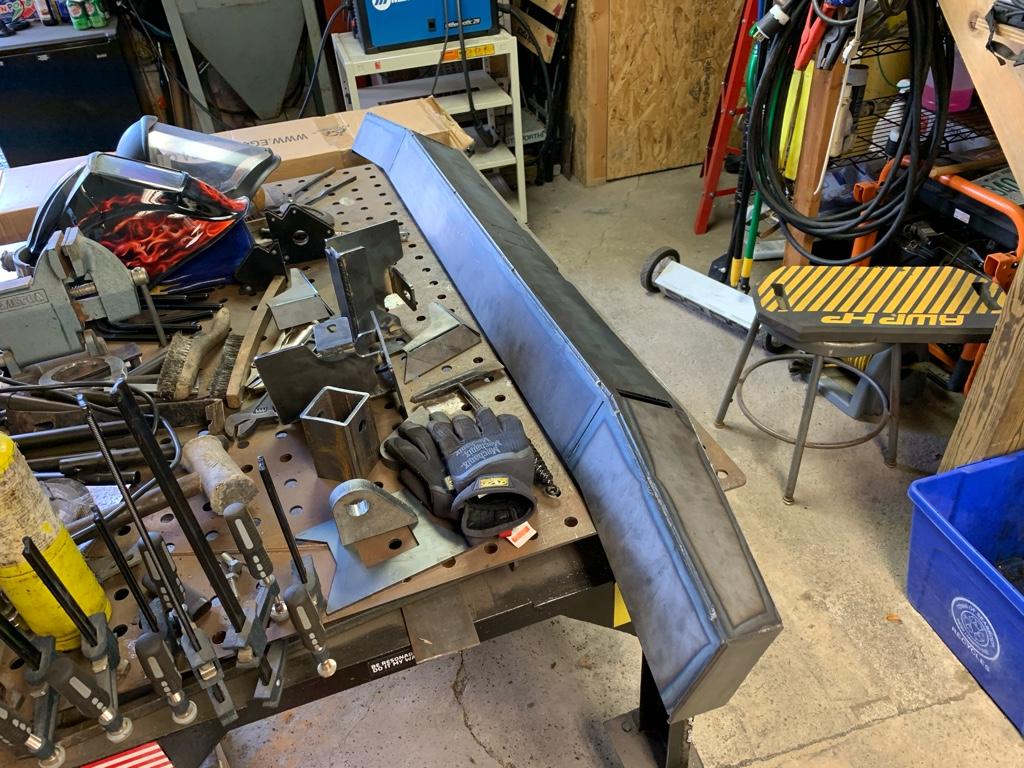

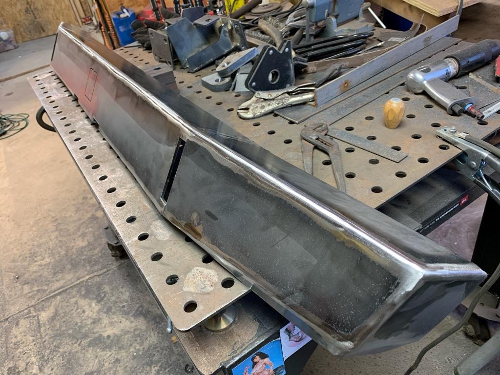

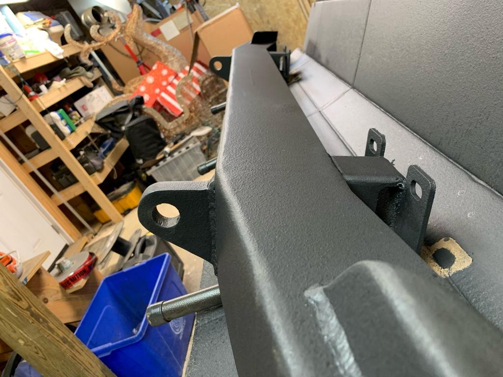

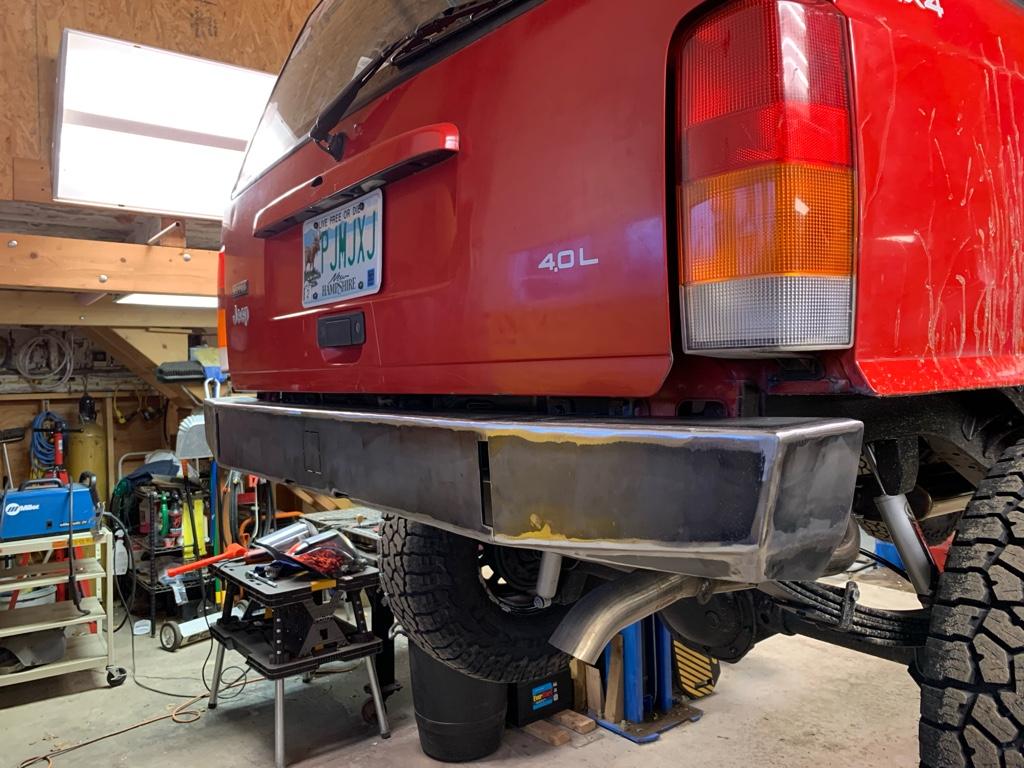

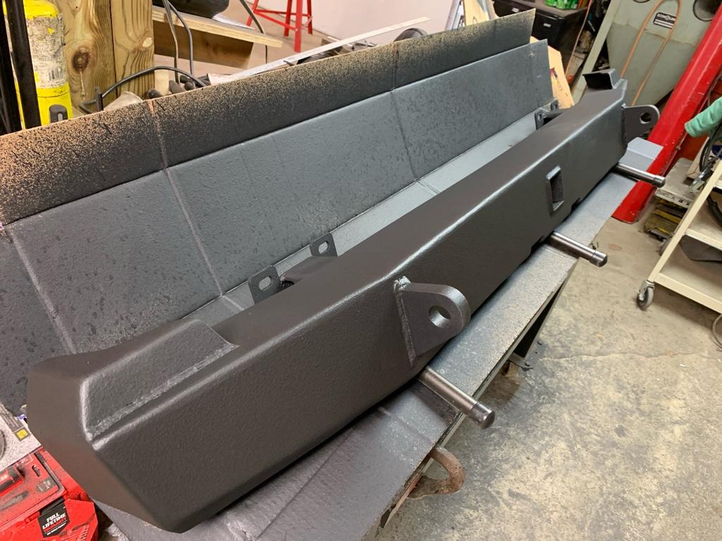

Started on the rear bumper....got it fully welded inside, going to weld up the outside and the mounts/D-rings this week. Would like to get the bumper on those week, then I’m taking a breather on the project...gonna have fun with it for a while before moving onto the next “thing”...whatever that is.

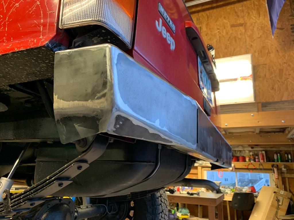

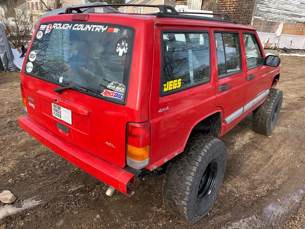

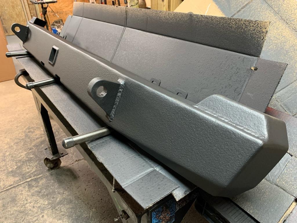

Got some more time into the bumper today....or as we say in New England, Bumpah...
Got the mounting brackets all prepped, D-Ring tabs prepped, have help coming tomorrow to help with fit up.
I should have this ready for paint tomorrow!

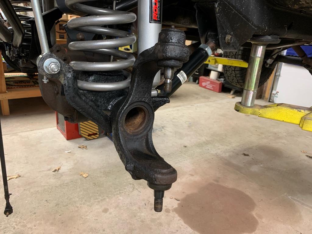

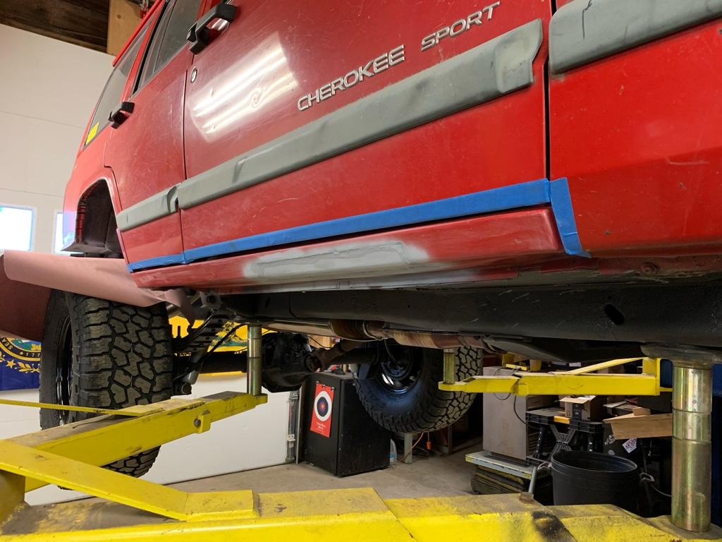

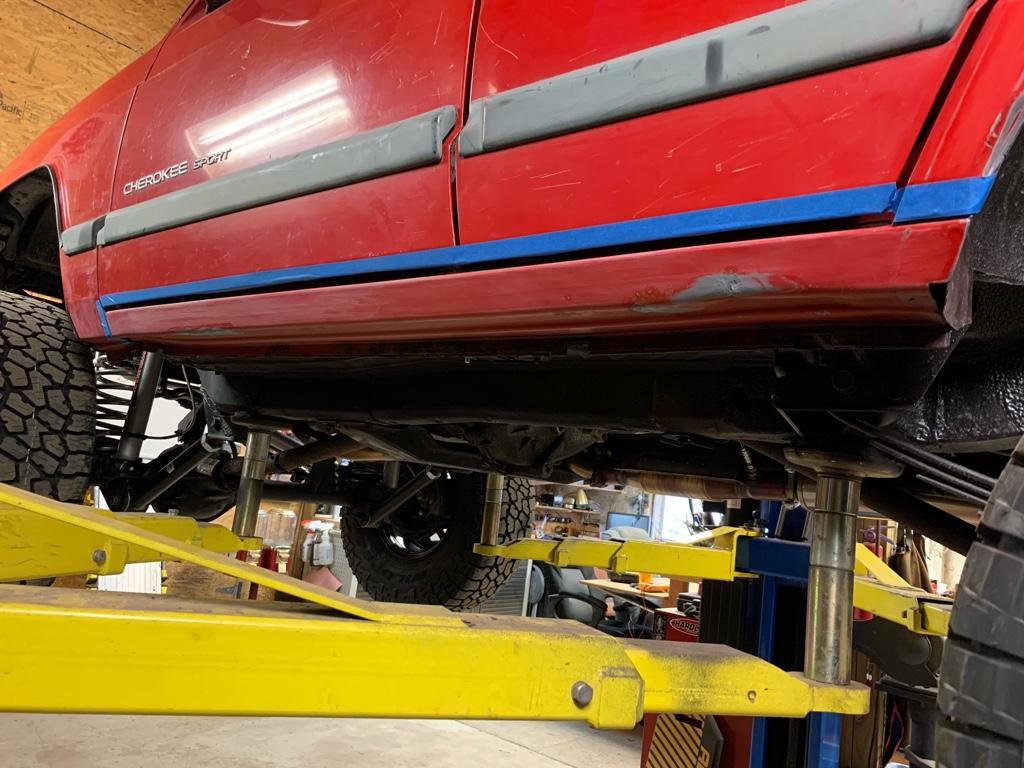

Took the XJ in for a sticker, failed on all 4 ball joints and the need for fender flares.

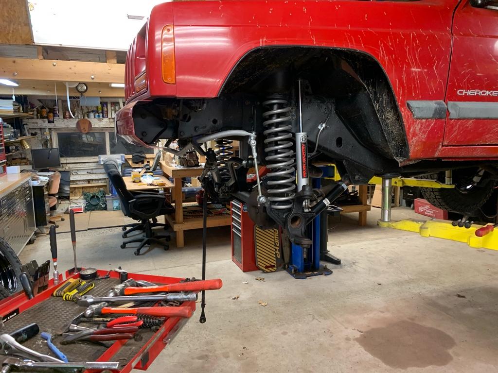

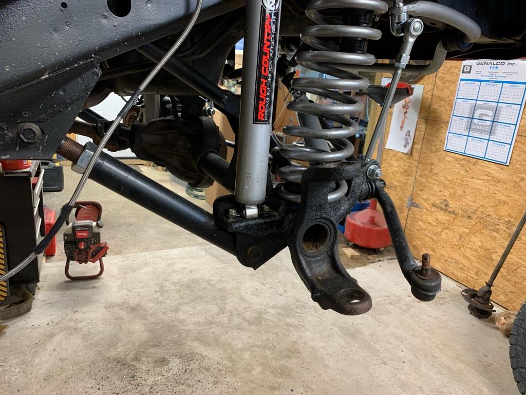

Got to the ball joints tonight....what a ball busting job.

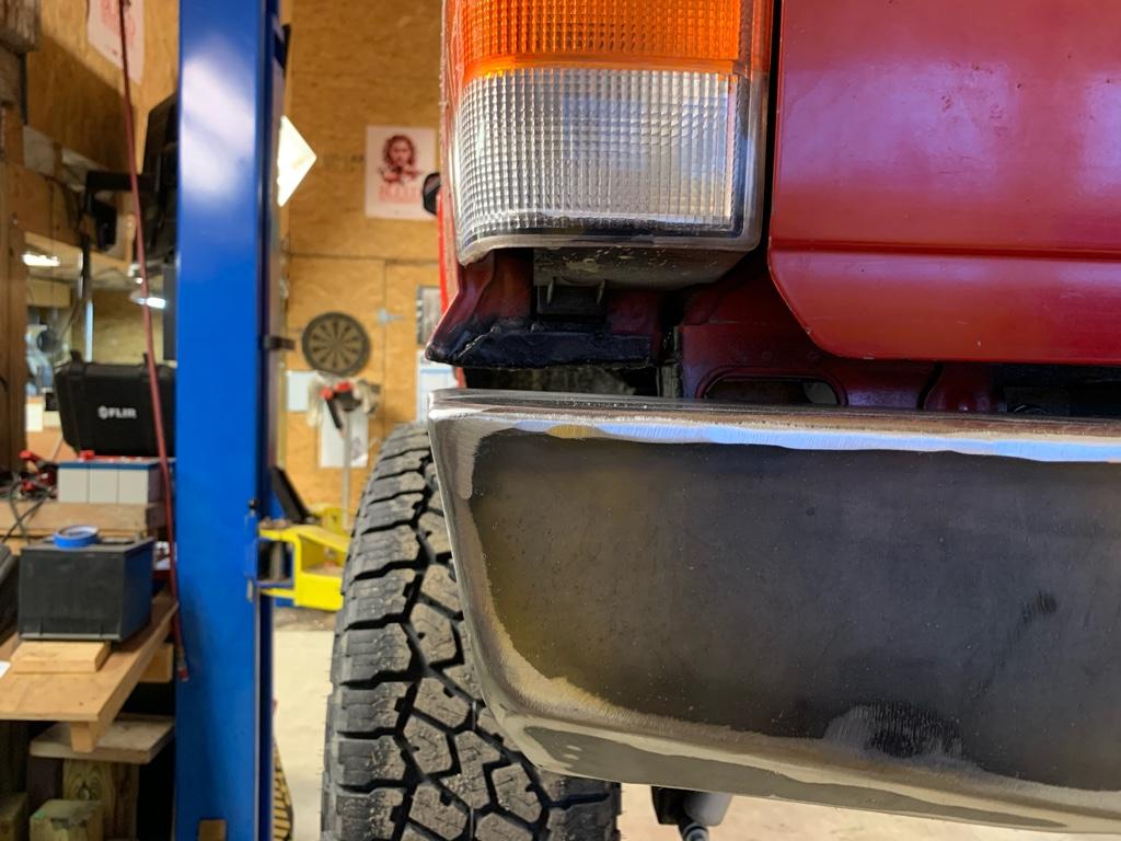

Also got the bumper painted. I’m pretty happy with how it came out.
I messed up the paint a bit here and there, but overall I’m happy with it. Had to keep reminding myself that I’ll probably bang it all up on a tree/rock at some point anyway...lol.
In the end, it was a fun part of the project, but it was way more work than I was anticipating. I’m not sure I’ll do the mate to it on the front, or buy one and bolt it up....we shall see.
I’m kind of burning out on it as far as working on it. I’m ready to drive it/have fun with it some. I may be into building the DIY front bumper after a breather...

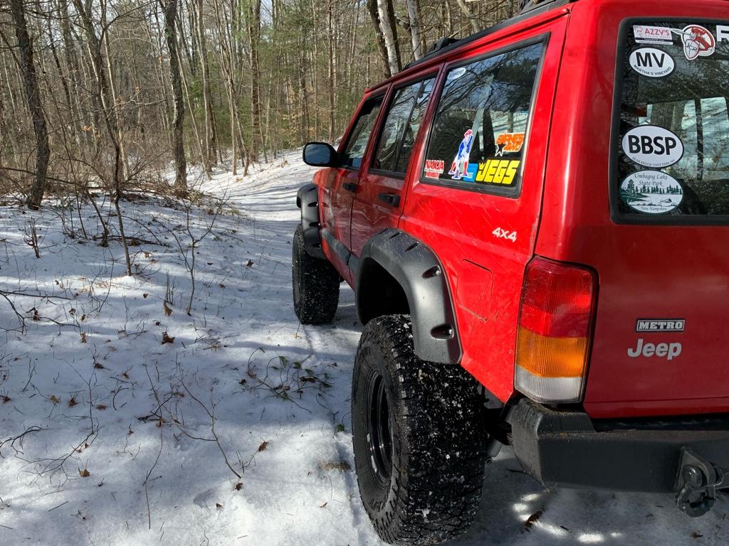

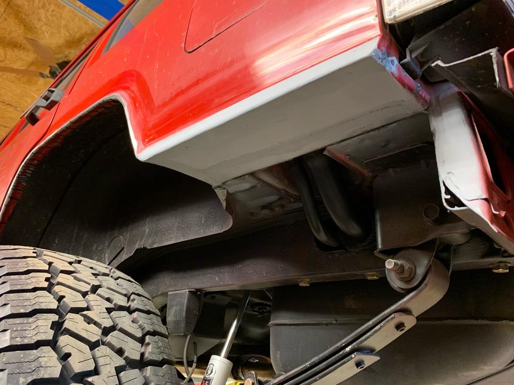

I’ll be getting the bumper mounted up tomorrow. I also for a set of Bushwacker flares to get mounted up.

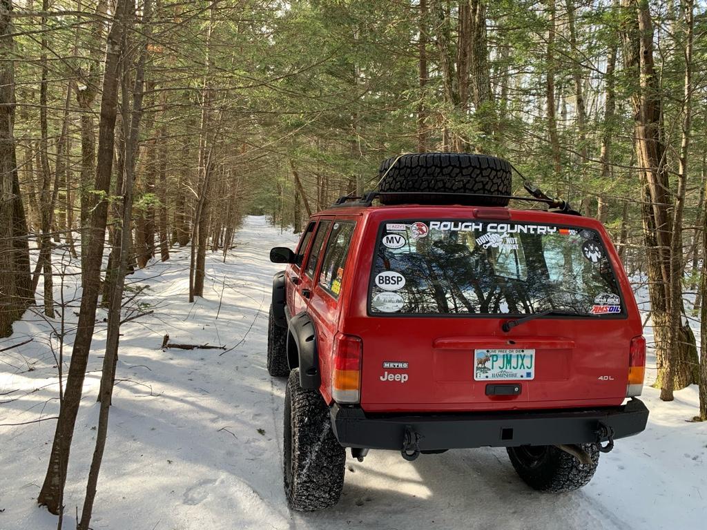

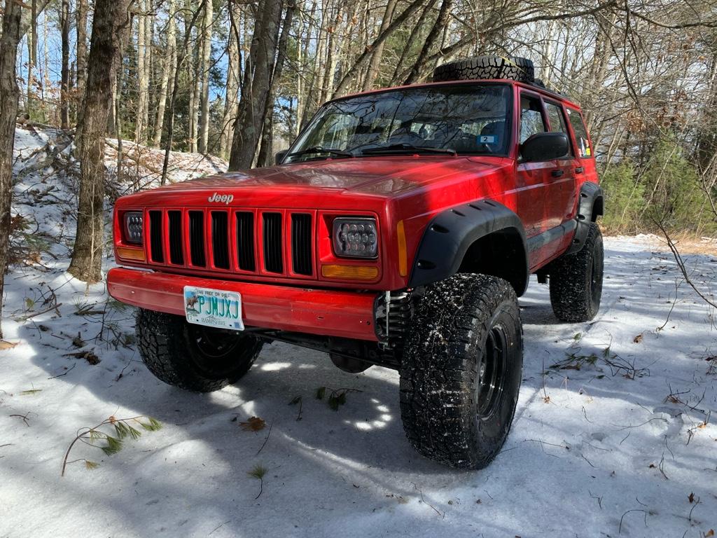

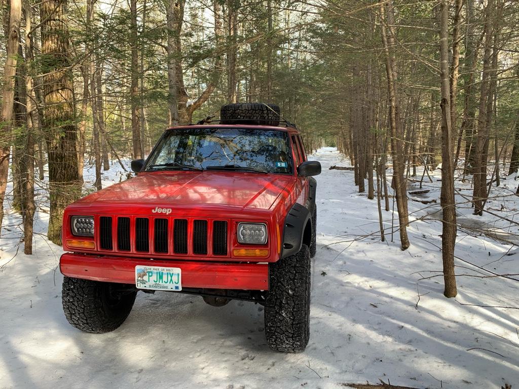

Got out for some wheeling today. Found a bunch of Class VI roads locally....had a blast! The kids loved it, and the XJ did great. Got into a few frozen mud holes that I broke through. Got dicey a few times, but the XJ got us through.
