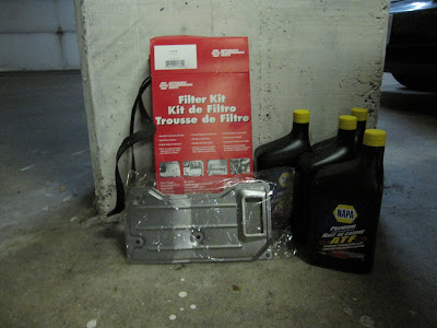

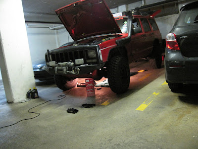

AW4 filter change pictures
kndrewa
there are tons of threads about changing the filter in your aw4.
however, i couldn't seem to find many with pictures.
here are a few photos for anyone interested.

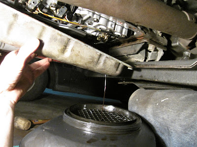

the aw4 transmission pan holds 4 liters of ATF - dextron III.
(the entire transmission holds closer to 9 liters, i only changed the pan volume)

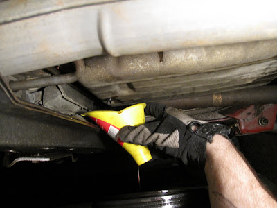

the transmission cross member is right in the way of the drain flow.
i used this small funnel to redirect the flow away from the x-member:
after draining the fluid, i re-installed the drain plug.
not all fluid drains from the pan due to recesses and ribbing.
i will deal with the rest of the fluid in the pan in a few minutes.

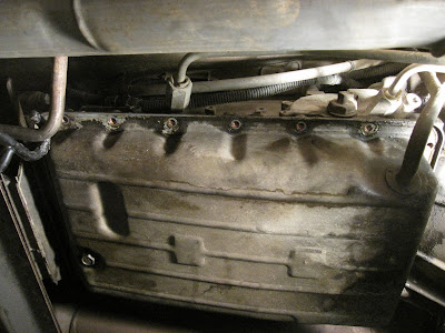

STEP 2.)

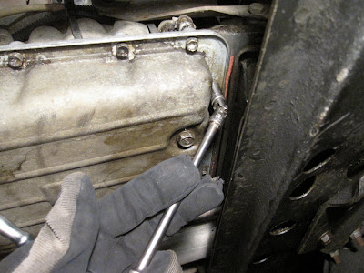

remove the bolts holding the pan to the transmission
_______________________________________________________________
they should be torqued to 53-70 in/lbs, but mine came off very easily.
(perhaps tightening these would have stopped my leak!)

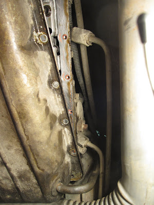

removal of most of the bolts is very easy:
some bolts at both ends of the pan require a swivel for easy removal.

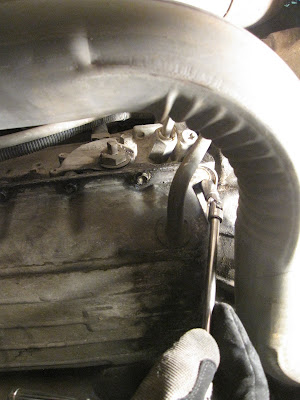

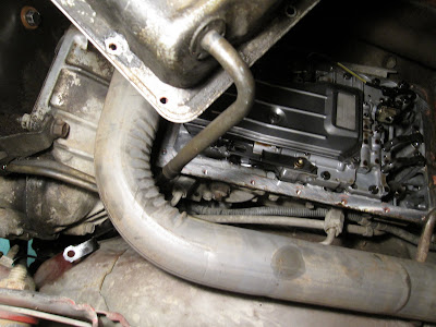

the exhaust pipe is in the way at the front of the pan:

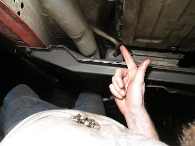

the transmission cross member is in the way at the back of the pan:

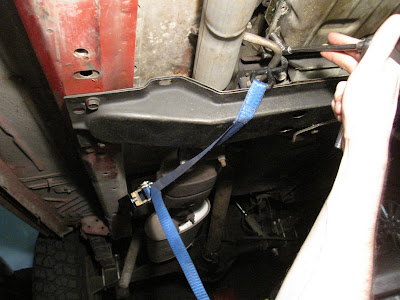

one bolt was blocked by the exhaust hanger:
i used a ratchet strap to pull the hanger over enough to get clearance:

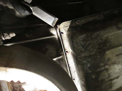

the factory uses red RTV sealant as a gasket.
this sealant gets hot and bakes on as it adheres to the trans and pan.
i used a rubber mallet to tap around the pan to loosen the sealant.
a sharp flat chisel helped to carefully pry the pan loose at a corner:

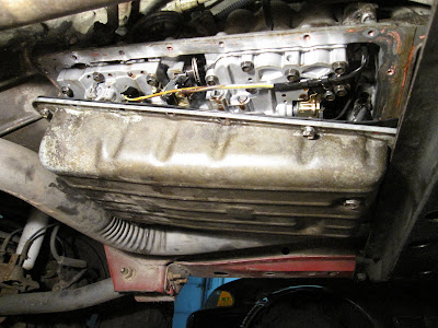

STEP 4.)
drain remaining fluid
as you can see, my transmission fluid was quite dark, but it didn't smell burnt.
transmission fluid is supposed to be a translucent reddish pink.
good thing i will be cycling in some fresh fluid - if yours smells burnt, change it!

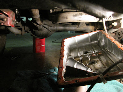

quite a bit of fluid stays in the pan after the initial drain:
at this point, i unscrewed the drain plug once again.
tilting the pan allowed me to drain the remaining fluid:

work the dipstick tube and trans pan out from under the jeep.
it is kind of a game of angles - but you'll eventually weave it out of there.
the tube will remain connected to the pan for the entire procedure:

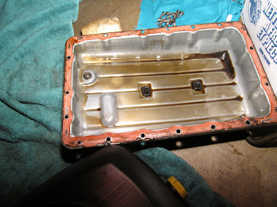

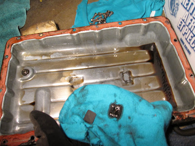

there are 2 small magnets in the bottom of the transmission pan.
they accumulate the small metallic particles which appear as your transmission breaks in.
i was pleased to see that i had a normal amount of wear as indicated by the metal on the magnets.
the left magnet is cleaned, the right magnet has accumulated metals:

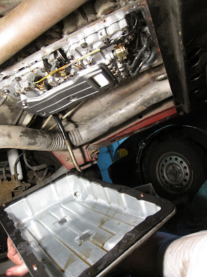

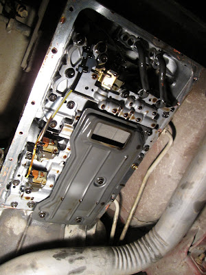

the filter is held in place with 4 13mm bolts.
the transmission filter is the dark gray rectangle
with the filter removed:

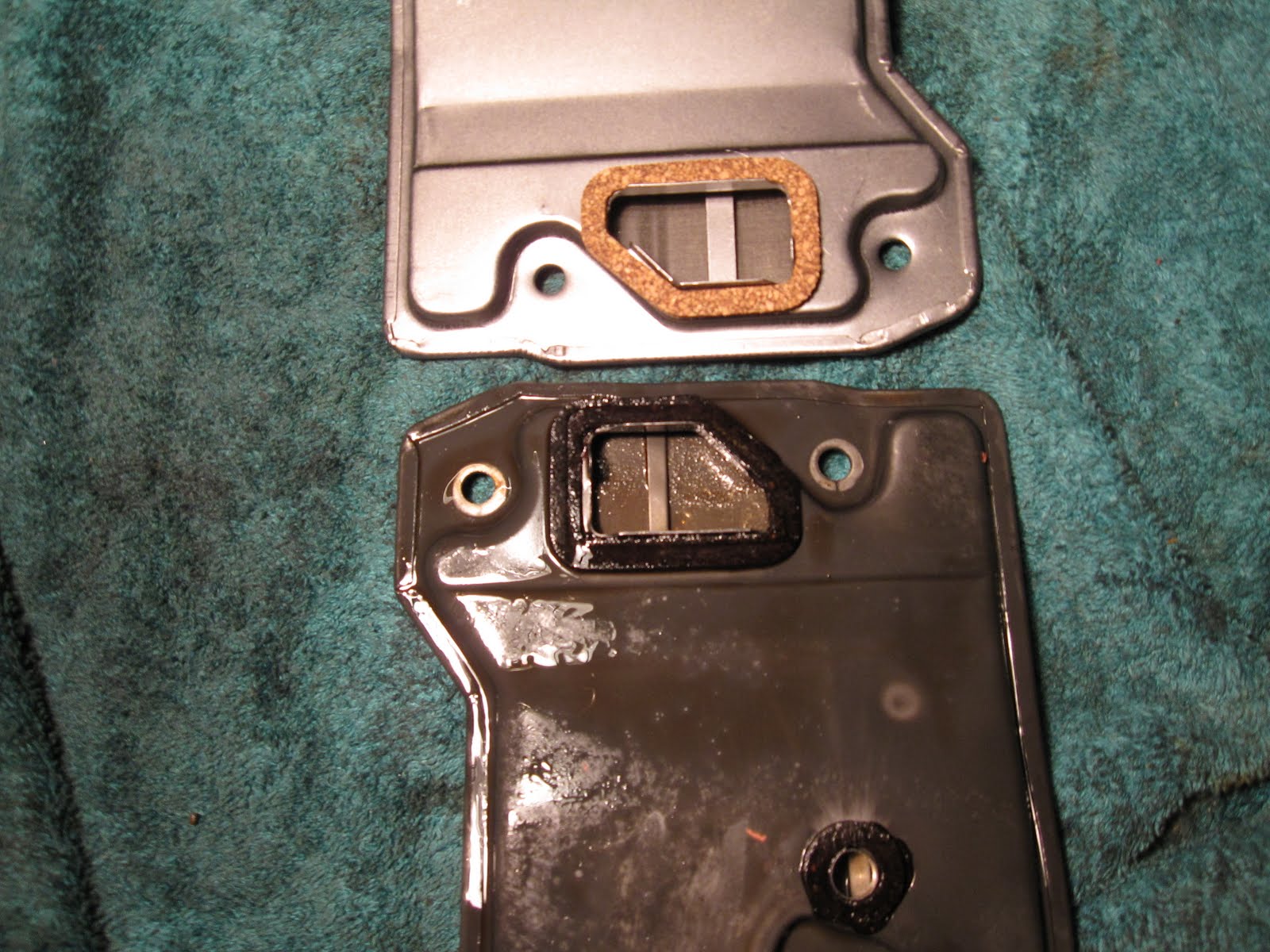

old filter on bottom, new filter on top:

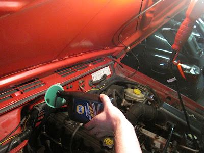

torque them down and add fluid - you're done!

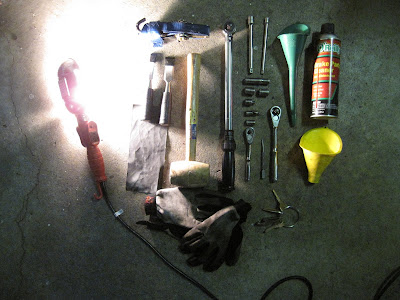

APPENDIX A.)
tools used
* shop light
* pocket knife
* ratchet strap
* chisel - wide
* chisel - narrow
* parts cleaner
* emery cloth
* rubber mallet
* shop gloves
* torque wrench
* 3/8 ratchet
* 3/8 extension
* 13 mm sockets
* swivel
* 1/4 ratchet
* 1/4 extension
* small funnel
* long funnel
* flashlight
* punch

Nice write-up, I would add that getting the pan out is easier if you remove the cross-member. That is also a good opportunity to inspect and/or replace the troublesome transmission mount.
