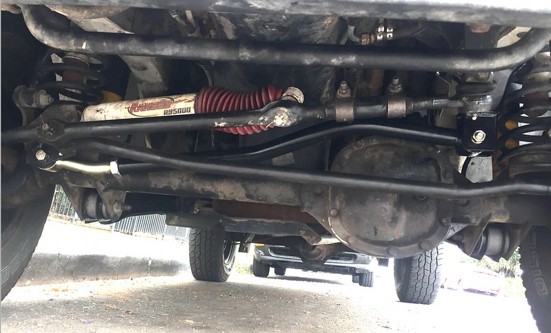

Hi all,
I had some death wobble, installed a double sheer track bar, fixed dw (along with other repairs), 99 w/ 1.5" lift. at first when I hit any speed bump, the track bar smacked my stock D30 cover (see photo). I loosened the frame bracket and ratchet strapped it forward as far as I could and re-tightened. This mostly solved the problem. But now, when there is a sizable speed bump, it will just tap (much less than before).
options:
Bump stop
coil spacer to add some lift
diff cover change
I currently do not have a place to wrench, infact, I installed the track bar parallel parked on the street (which is awful). I do not want the task of dealing with bumpstops and coil spacers (or asking a shop to do it). I could manage a diff cover swap (need to change the oil anwyay)
this is why ive landed on changing to a shallower diff cover, if you look at the photo, its just hitting on one corner. do you think the ARB will make the clearance? I cant really tell, it's a close call. Teraflex, same story. I sort of think the teraflex will smack, I also have a hp dana 30, and the i only see lp dana 30 covers (lower fill hole) Your guesses are as good as mine, just thought I'd get some input. thanks
