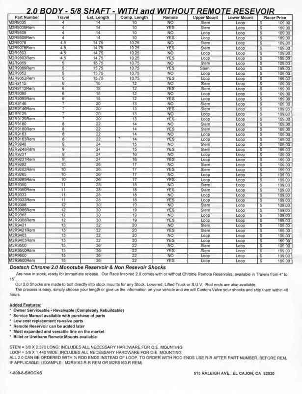

I look at their website and the pictures and information provided about their shocks is rather underwhelming and makes me wonder if they even build shocks.
For example, the 2.5" shocks with reservoirs have the description of.
"Our 2.5 Smooth Body Rebuildable Shocks are made for Pre-Runners and Project Vehicles. All 2.5s are hand built using CNC machined components. Each Shock is screw together design (no welding). The 2.5 can be ran one shock per wheel in the rear and single or dual in the front. All 2.5 Shocks are shipped with 5/8 Rod Ends only. We do not sell these with stock mount configuration. Stock mounts are special order and require a deposit and leadtime."
But as you can clearly see by the picture the top of the shock is welded together and there is a reservoir laying next to the shock with a tube that goes no where, nor is there a fitting on the shock for it to attach to.
Another thing, they list 0 specs about their shocks, no extended or compressed lengths, or availability of different bodies etc. For example, if you look at the bilstien catalog in the non-vehicle specific section you will see the specs of all of the shocks and part numbers listed.

I assume they don't provide specifics because their game is to have you describe the vehicle, measure and then they'll spec the shock. The merits of that method are debatable...
